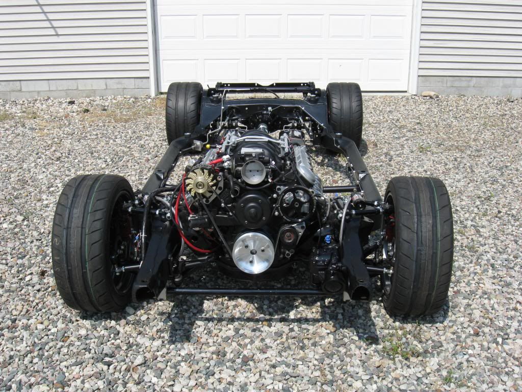

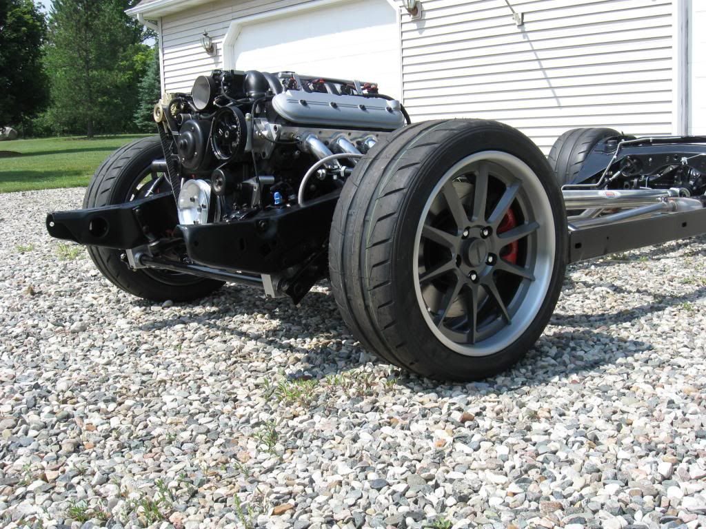

Had the same dilemma. I built my own, works great.
http://i1207.photobucket.com/albums/...psc97a2899.jpg
http://i1207.photobucket.com/albums/...psf59f4a85.jpg

Originally Posted by 65_LS1_T56 (Post 538774)
Interesting.....how did you get this done? Looks great! Thanks for all the help.
