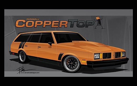

First thing we did was some planning of what needed to be done, what we wanted to do, and an inventory of what parts I have left over from my car. As far as appearance goes, I had the painter I work with at Speedtech Performance look it over and he thinks the factory copper color should buff out fairly nicely. With that in mind I went to work on a concept rendering. The car definitely needs some visual upgrades to get rid of the grandpa look. Black always does that pretty well but I don't want to go overboard and duplicate my car. Just the right amount should do the trick...
http://i286.photobucket.com/albums/l...pse562cf16.jpg
With it being copper and black and trying to achieve a tough guy look what better to call it than CopperTop. My son came up with the angry CopperTop dude so I just had to throw it in the rendering.

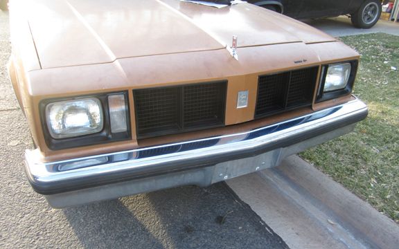

Eventually I would like to fix the door dings, get the body smooth and repaint it, but for now we'll go with a bit of the roughed up Street Fighter look. All the chrome is in surprisingly decent shape so we're going to use black PlastiDip so it's not permanent just yet. Later on we'll decide whether to powdercoat it or not. The lower stainless body trim is coming off and I'll have to grind down the rivets, so from the lower body line down will get semi gloss black paint. All other trim like the wheel openings and such will either be removed or painted black. Window frames, B and C pillars will go semi gloss black. The stripes will also be semi gloss black and will match the styling of mine. Eventually a cowl scoop will get put on and I have a spare set of single rib Salon grilles like the ones on my car that will replace the stock 3 bar wagon/442 grilles. The stock grilles are in great shape so they will be for sale on ebay soon. My son wants fender vents like mine, but I designed his to open vertically to be a little different. A ride height adjustment via some performance suspension parts and my old GTA wheels wrapped in 245-50-16s will finish the look off.

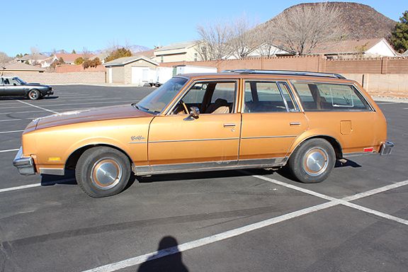

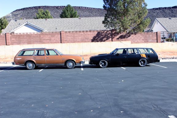

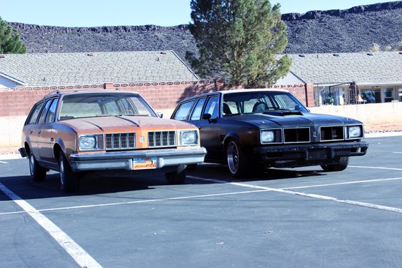

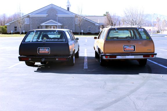

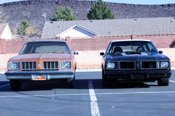

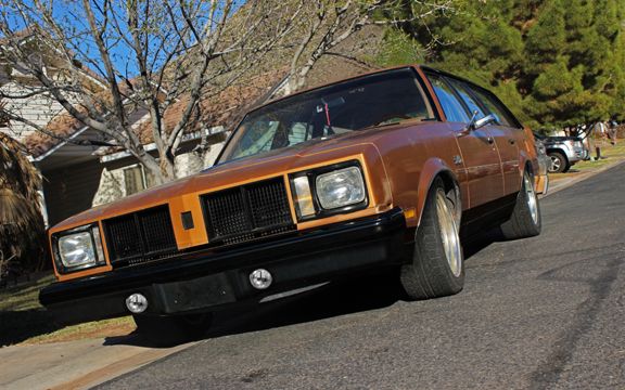

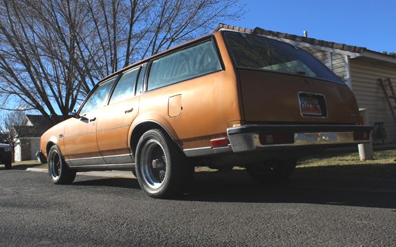

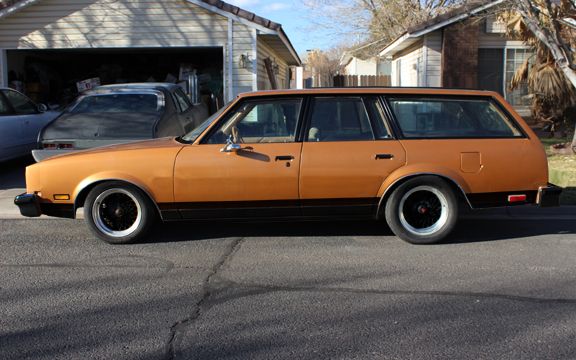

We took a bunch of "Before" pics to document changes. We took some with my car to compare stock to the pro touring changes I made to mine. I think his car should be as low as mine when we're done. :)
Overall the body isn't too bad. The worst part is the dent in the tailgate, but I can work most of that out and then bodywork finish it later on when I have more time.

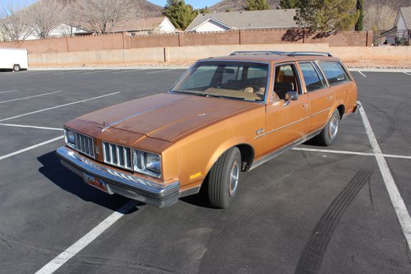

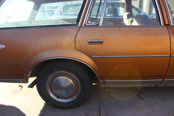

Looks like something was spilled on the car. Our painter at work said he thinks it will buff out, hopefully so. The white specs look and feel like house paint spatter, that or grandma's biscuit mix got splashed on it and never washed off. All that stainless on the rockers and the side door trim is coming off.
http://i286.photobucket.com/albums/l...ps18923abe.jpg

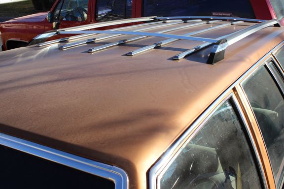

I was thinking to leave the roof rack on this one but my son insisted it needed to come off. We're keeping it just in case we want to throw junk up there for a road trip. That's just dust on the roof.

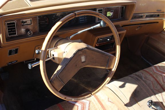

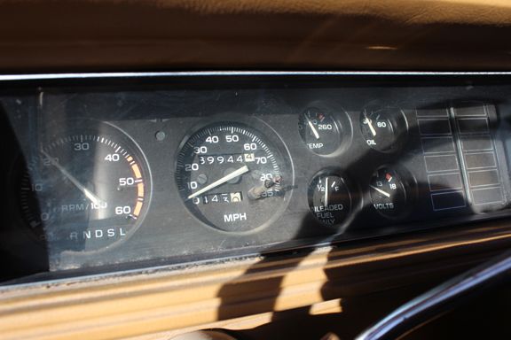

Here's the biggest (maybe only) redeeming quality of the interior. Surprisingly, along with the 350 rather than the typical generic 305 most G bodies get, this car also came with a Rally Gauge pack and factory Tachometer! What a weird combination for a wagon. This car was a great investment, I figure if I parted it out I could just about sell the dash on ebay for half of what I paid for the whole car! Lol!

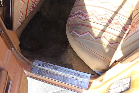

Now on to the ugly. The interior is really gross. The seats are in fairly good shape for being upholstered in cloth and as old as they are. Unfortunately everything else is just nasty dirty.

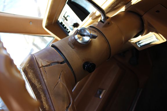

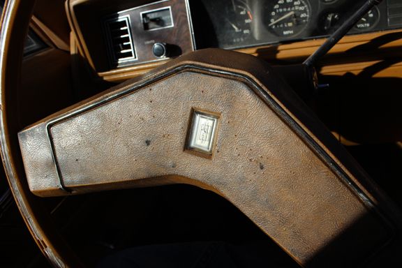

Nice steering wheel, eh? We'll be changing it out as well as replacing the key cylinder with a black one. We're looking into doing a floor shifter and stubby floor console so the factory column shifter will likely come off too.

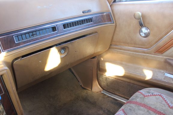

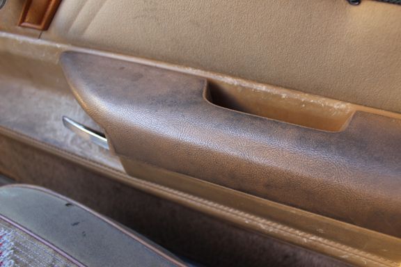

We'll be needing a glove box lock as soon I can figure out how to get this one open. Probably have to drill it out. The wood grain look will be going away, as will the pillow top door panels.

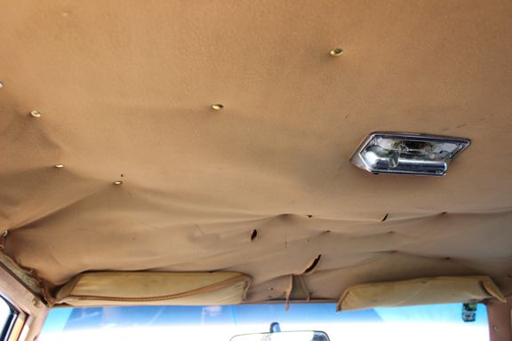

This headliner shot should explain all the other issues with the interior. I'm surprised the car was void of duct tape anywhere.

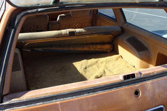

We'll be turning the interior black so this carpet will be replaced. We'll keep the factory panels back here but probably cover them with some sort of material.

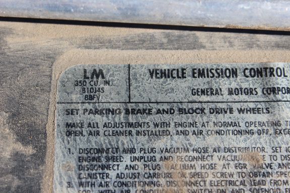

This was a nice surprise when I first saw the car up close. I had never heard of a G body that came with a Chevy 350, I thought the only V8 options were a Chevy 305 and some cars got the Olds 350 or 350 diesel. Thanks to the great guys at gbodyforum.com the "L" code engine option sticker, vin code and engine cast number were verified as the original 350 Chevy. Some folks said they've had G body El Caminos with a 350 but apparently a wagon with one is pretty rare. Every other car I've had got a 400 small block Chevy built for it, so this is my first 350 I've owned. Although I have another spare 400 waiting to be rebuilt for something, considering the originality of it, the 350 will stay with the car unless at some point we decide to convert to LS.

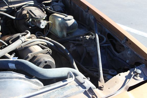

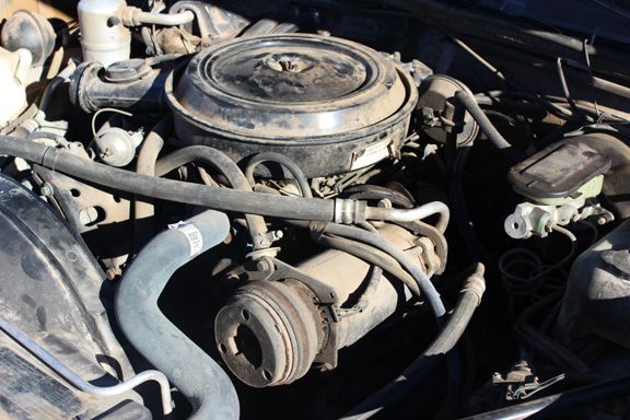

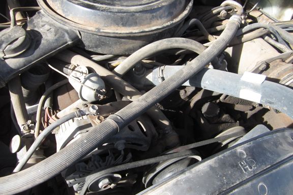

The air filter looks new as does the plug wires and plugs. Best I can tell the upper radiator hose and heater hoses are the only other things that have obviously been replaced along the way. Every wire, hose, and connection is intact. A/C belt is gone but the compressor isn't locked up and there is a little pressure in the system. I plan to get it working again, it gets mighty hot here in the summer. Since the car isn't registered or insured yet we haven't have a chance to get out on the freeway to test the cruise control yet.
http://i286.photobucket.com/albums/l...psbd285dbb.jpg

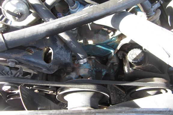

The air pump was making an awful noise so we pulled it out and put a shorter belt on. Problem solved. Unfortunately it looks like the power steering pump is on it's last legs too so we'll be replacing that. The motor is pretty caked with dust and grease. The plan is to pull the engine and trans, clean 'em up and do a reseal. I will be replacing the intake with an airgap dual plane. While we have the timing cover off I will be installing a new timing chain and trying out a Summit cam to keep the car at a high school salary budget. The one I want is the 1103, I've heard lots of folks have had good success with it, and it's mild enough for a kid's daily driver. Plus it sounds good at idle which he hopes will earn him some big coolness points in the school parking lot. Here's a link to one in a 350 in an old truck- https://www.youtube.com/watch?v=_K-XV3Yum8k
http://i286.photobucket.com/albums/l...psda236e87.jpg

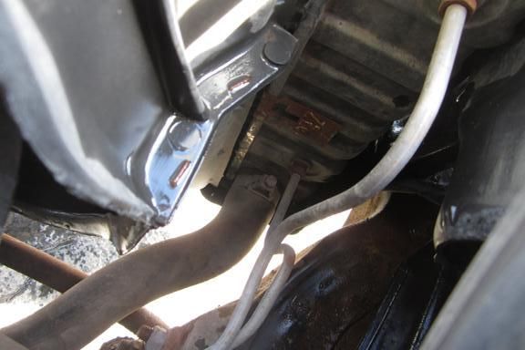

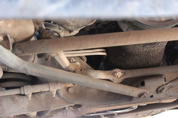

Underneath is pretty ugly. Here you can see the factory triangulation brace and larger sway bar. Upper ball joints are original, I suspect the rest of the front suspension is too. Most of that is coming out and will be replaced.

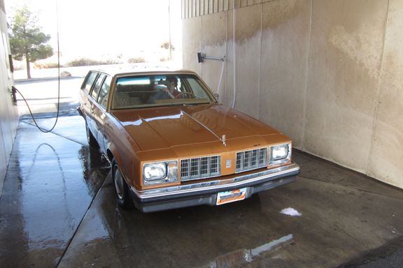

The first order of business was to spend some time cleaning the interior. We didn't mess with the carpet, I don't think there's any hope for it. Then we took it to the spray wash and hit the outside and engine bay. Hopefully we can buff the paint to look almost like this. :)

the carpet does look a little far gone, but i have always had luck pulling it all the way out, spraying every type of cleaner on it i can think of, scrubbing the crap out of it, and hosing it off at the car wash with every selection there is (wheel/tire, engine bay, soap, then water)

We had the same thought about the spray wash. We plan on converting the interior to black but for now that's a decent solution to try out.
