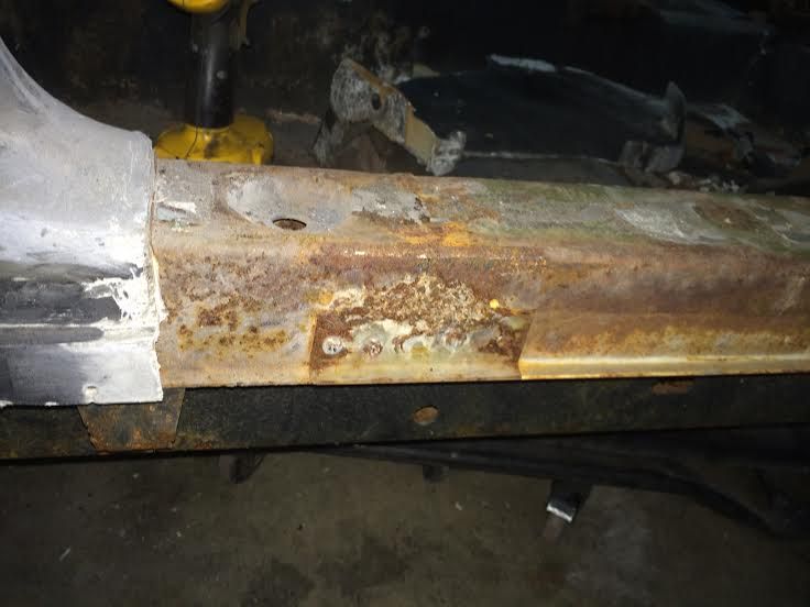

Something fishy is going on here! Looks like somebody took the front of the passenger sill/rocker channel and installed it on the rear of the passenger side.
http://i852.photobucket.com/albums/a...2f25c8a6-1.jpg
http://i852.photobucket.com/albums/a...ba2994-1-1.jpg
Problem area #1. Looks the same on passenger side. Fortunately, the outer area is still solid. I can see it through the holes. i poked at it with a screwdriver and hammer and it did not puncture or flake.

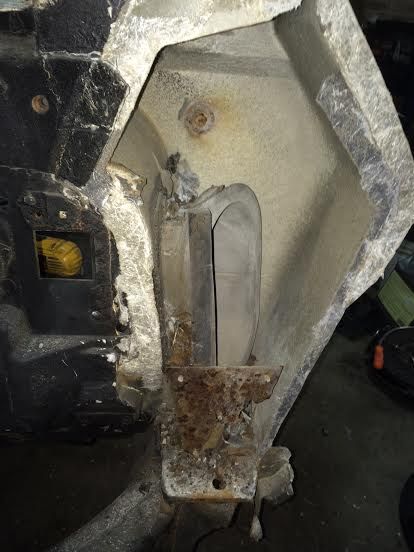

The worst area is at the bottom of the driver's door hinge pillar. The area in the front, from the sill to about 2.5" up is more or less worthless. Ill fab up some new metal and weld it in these places once all the glass is removed.

The rust in the birdcage is concentrated in the lower areas. The tops of the pillars look good overall.
http://i852.photobucket.com/albums/a...ps07acdf28.jpg
http://i852.photobucket.com/albums/a...psa30b1f29.jpg
