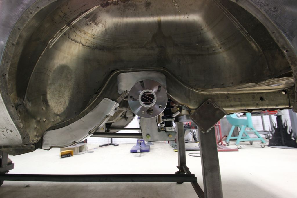

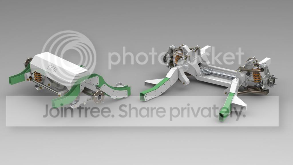

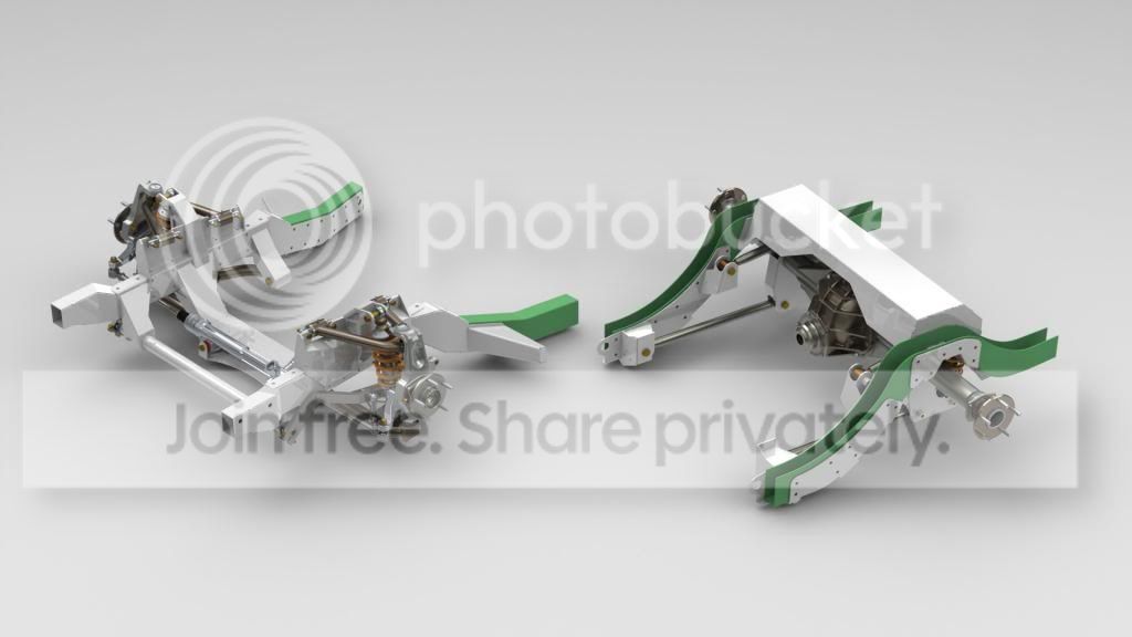

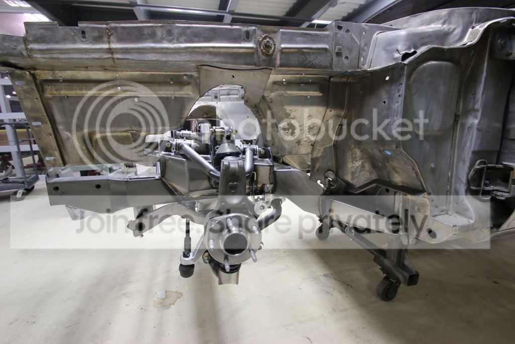

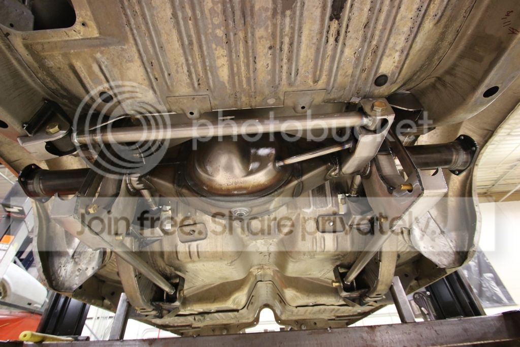

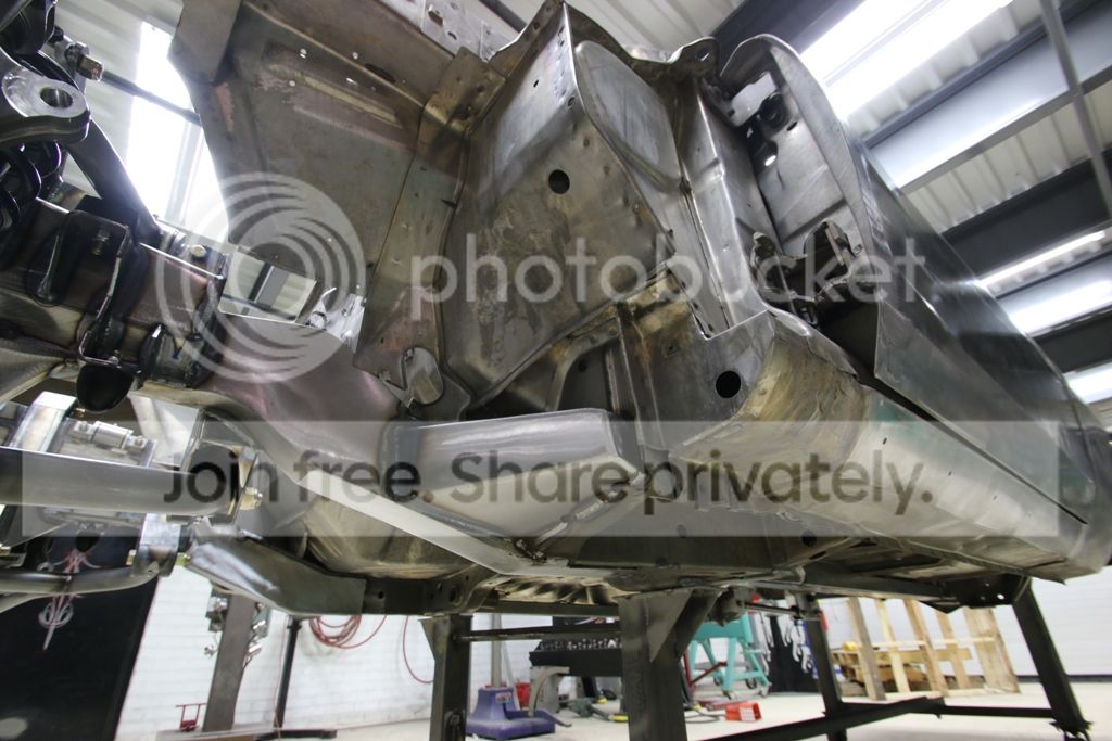

Roadster Shop 03-19-2014 11:40 AM
Here are a few pics of the kit that we have just finished up. The front is designed as a complete sub-frame. You would need to remove the front rails from the firewall forward. The subframe slides over the remaining factory rails and welds in place. The rear brackets saddle the factory frame rails and weld in place.
The green areas represent the factory frame rails that remain in place.
