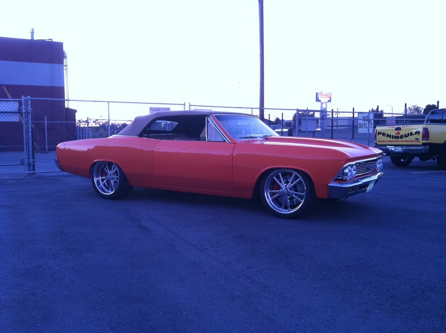

I have a Nova in the shop with a RideTech air bar coil over and its dumped. I thought I had a picture on file here. I don't but I can get one this week.
Plus side for you is a 20 is a tall tire and will fill that well up naturally. You will not have to lower much to gain the same look as an 18 or 19.
Example is the Chevelle. The 20in rear just makes the car look lower than it really is.
