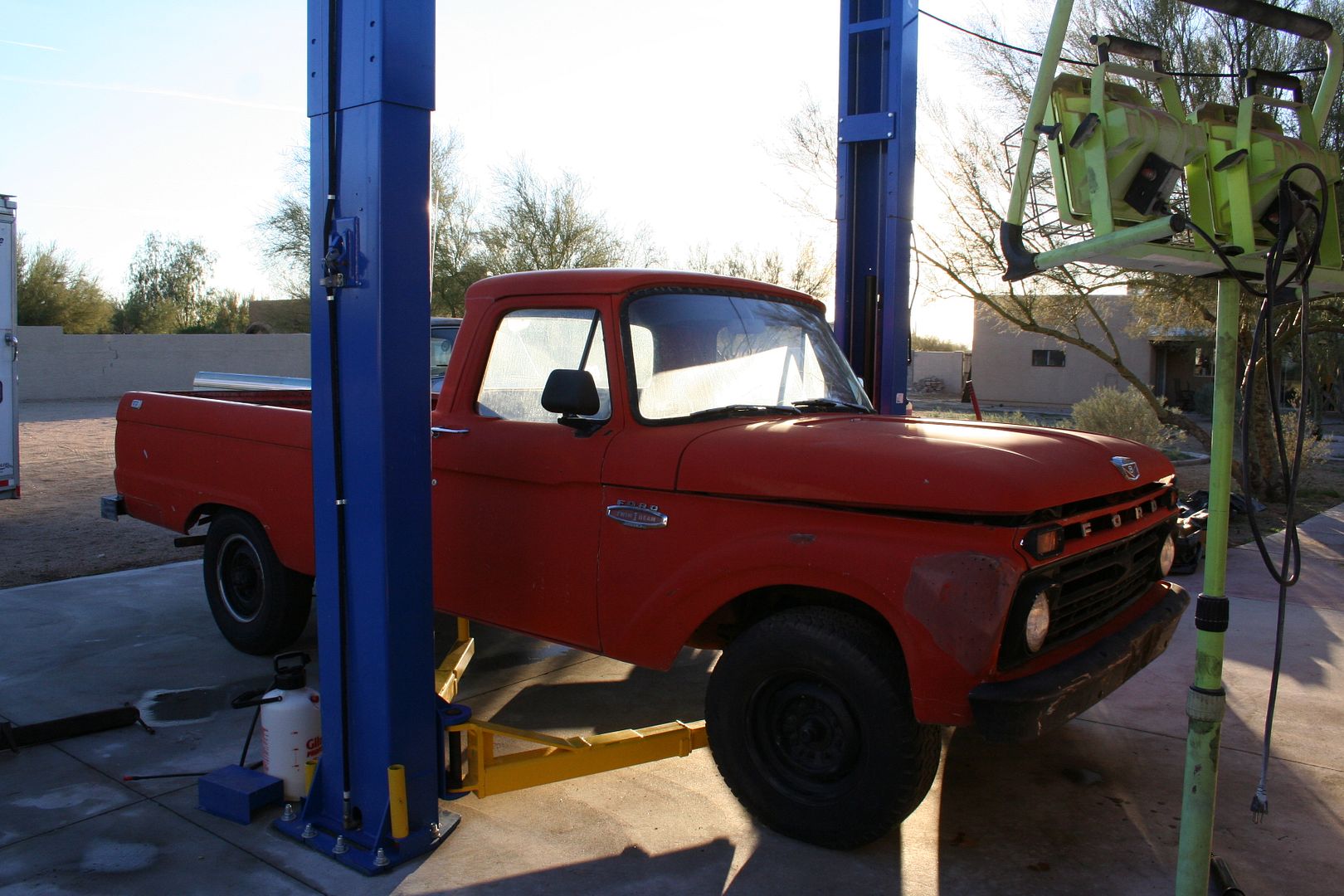

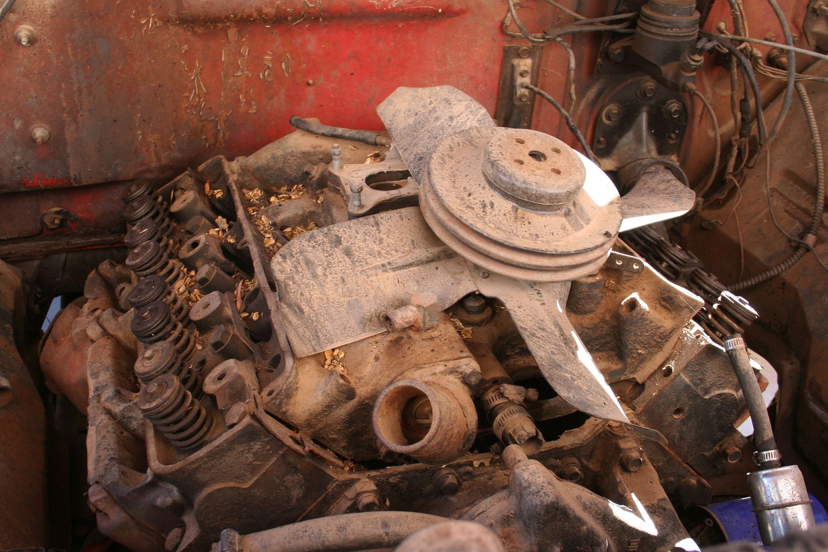

2 years ago I started to build a 1966 F-100 with a 2011-13 3.5L TT EcoBoost Chassis.
Best I can tell it will not be allowed to run Auto-X because of the have to have in order for engine to run and work ABS, Roll Control etc?
Or would I be able to run in a later model class? It will be titled as a 1966 but will pretty much be sheet metal only.
If anyone here cannot answer who would I ask?
I know I know its hard to picture this thing going around corners?
At least its a Ford in a Ford! hahaha
Just seeing what I can turn a 300.00 Truck into . .
http://img.photobucket.com/albums/v5...psd88947f5.jpg
http://img.photobucket.com/albums/v5...ps78ab6293.jpg
http://img.photobucket.com/albums/v5...ps2b8dd37d.jpg
http://img.photobucket.com/albums/v5...psd20cbf2d.jpg

TimeWarpF100 03-21-2014 07:57 PM
here is where I am at right now. Illness has caused a 2yr hold on project but really want to get back on it soon.
http://img.photobucket.com/albums/v5...ps85f68c93.jpg
Complete bare frame shipping weight is 520lbs
http://img.photobucket.com/albums/v5...psb34aa33f.jpg
