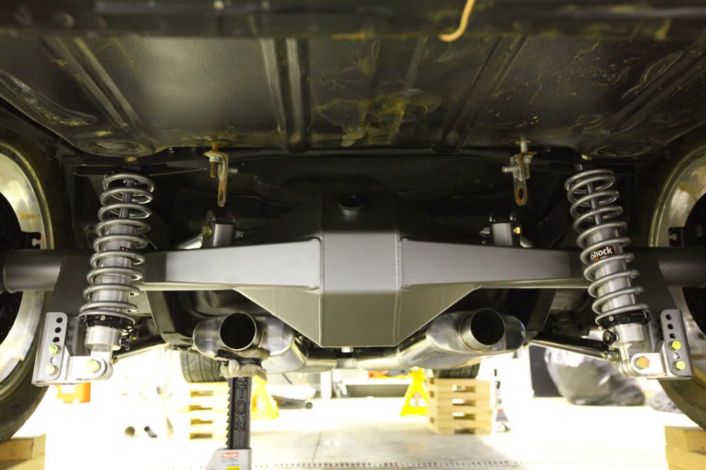

Here is a pic showing the out of the box mounting on Joe's (frojoe) car.
http://ls1tech.com/forums/attachment...972-nova-1.jpg
So, what to do? Raise or remove the crossmember I think. Frojoe raised his crossmember by modding the G-Link crossmember brackets. Doing that you can move the crossmember up ~1.5" or so. Basically take the crossmember brackets up flush with the top of the rails. However it also requires you to mod the trunk pan and create a filler panel.

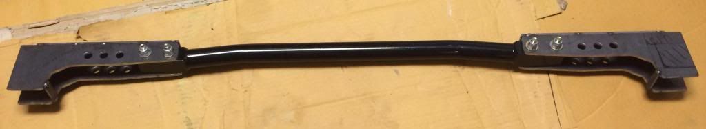

I had been considering the same and once I saw Joe pull it off I had the confidence to try it. Almost... Off I went to fab up some new brackets to raise the mounting location. Here are the brackets I have made. They are long because I'll contour them to the rails once I cutout the old ones. In order to leave enough "meat" where they wrap around teh bottom of the rails I relocated the set of shock holes .5" to the inside. I will also have to rebuild the bolt-in bar so that it is shorter.

I just noticed that the first pic is a little deceiving. It would appear in that pic that you may have interference between the spring and the framerail if you recessed the coilover mount deeper into the trunk as would be the case with the DSE style crossmember. When I just now noticed that I initially thought I answered my own question :).
I do think the Quadralink has the shocks mounted more in-board and in vertical position.

Here is another pic of Joe's modified brackets to make the general idea clearer. Unlike me he was smart enough to realize this and account for it before installing it...
