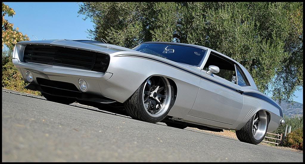

Love my shockwaves and the adjustability. I went with an AirPod so the install was relatively simple. Ride quality is better than the QA1's I had before the shockwaves.
Perfect ride height, never scrapes because I can bump it up a few inches with one push of a button. Plus I can lay it out when ever I want.
Would do it again without hesitation.
