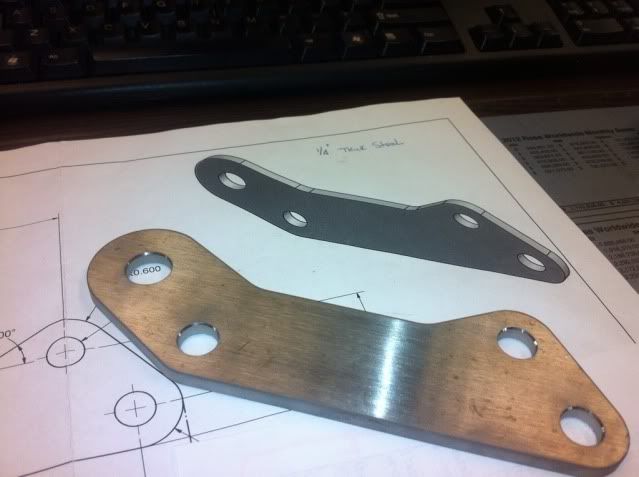

Anthony,I think what Tu was mentioning is the spacer between the spindle and the LS bracket since you have disc brake spindles. They are about a 1/4 nch round spacer, I will send you a picture.

Anthony, this may help. Did you buy the brackets from Joe with the spacers?
The spacer will mount between the bracket top hole (see pic) and the spindle:
http://i254.photobucket.com/albums/h...a/cc567c32.jpg
If you do not have the spacers, give me a holler, I think I bought two sets from him. You may be able to get away with a thick washer.
