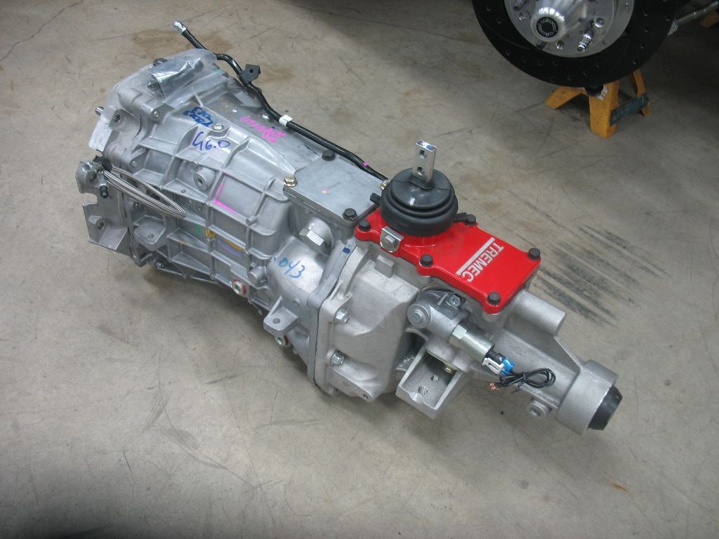

Ameican Powertrain T56 Magnum package

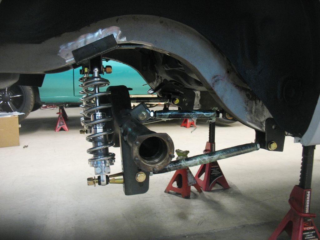

Control Freak IFS and 4 link

This is our third Control Freak IFS for Mopars, and we love their product!

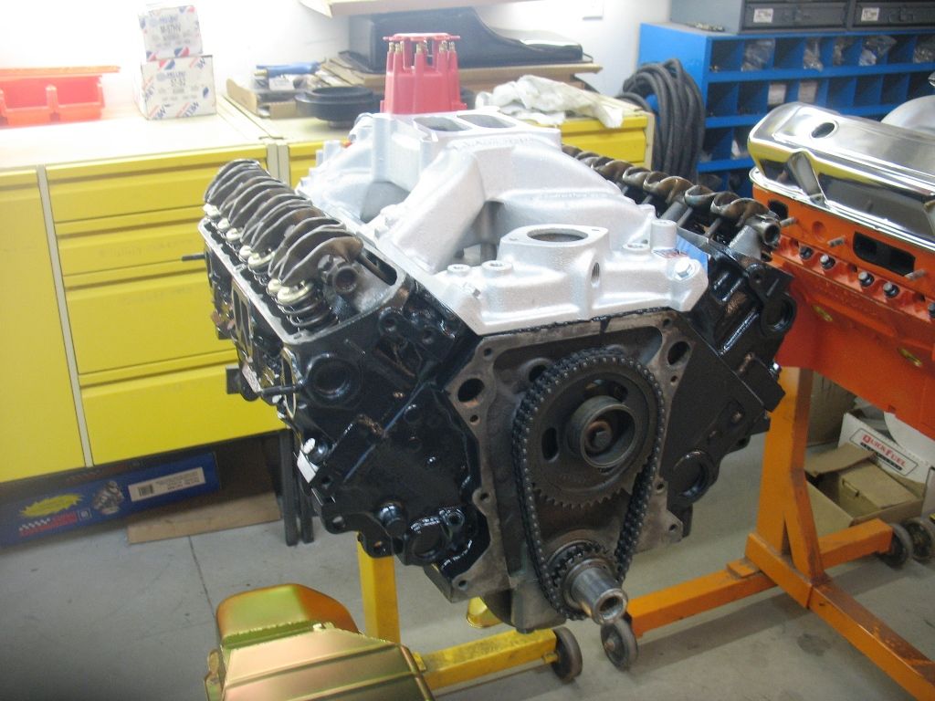

We did a mild 340 for this car, with a cam, Air Gap intake, Holley, and the usual goodies.

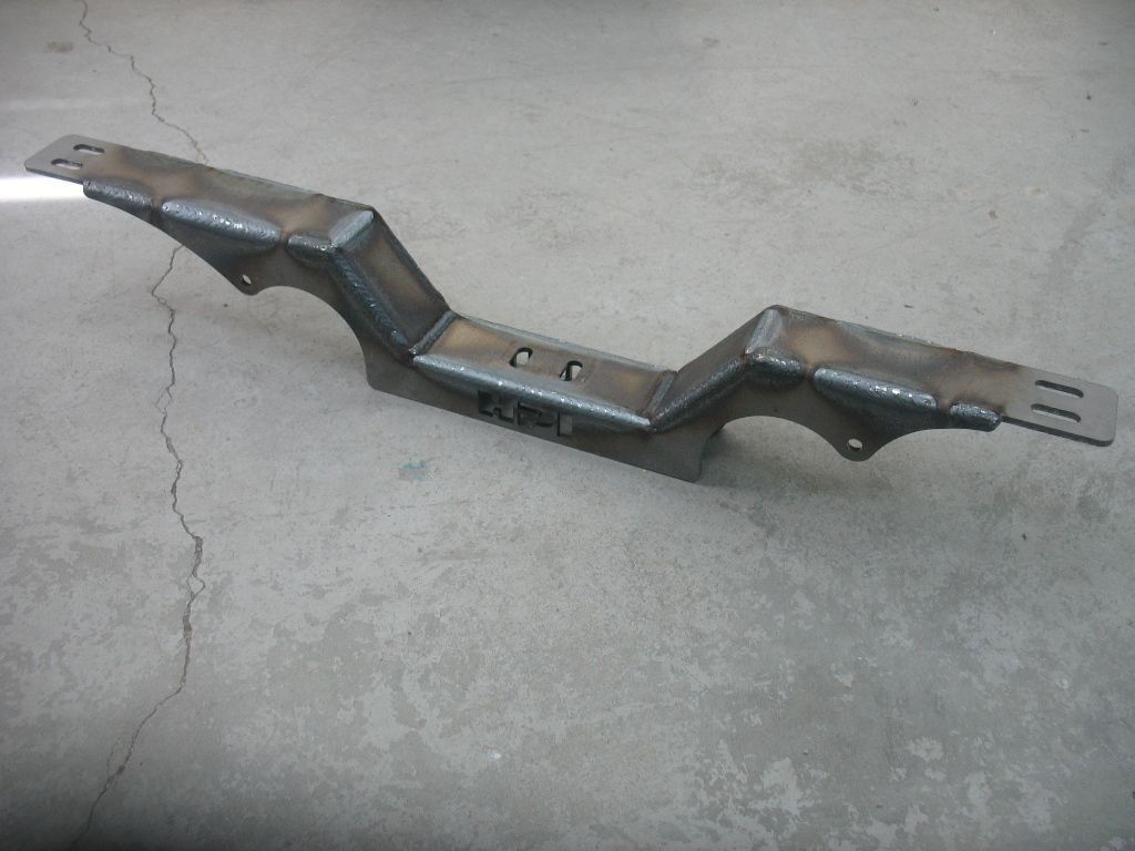

Trans Crossmember for the T56. I know its not symmetrical, its a Mopar they have a thing with offset drivelines.....
http://i1204.photobucket.com/albums/...ps0e6e6670.jpg

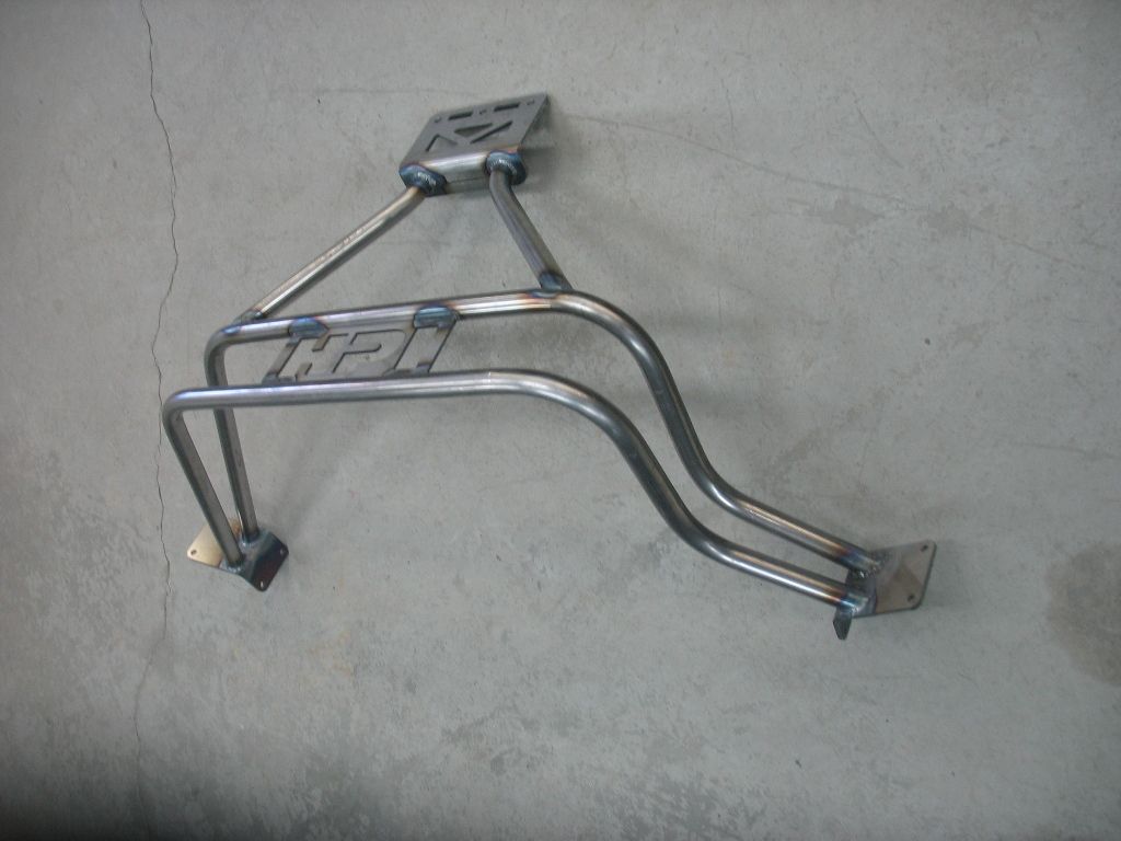

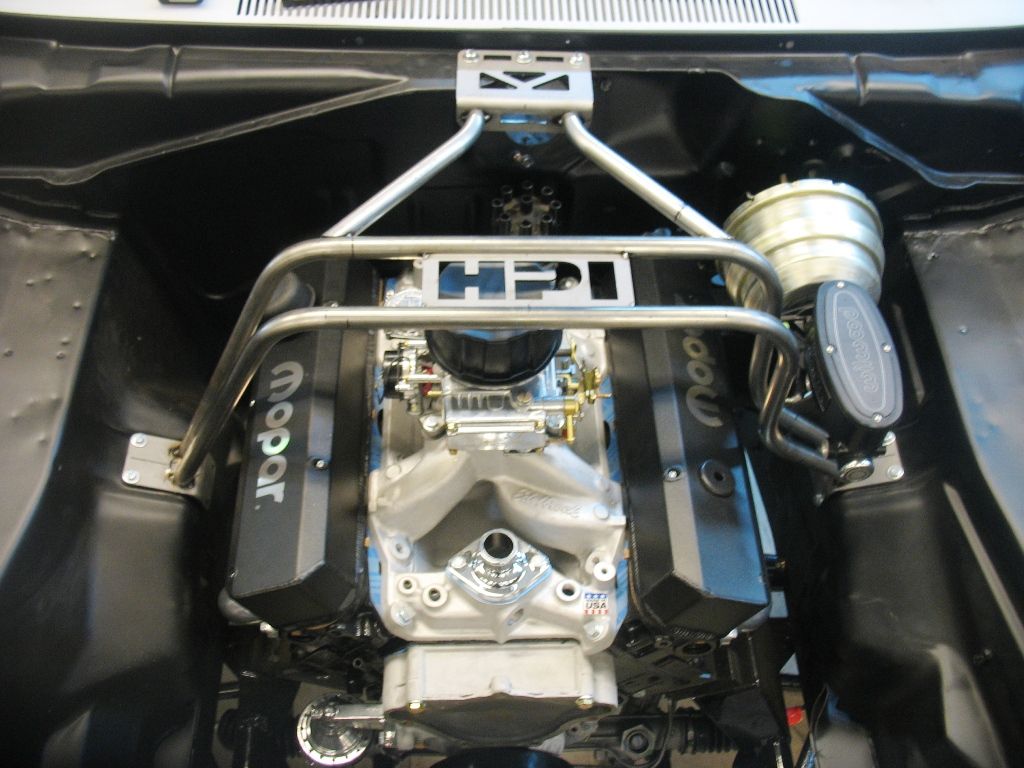

and a strut tower bar we decided to make because we could....and the shock holes weren't welded shut before paint. It was going to be a stocker.....and I didnt do the sheet metal.
http://i1204.photobucket.com/albums/...ps58371917.jpg
http://i1204.photobucket.com/albums/...pse619bc25.jpg

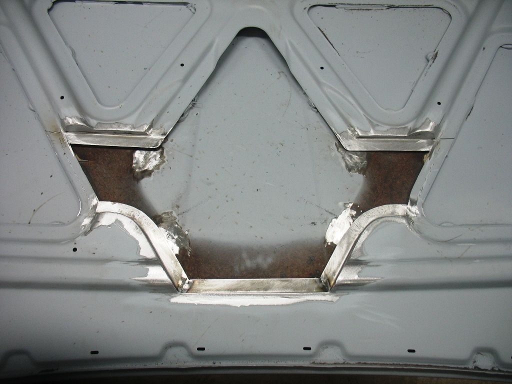

Just a bit of hood clearance, seems the Air Gap intake is just a bit too high. If we didnt use the Xstream air cleaner top we could have avoided it.
http://i1204.photobucket.com/albums/...psdc7ebb1e.jpg
http://i1204.photobucket.com/albums/...ps58c70576.jpg

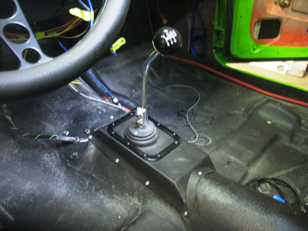

The fun stuff! Made a cool minimal intrusion tunnel hump that is removable for the shifter, and since we werent doing a console we just put a Lokar shift boot right on it, over the carpet!

The suspension installed
http://i1204.photobucket.com/albums/...ps0e558853.jpg

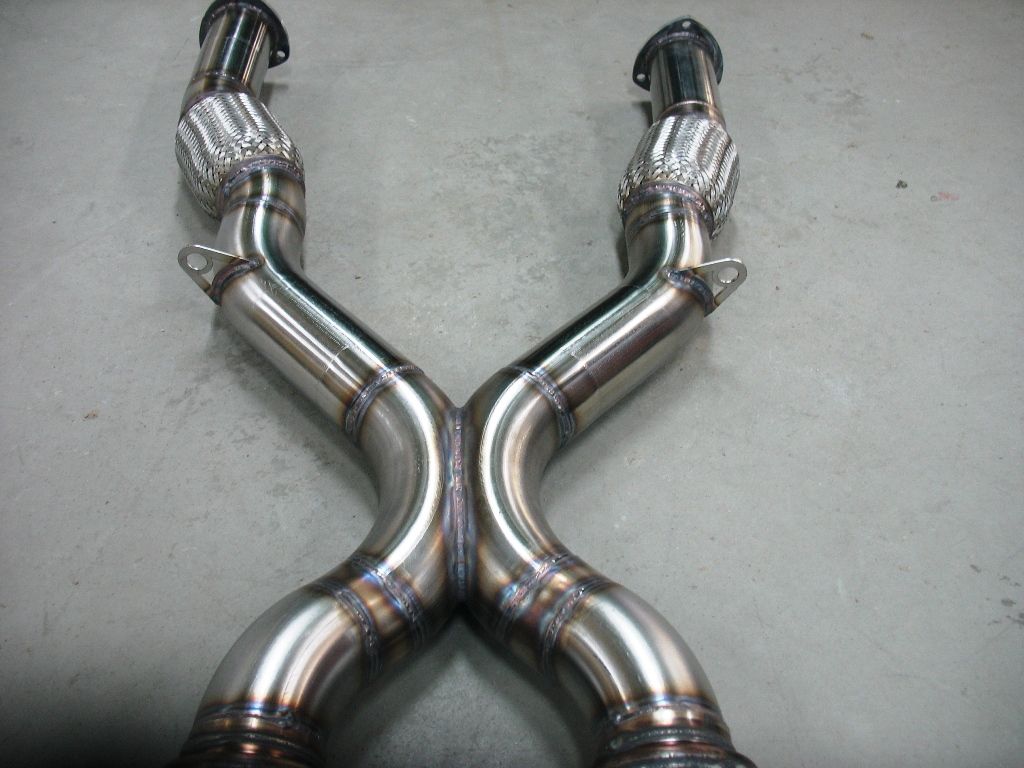

Everyone loves TIG'ed stainless!
http://i1204.photobucket.com/albums/...ps705483fe.jpg

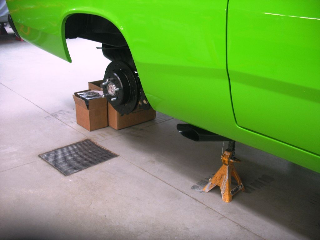

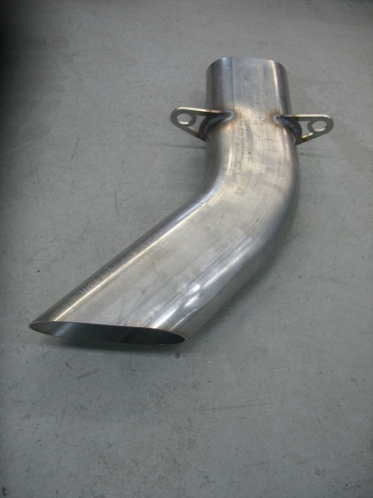

Some custom side exit exhaust tips that are now satin black
http://i1204.photobucket.com/albums/...ps74a0870e.jpg
Nice and short exhaust....he said he wanted it to scare women and small children!
http://i1204.photobucket.com/albums/...psf47fc878.jpg
http://i1204.photobucket.com/albums/...ps0fd8a67d.jpg

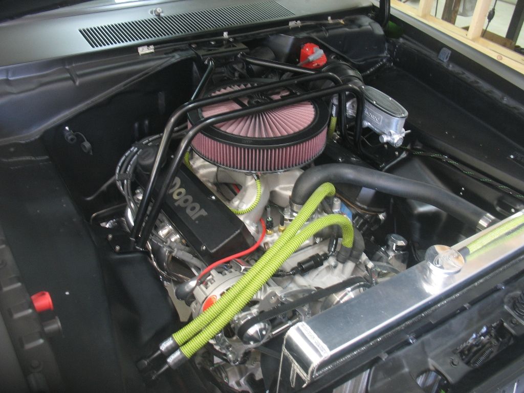

64pontiac 06-11-2014 08:05 PM
Oh yeah, its Sassy Grass Green!
Engine bay
http://i1204.photobucket.com/albums/...psedf51750.jpg
http://i1204.photobucket.com/albums/...psf54fc009.jpg
http://i1204.photobucket.com/albums/...ps9de62e32.jpg
