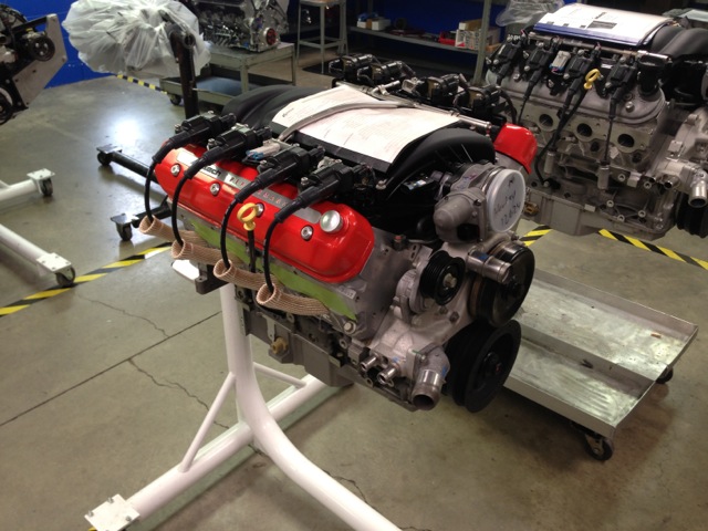

kiwigt 06-16-2014 12:15 AM
1 Attachment(s)
There is something special about a 427 for me. Katech converted my LS7 to wet sump, and added their Torquer 110 cam and CNC heads, dyno'd at 610hp, 570 ft lb. But people talk about the 'LS7 tax'...and it is real. Got to pay to play.
Attachment 48714
