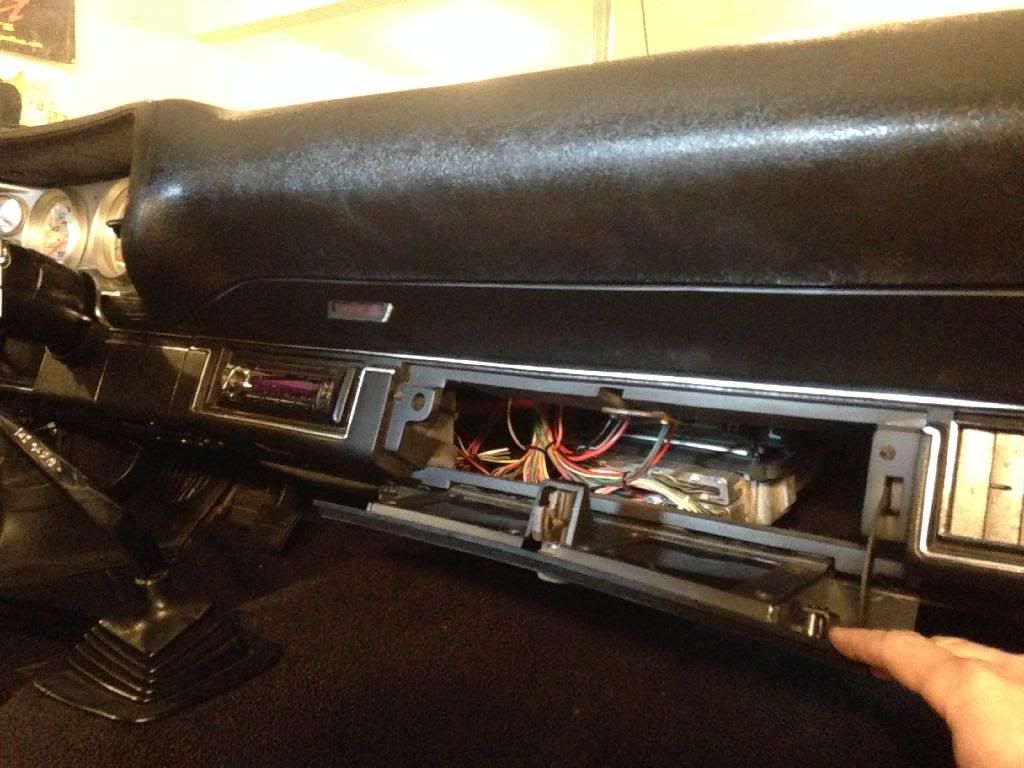

cubicylndr16 06-15-2014 07:58 AM
http://i28.photobucket.com/albums/c2...ps7sbocbrj.jpg
http://i28.photobucket.com/albums/c2...psbg1a9j1u.jpg

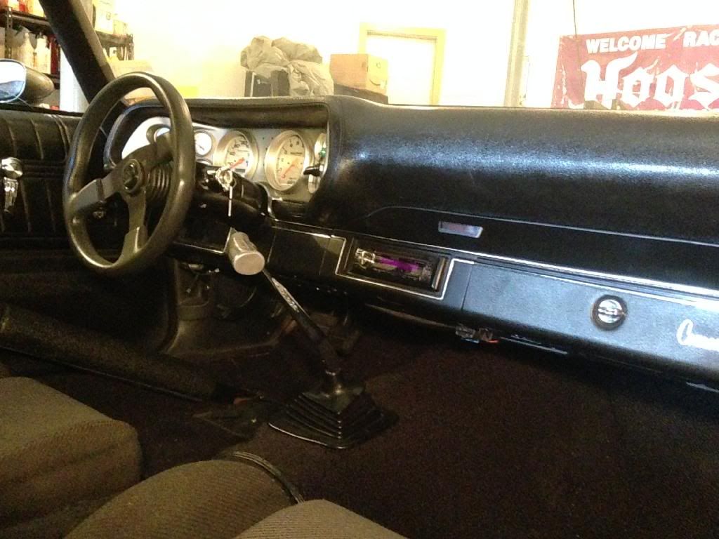

cubicylndr16 06-15-2014 08:01 AM
http://i28.photobucket.com/albums/c2...pstxuufaqk.jpg
http://i28.photobucket.com/albums/c2...psbyfxbrtx.jpg
http://i28.photobucket.com/albums/c2...psanx3jgsz.jpg

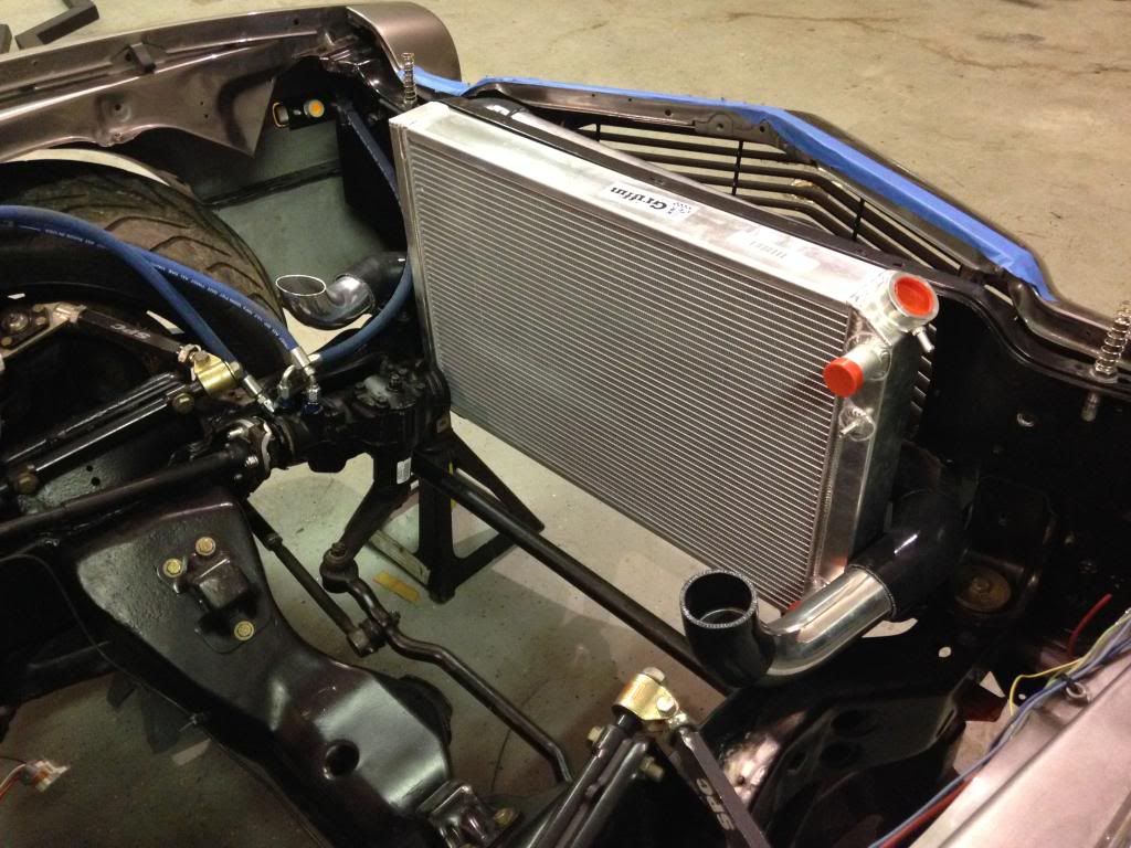

cubicylndr16 06-15-2014 08:07 AM
http://i28.photobucket.com/albums/c2...psf2dvuv8o.jpg

REBEL F1 06-15-2014 10:25 AM
Very cool build! I don't why, but the car looks mean for some reason in the second picture on jack stands. Look forward to seeing this thing come together for you.

srh3trinity 06-17-2014 09:41 AM
It is probably because of the intercooler. They always up the cool factor.
