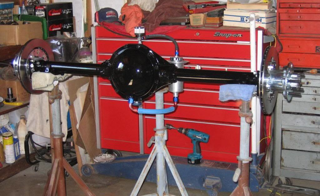

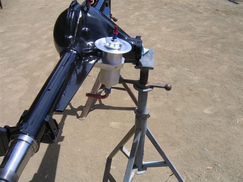

I built a full floater AMC 20 for my Road Race AMX using all Moser pieces. The GM 14 bolt should be a piece of cake compared to an AMC! The Moser stubs are designed for a three inch tube. I believe the 14 bolt is probably larger, so you might have to machine a ring to enlarge the Moser stub to fit your tube. I had to machine the stub down for the AMC.
http://i1223.photobucket.com/albums/...ps68f22482.jpg
You'll need to do some quality fit up work and welding to ensure correct dimensions on the finished product. Depending on your usage you can also dial in some camber or toe-in if you desire. One thing about the full floater is you don't have pad knock back issues. Like I said as long as you can deal with the weight, go for it!
http://i1223.photobucket.com/albums/...pse5be4fa6.jpg
