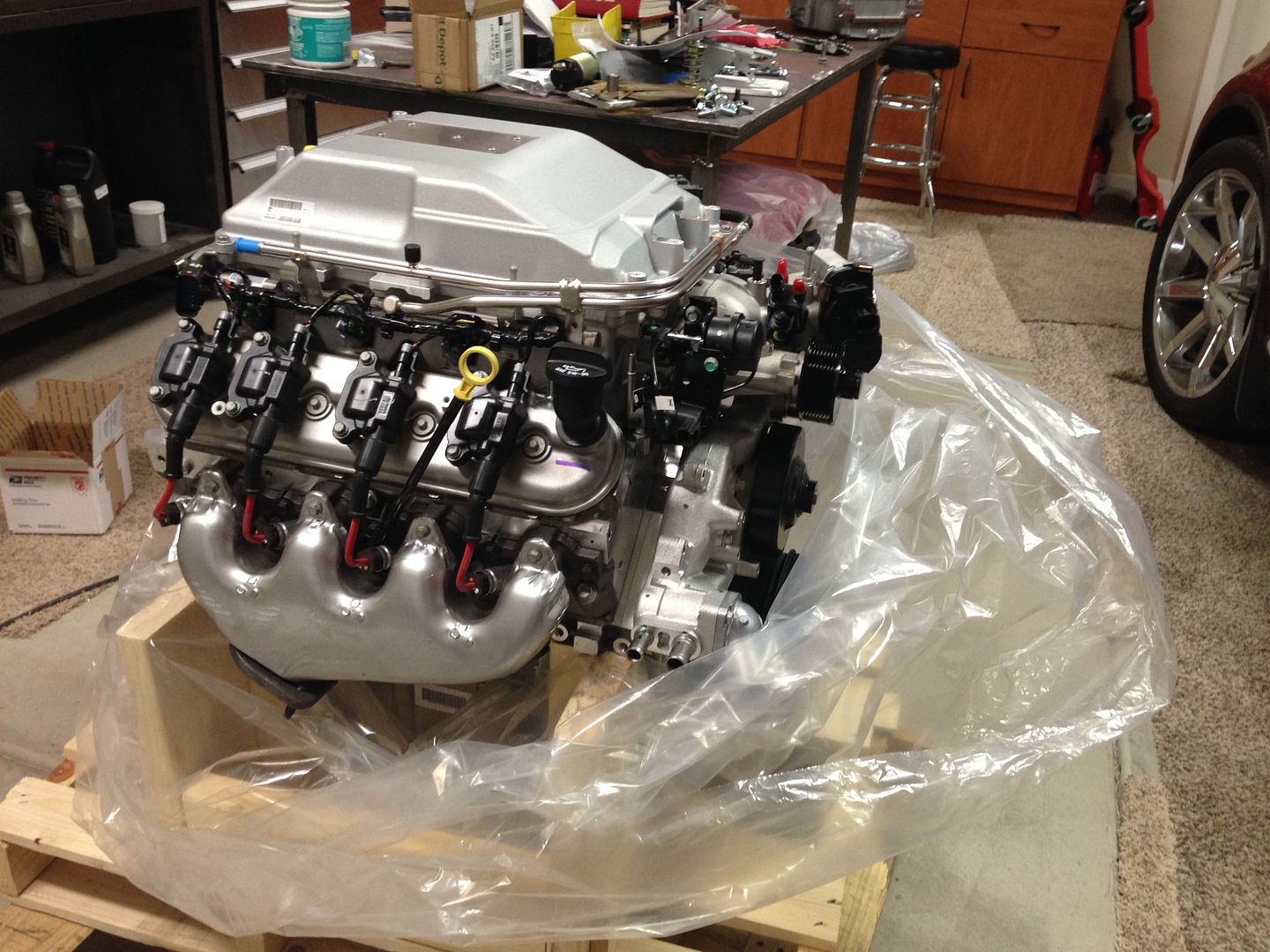

Finally getting my wish to have an LSA in my GN.
Went through the suspension, brakes and reinforcing the frame with a notch before undertaking this conversion.
Lonnie Diers Stage III 4L80E Transmission with custom cut Billet 1st and 2nd gears 2.75 1st, 1.57 2nd.
Cooling system is already converted to a Ron Davis radiator so cooling should not be an issue.
Was running my stroked 4.1 on E85 and hoping to have this running on E85.
Nick Micale is doing the install with his vintage air conversion for more engine bay room.
After in and running a turbo (or twin) is(are) going in front of the supercharger to turn up the volume a little.
Total project should be around 2 months.
Here is this weeks progress:

I'm curious about this too. I just see it as in-efficient and in my head it just seems like if its not configured just right, the SC is going to be a bottle neck with twin turbos are forcing air in. IS there engineering behind this or just a "lets see what happens"
tdishon 11-24-2014 11:49 AM
Forced Induction Tuning has been doing this for years to the CTS-V.
Many hours of dyno testing over the years has tuned this to a very conservative 850 rwhp that idles like glass on pump gas. He has done a few with single turbo's, but for the street small twins work better in all lower rpm applications.
Agreed it is over kill and I'm sure with a cam and a much smaller pulley on the SC 850 rwhp might be doable, but I'm not looking for an aggressive sounding engine. I want it to drive like a Cadillac... And under the hood looks amazing now.
