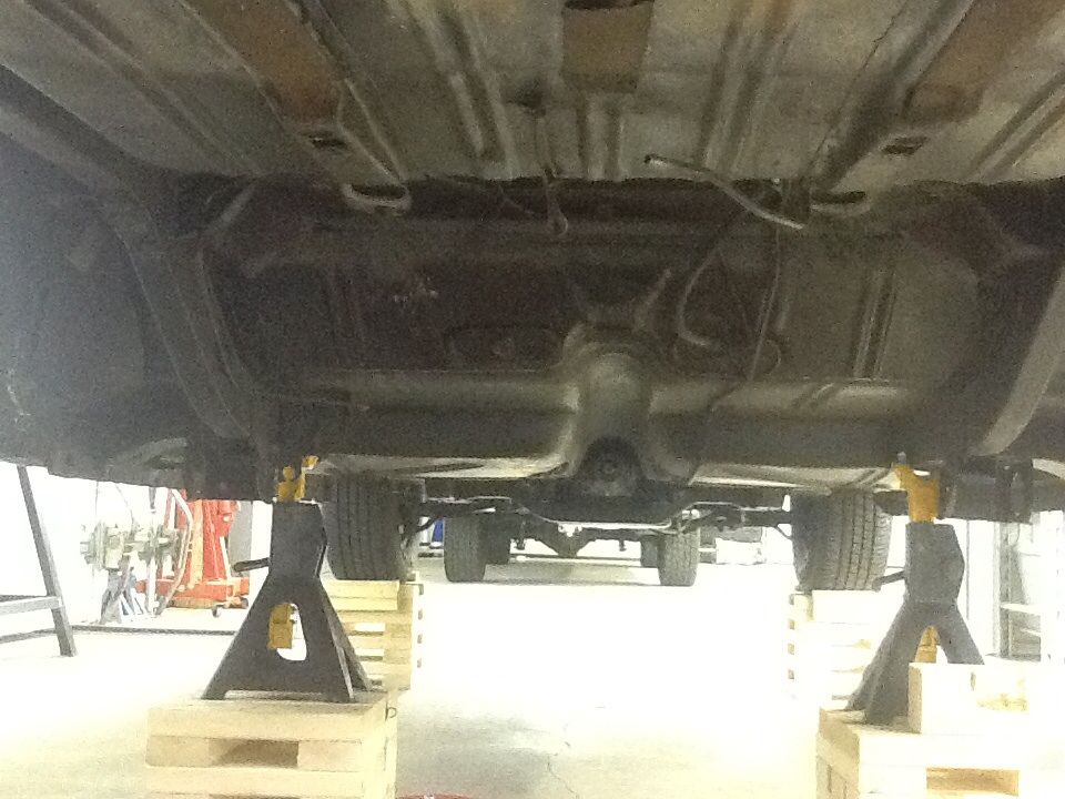

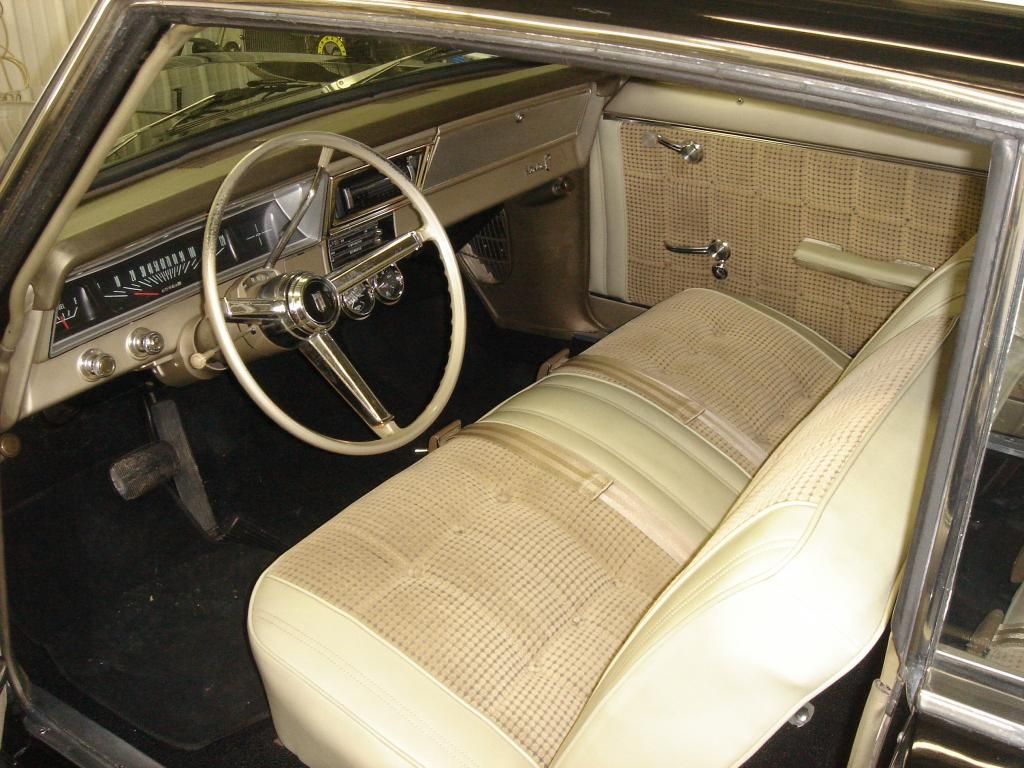

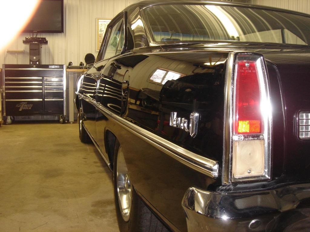

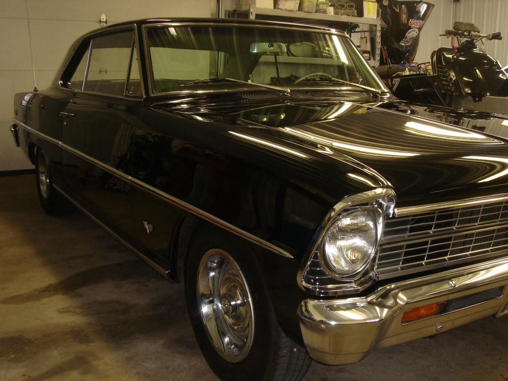

This is how it looked when I purchased it in November 2012
http://i194.photobucket.com/albums/z.../imagejpg2.jpg
http://i194.photobucket.com/albums/z.../imagejpg1.jpg
http://i194.photobucket.com/albums/z.../imagejpg3.jpg
http://i194.photobucket.com/albums/z.../imagejpg6.jpg
http://i194.photobucket.com/albums/z.../imagejpg5.jpg
http://i194.photobucket.com/albums/z.../imagejpg7.jpg

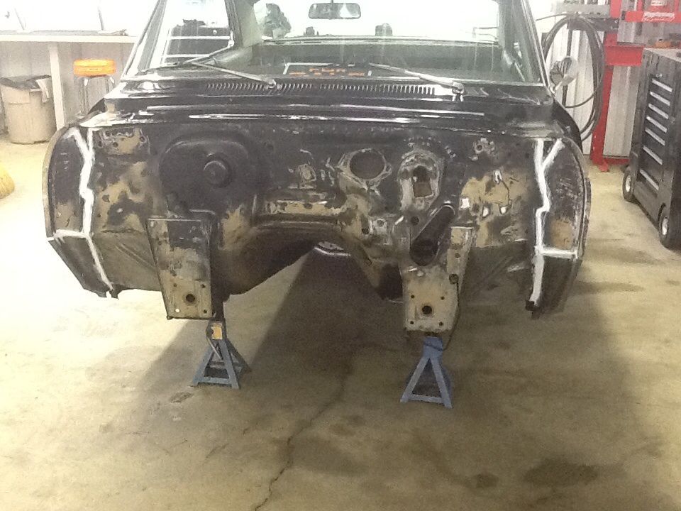

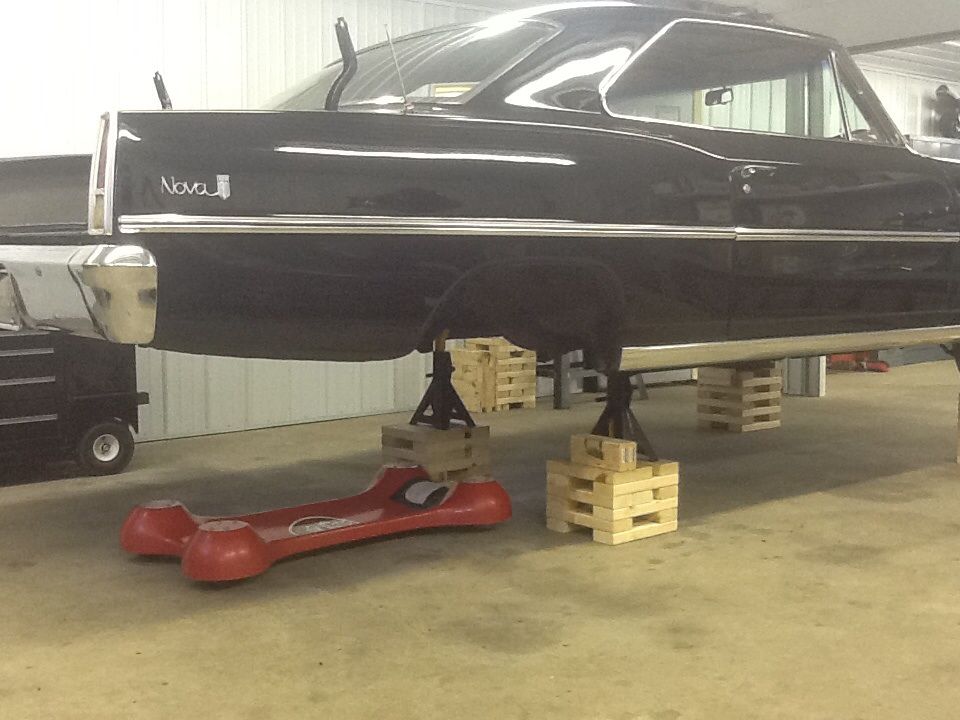

catmanzr 07-18-2014 01:19 PM

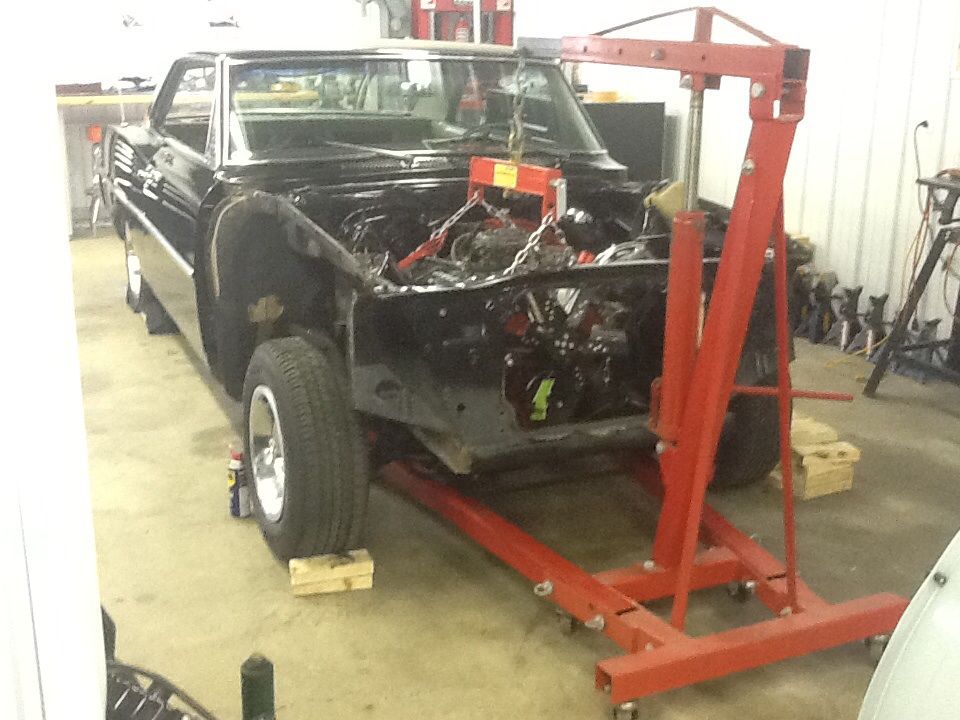

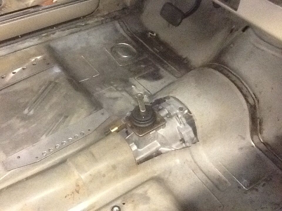

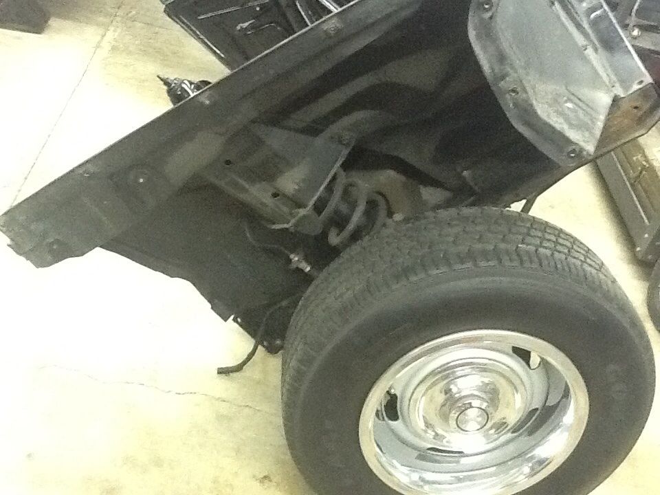

Coming apart......
http://i194.photobucket.com/albums/z...magejpg4-1.jpg
http://i194.photobucket.com/albums/z...magejpg5-1.jpg
http://i194.photobucket.com/albums/z...magejpg6-1.jpg
http://i194.photobucket.com/albums/z...magejpg7-1.jpg
http://i194.photobucket.com/albums/z...magejpg1-1.jpg
http://i194.photobucket.com/albums/z...magejpg2-1.jpg

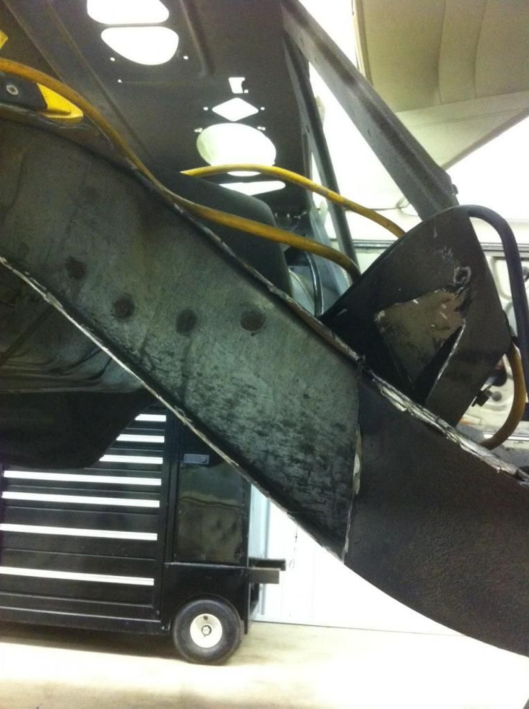

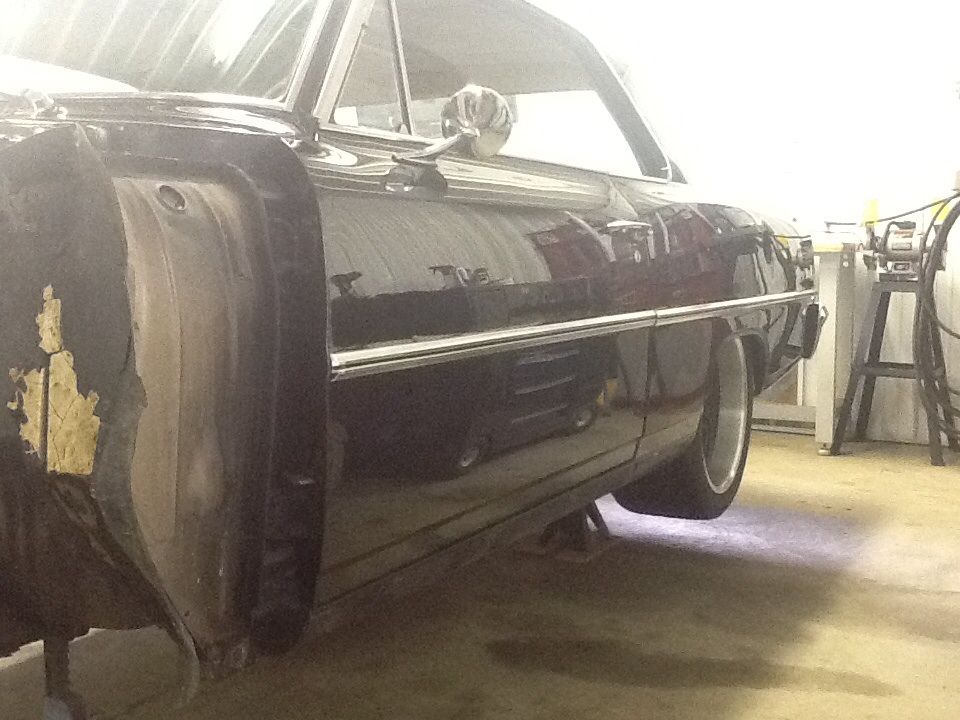

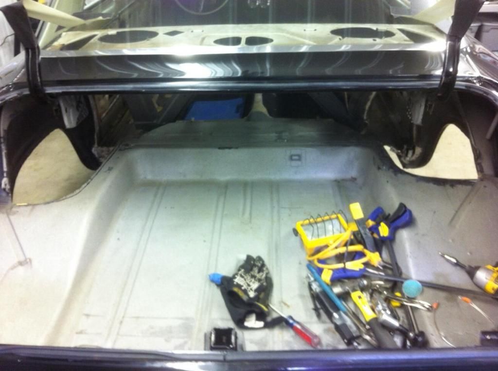

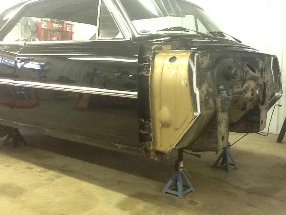

catmanzr 07-18-2014 01:55 PM

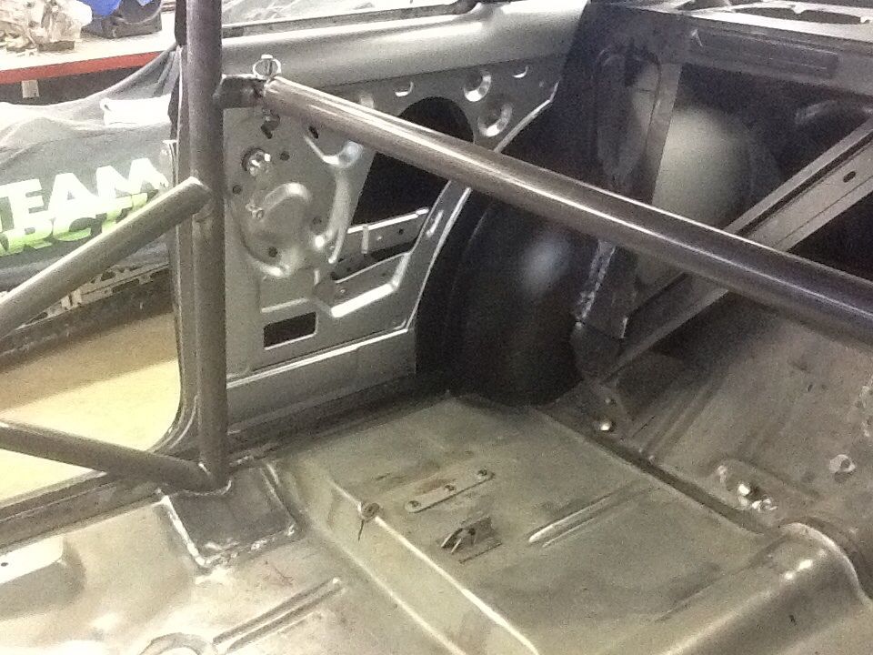

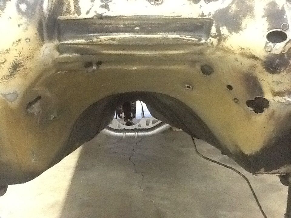

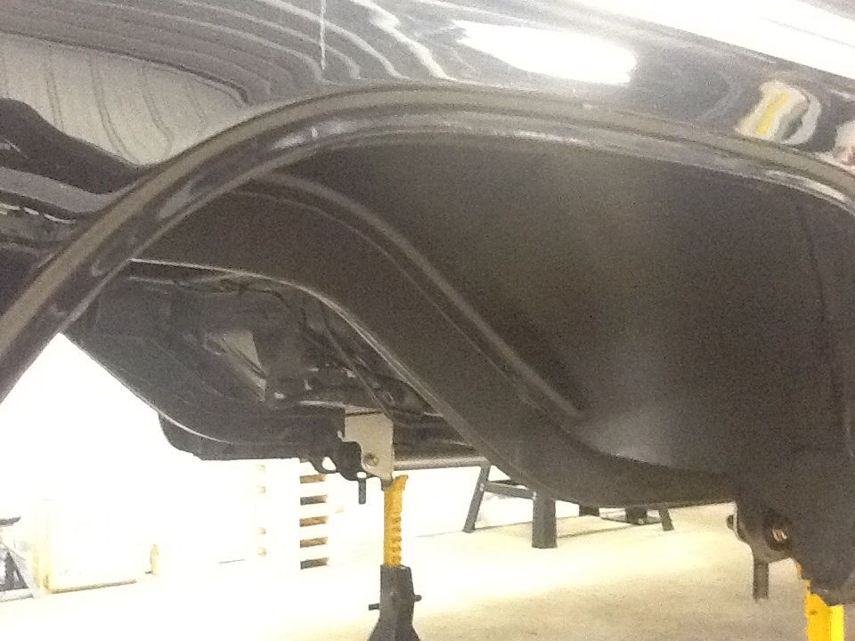

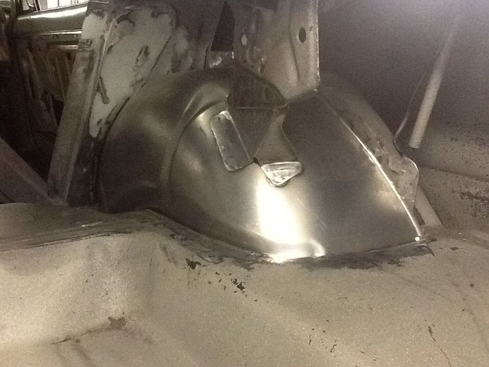

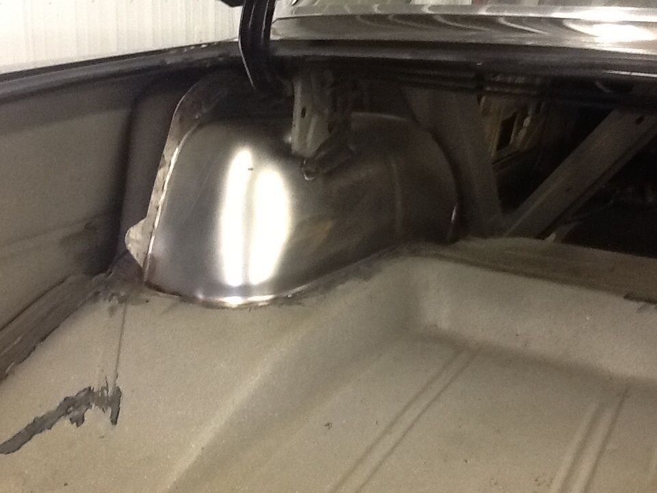

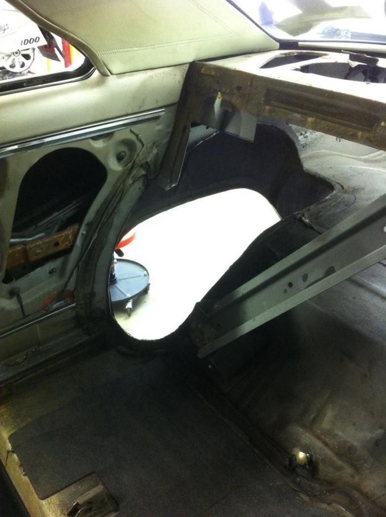

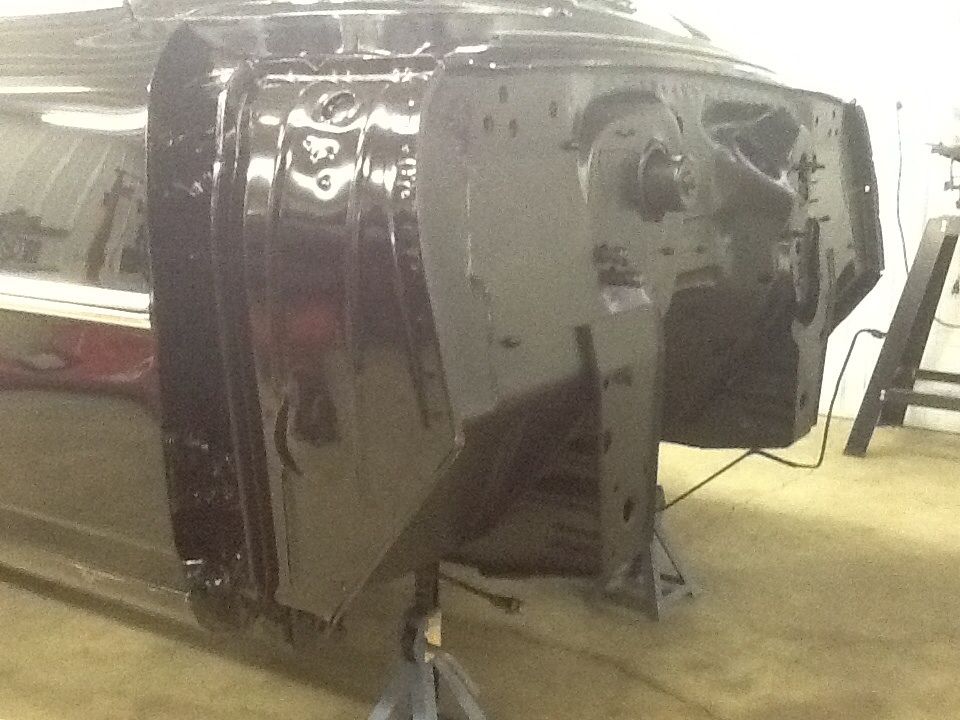

Mini tub process has begun.
Cutting the stock tubs out. Installing DSE mini tubs. I must say that Detroit Speed and Engineering have it going one. Awesome quality!
http://i194.photobucket.com/albums/z...magejpg1-3.jpg
http://i194.photobucket.com/albums/z...magejpg3-2.jpg
http://i194.photobucket.com/albums/z...magejpg2-3.jpg
http://i194.photobucket.com/albums/z...magejpg5-2.jpg

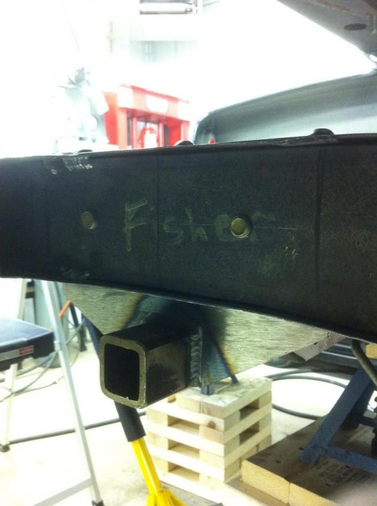

Here I built two 3/8" plates and welded into the frame rails before I boxed them back in. I also bolted in the upper shock mount with 1/2-20 bolts vs the tiny one that came with the TCI rear pro touring suspension. It might be a little overkill but I didn't like the thinned up rails and tiny bolts. I didn't want a problem down the road.
http://i194.photobucket.com/albums/z...magejpg4-2.jpg

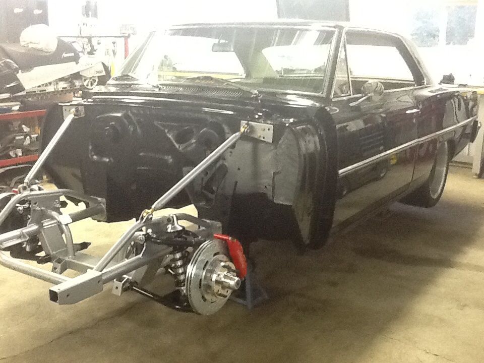

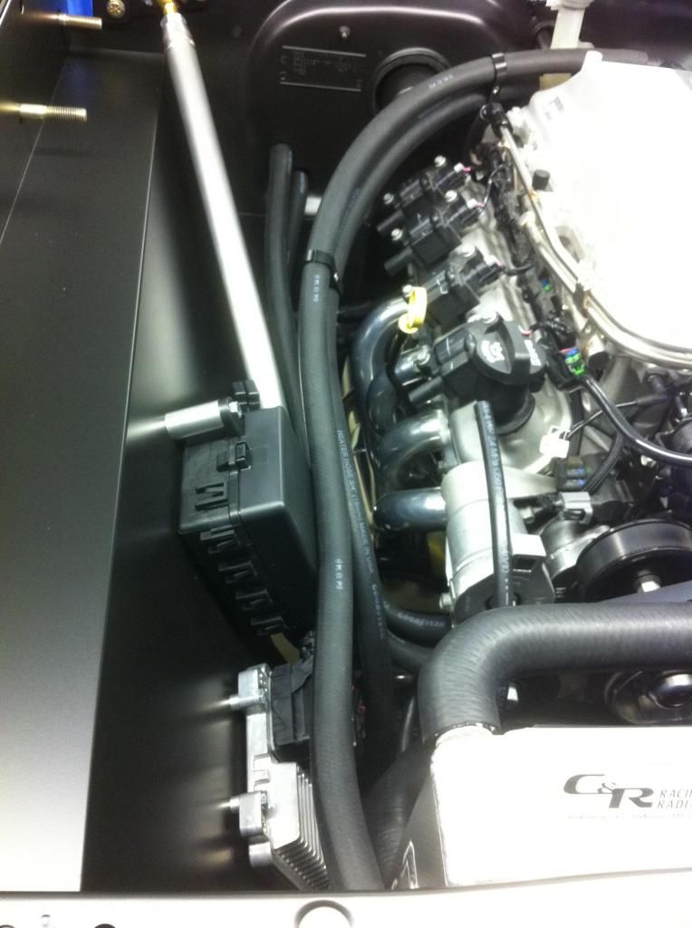

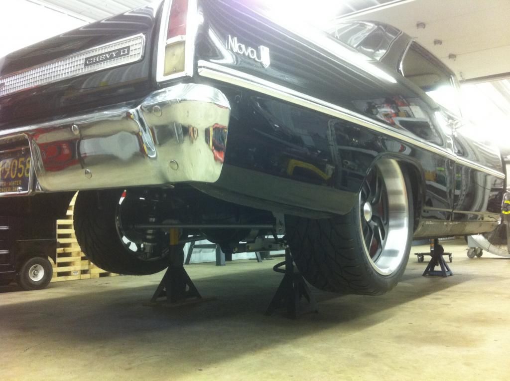

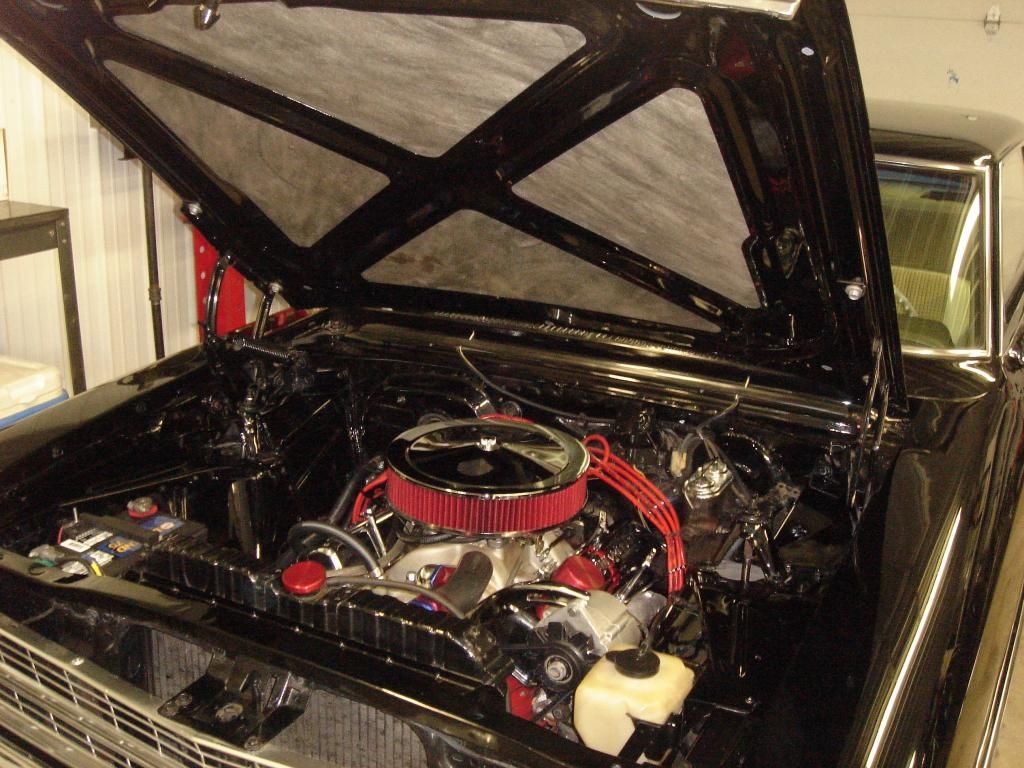

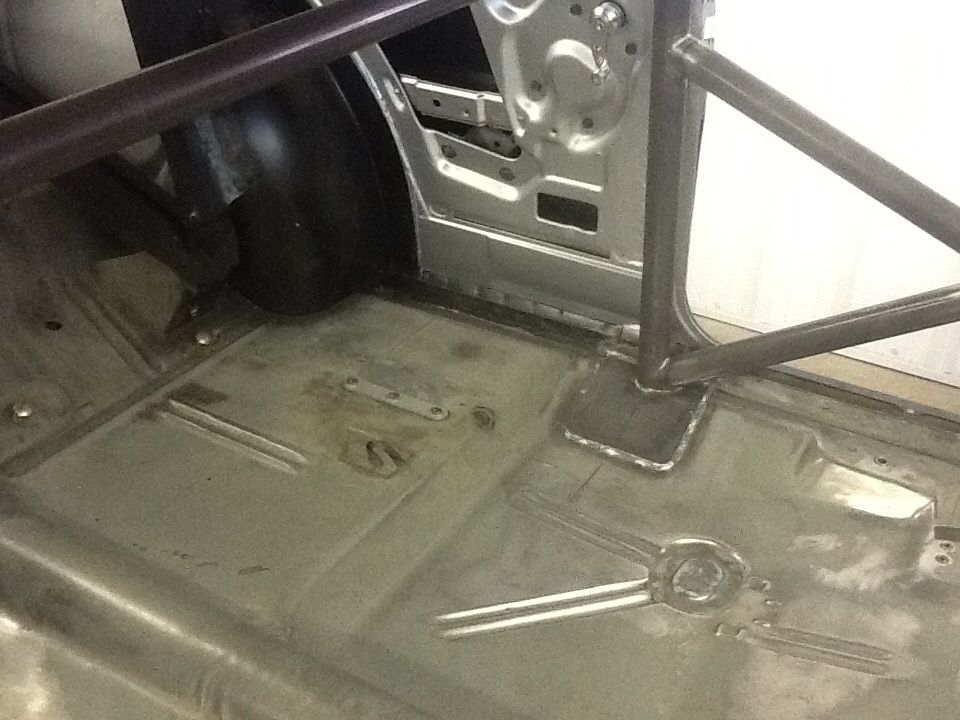

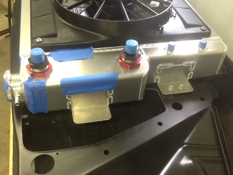

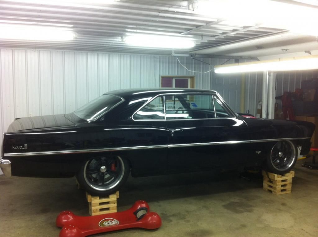

catmanzr 07-18-2014 07:42 PM

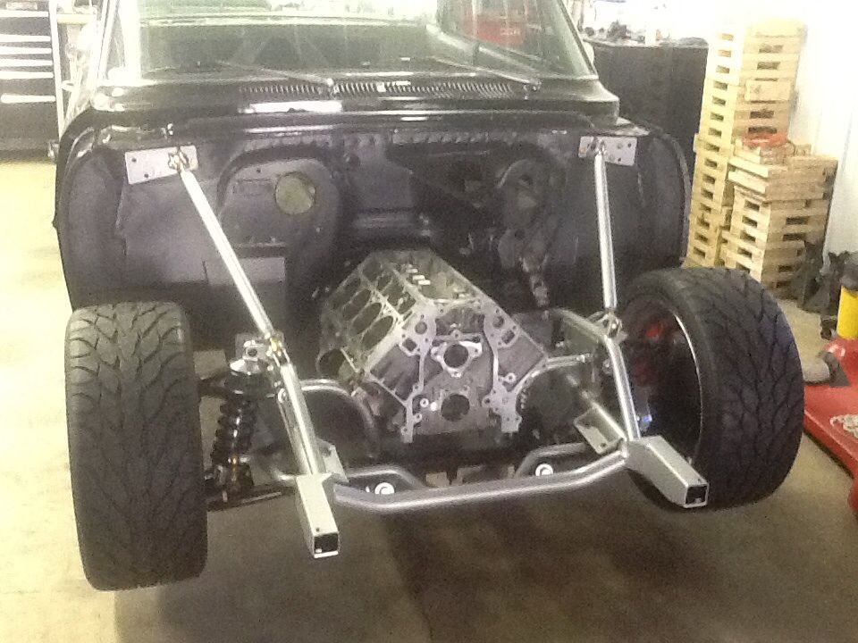

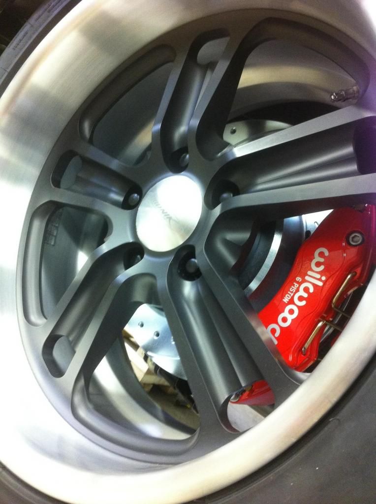

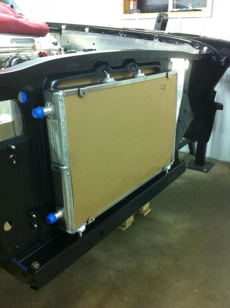

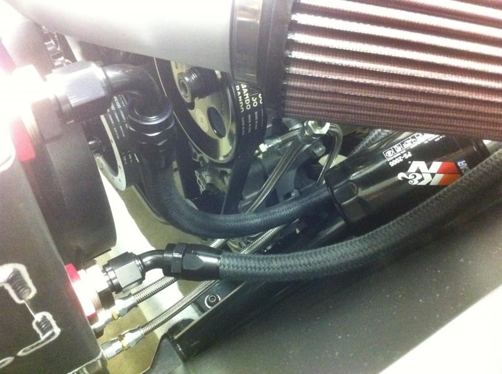

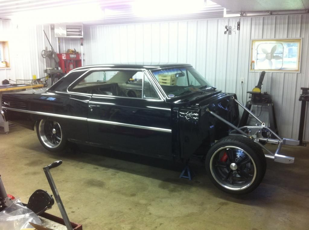

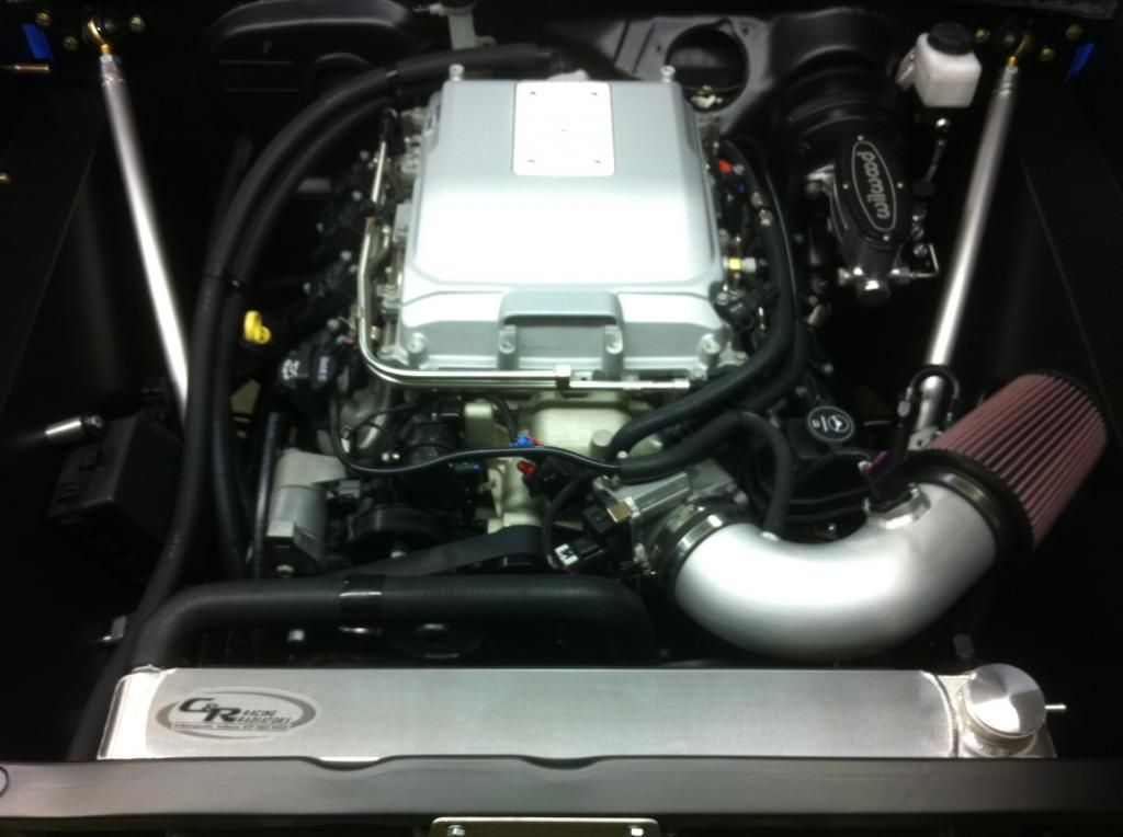

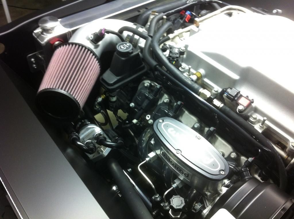

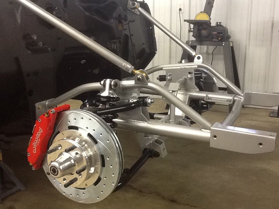

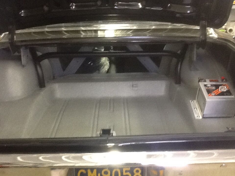

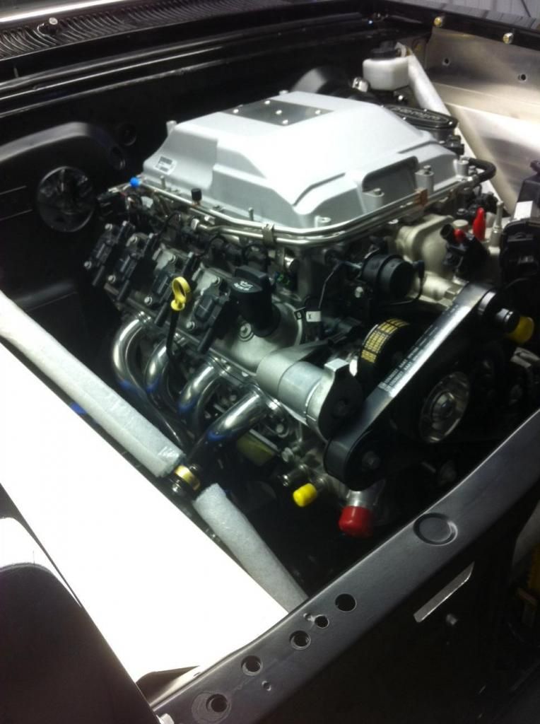

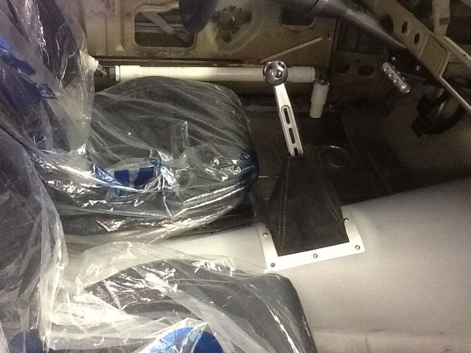

Couple of teezer pics......

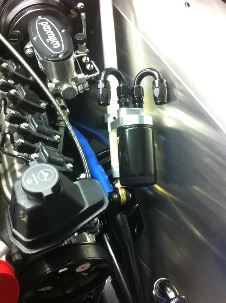

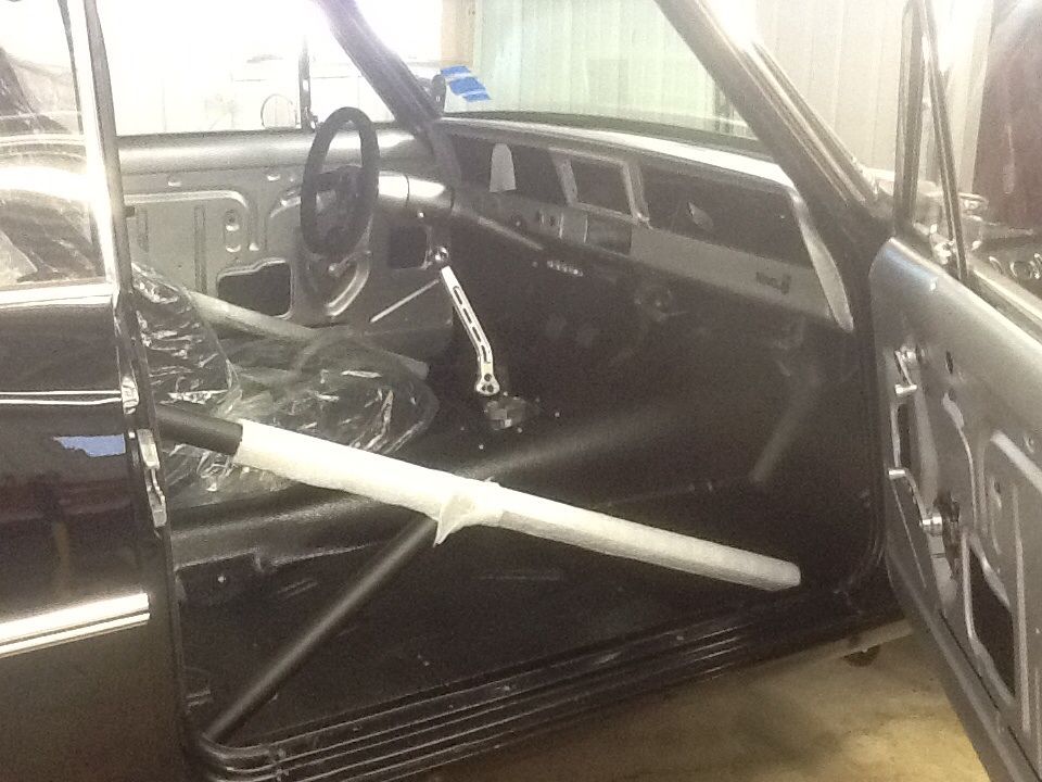

Big items are new LSA, viper t56, tci pro touring suspension front and rear, mini tub, 6 point chrome moly cage, budnik wheels, ricks tank with vaporworx, and a racepak IQ3.
I'll try to get up to date within the next couple of weeks.
Thanks for looking!
http://i194.photobucket.com/albums/z...magejpg1-4.jpg
http://i194.photobucket.com/albums/z...magejpg2-4.jpg
http://i194.photobucket.com/albums/z...magejpg1-5.jpg
