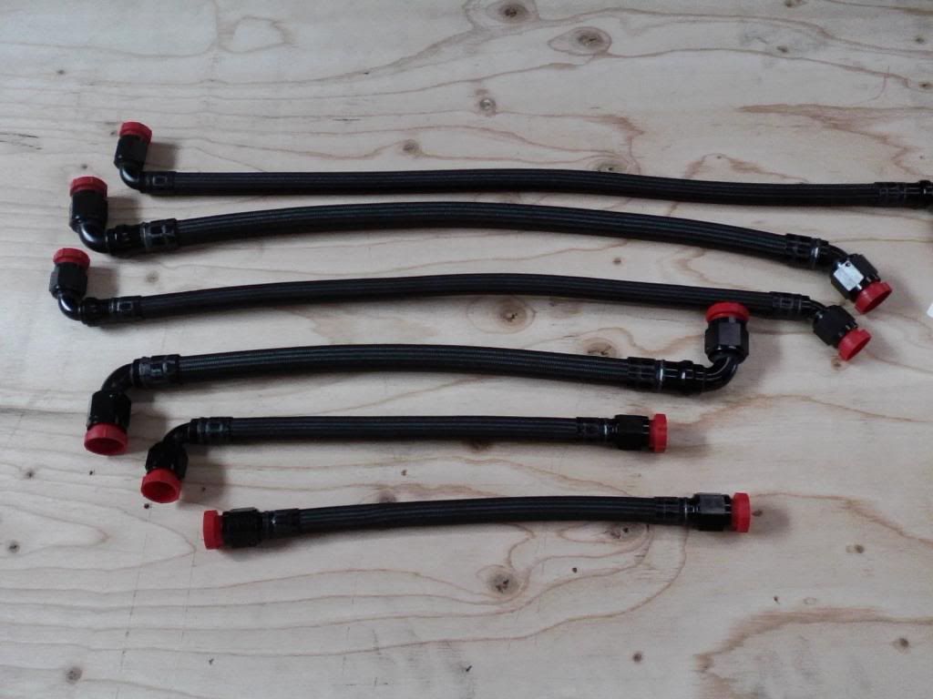

Originally Posted by dontlifttoshift (Post 562185)
Teflon hose is great but I never cared for bend radius or assembling the fittings. The Brown and Miller corrugated Teflon sounds perfect with crimped fittings but I have never had it in my hand. Then there is the braided stainless housing, I just don't care for it and prefer a cloth wrapped hose in black.
I have been using Viton hose from Phenix that is E85 compatible, so a little bit of ethanol is no big deal.
http://www.phenixindustries.com/prod...ss-inner-hose/
We just got some of the Brown & Miller stuff for my fuel system recently from their Socal branch. Super nice and light stuff. A little spendy. :headspin:
http://i236.photobucket.com/albums/f...ps2bef0804.jpg
Che70velle 07-23-2014 07:53 PM
Is the Brown and Miller hose a PTFE hose? I haven't heard of them before.
