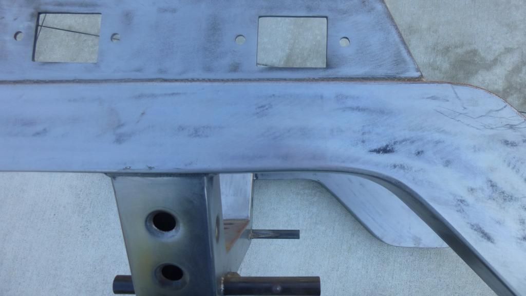

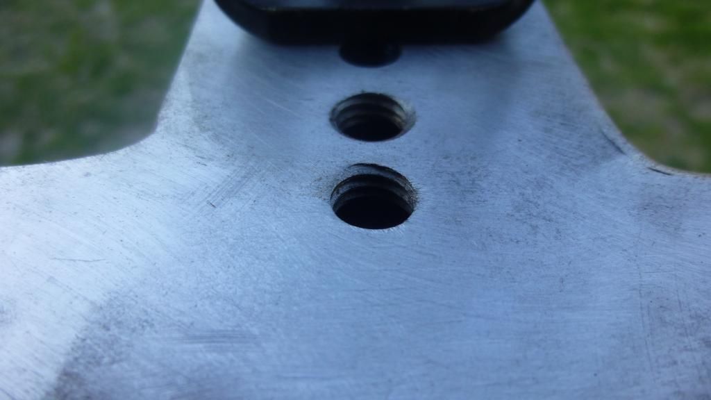

In the image above, the holes drilled didn't quite line up, so Scotts shop just cranked the thread cutting bolts up on an angle! Problem solved!

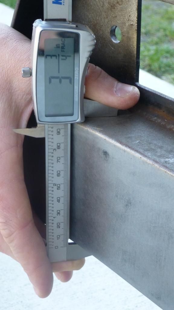

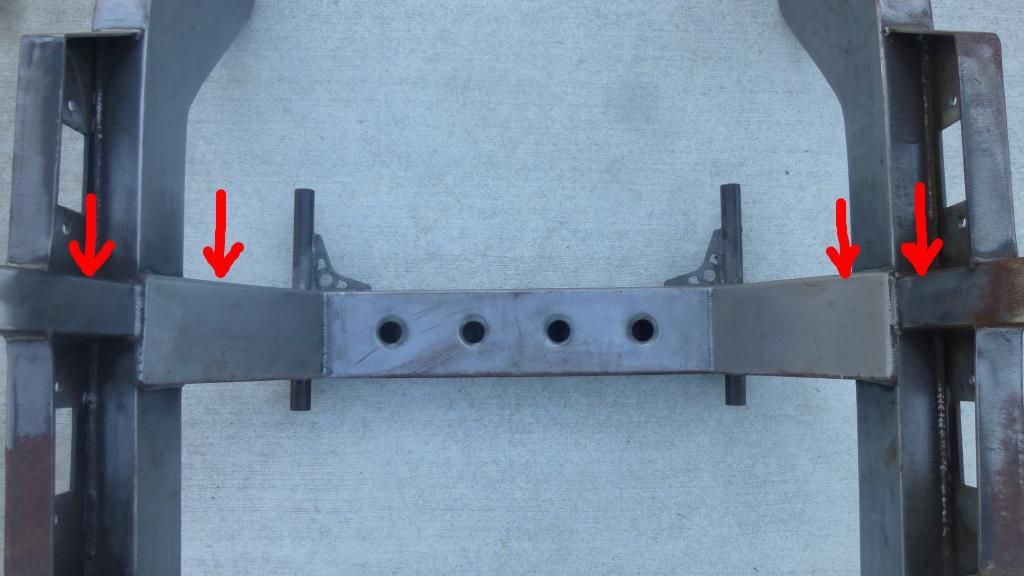

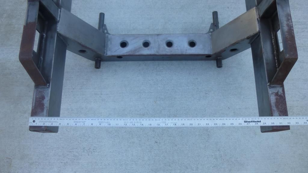

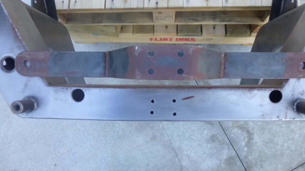

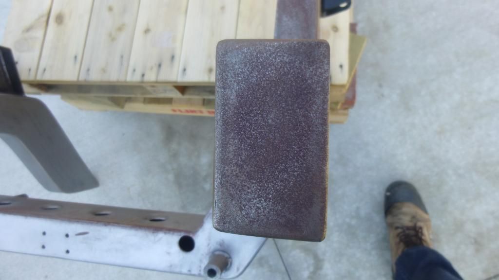

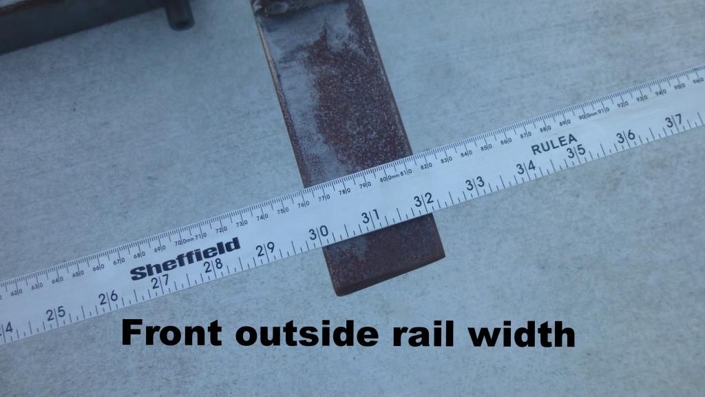

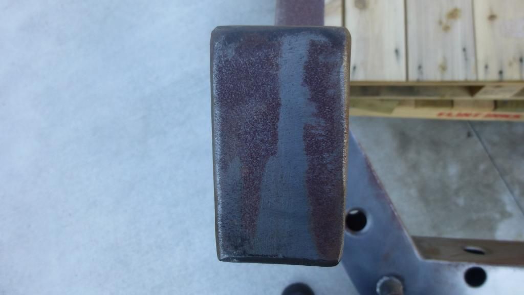

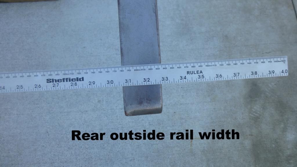

The clip rails are 3/4 of an INCH, out of parallel. The crossmember, which the LCA's mount off is 1/6 of an INCH out of square with the rails. It became obvious that the car won't have a hope of driving straight installed as is. On top of that, once I had the clip DA'd and could see the perspective of Scott’s handmade CNC rails, you could then make out that they varied in height and width and were not even rectangular.
http://i803.photobucket.com/albums/y...ps3c982ecd.jpg
In reference to the above pic, if you can see it with the naked eye you know it won’t be hidden on the alignment machine.

That's not at the worst point either ^^^^^^.

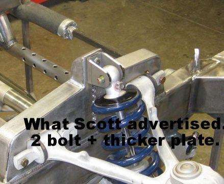

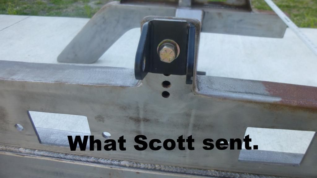

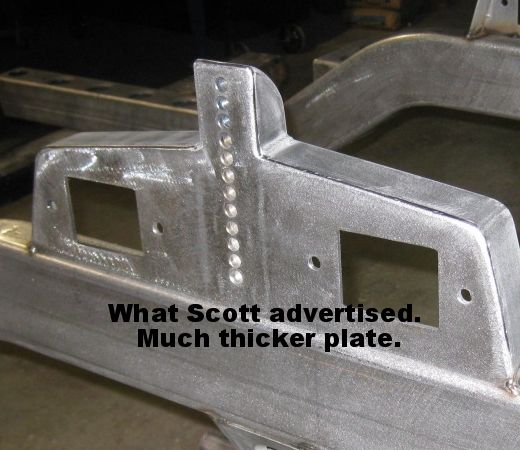

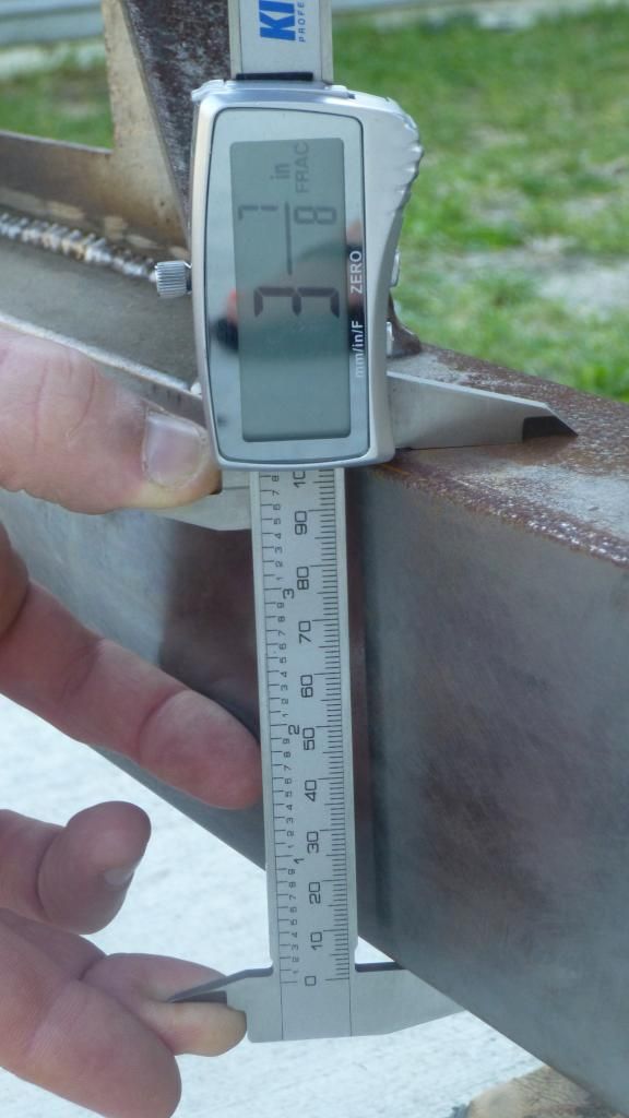

The most disappointing thing was the upper coil over mount design. One 3/8 bolt tapped through 1/8 thick steel was supposed to hold up one corner of a 3500 lb+ car? 3 - 4 threads max? No way I'd park my build on that let alone do 150mph in it. I note the clips on Scott’s cars that he posted on Lat-G to "advertise" (before the pics were removed) had a much thicker plate inside the frame/upstand, and two bolts securing the bracket.

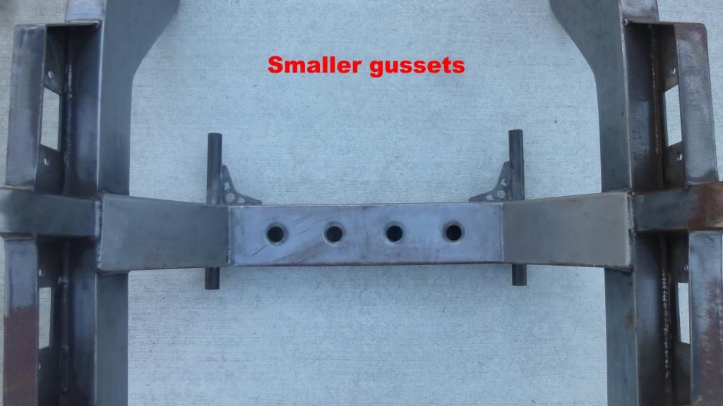

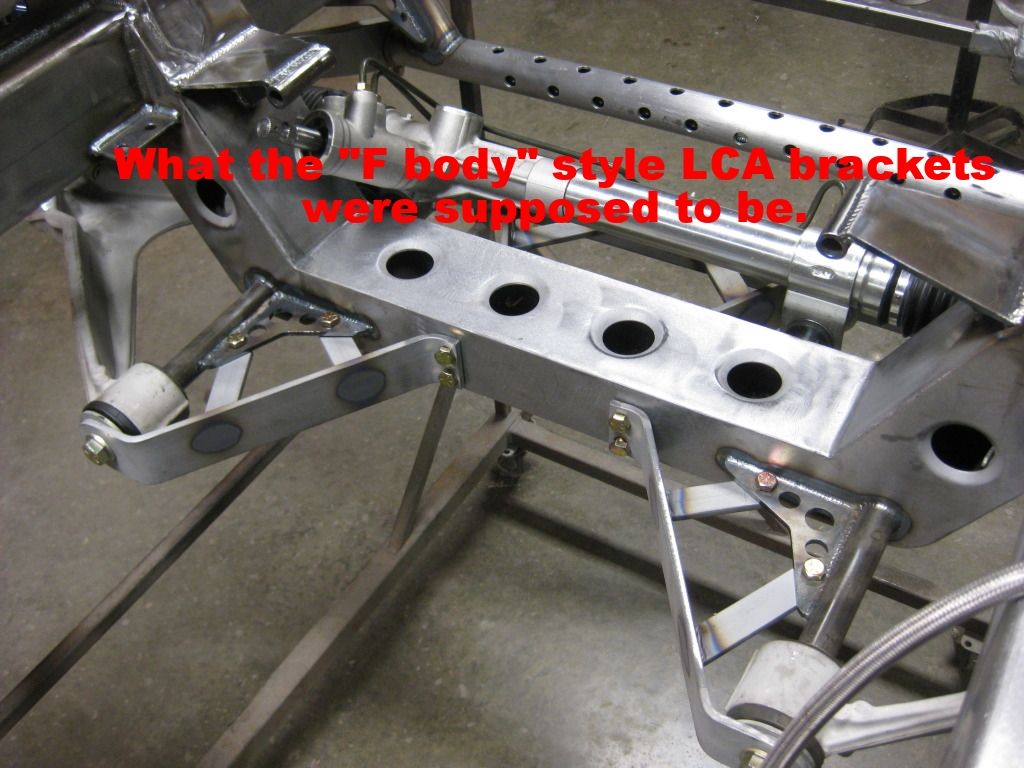

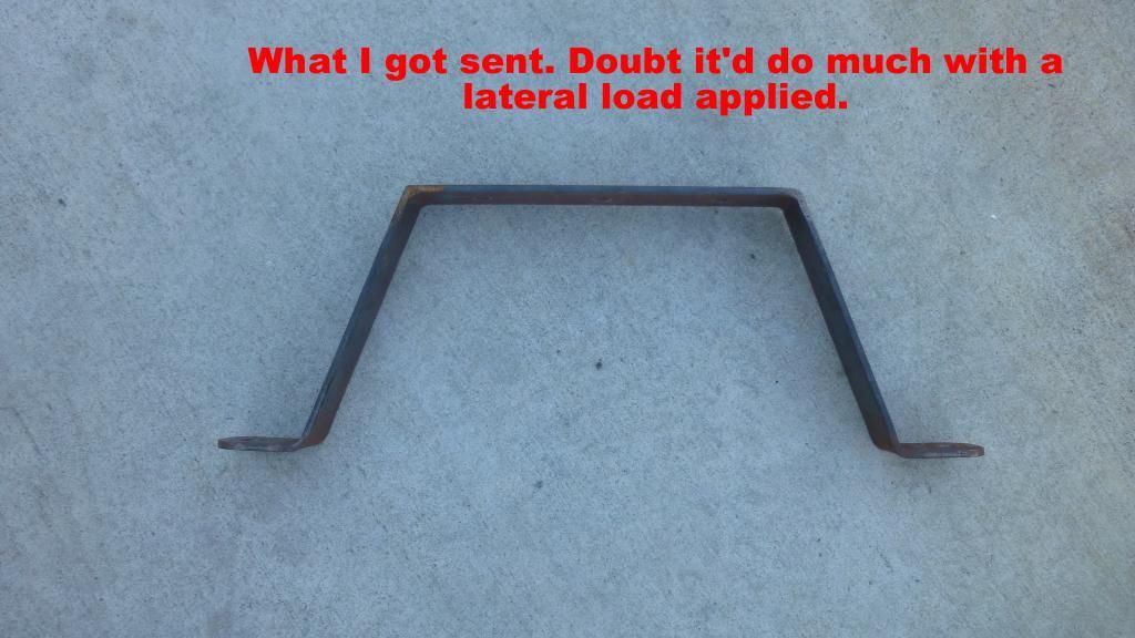

This isn't even the end of the problems, there's the core support mounts that weren't supplied to weld on, the upper a arm bolt holes that were drilled different sizes......but this post is long enough already!
