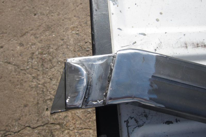

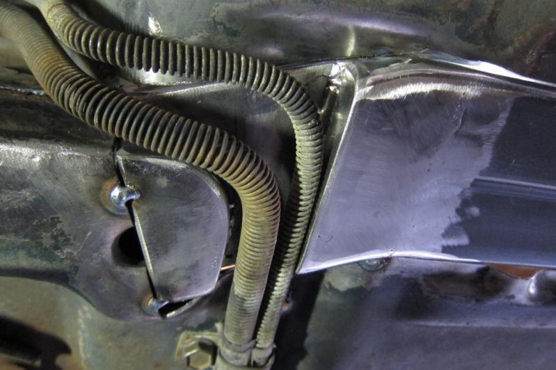

How does everyone handle this? I dont know if I want the line running under the frame rail.
carbuff 07-29-2014 04:19 PM
I recall someone posting a picture recently in which they notched the connector where the brake line passes to give if a 'channel' to pass through. That way it wasn't below the line of the connector...
Can't remember which thread that was in, but it wasn't that long ago...

Rick D 07-29-2014 06:24 PM
Originally Posted by Ron in SoCal (Post 563362)
^ That was Vince and Trey I believe.
Yup Vince did it and shared it with us, here's Treys pictures.
http://i79.photobucket.com/albums/j1...psdb54a244.jpg
http://i79.photobucket.com/albums/j1...psdadb5102.jpg
