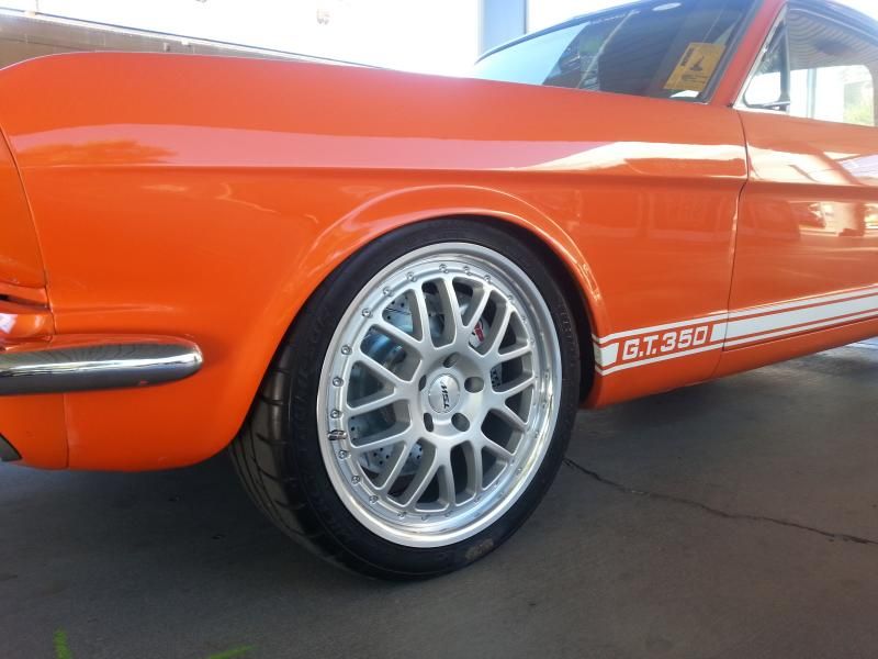

Showwheels-Chris 08-21-2014 05:05 AM
9 Attachment(s)
Originally Posted by John510 (Post 563524)
I am looking for some 18's for a 65 Mustang. Nothing too pricey. One piece will work. Just some cruiser wheels
Any ideas? Does anyone happen to know the backspacing I should get by the way? Stock suspension for now but will lower in the future.
Hi, it's Chris from Showwheels in Anaheim.
We have a 1 piece wheel machined to order.
For a lowered 65 in 18" we use 7s on the front at 4.5" BS to avoid tires touching the fenders when cornering and 4.75" BS on 8" wide rears to tuck under.
Contact me any time, thank you, Chris 714-524-3100 www.showwheelsusa.com www.kwcforged.com
