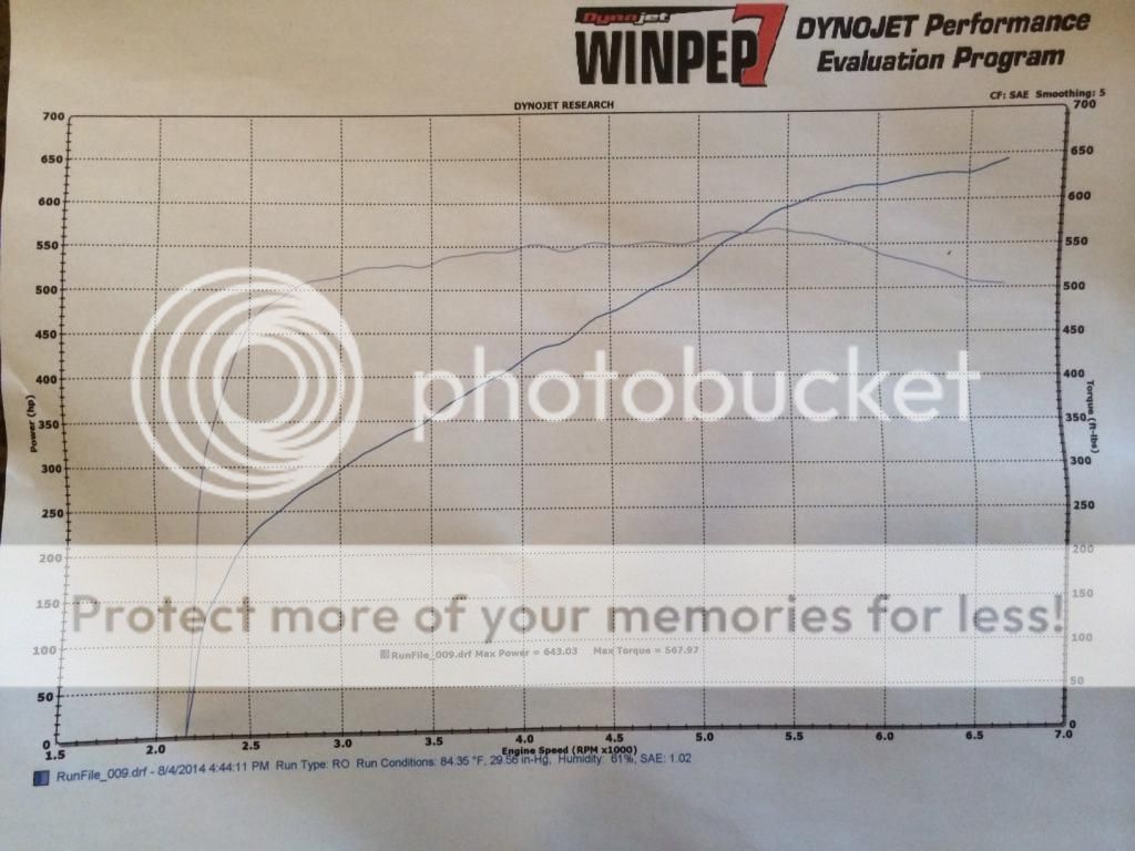

Now I originally thought it would make 8pds of boost, but I guess I got the wrong pulley, cause 12psi later we made some real steam:
http://i791.photobucket.com/albums/y...ps937619bb.jpg
643 RWHP and 568 RWTQ!
Ed gave it a really conservative tune and said the motor could take a lot more, but I was more than happy considering going in that I was going to make around 550 rwhp.
