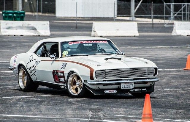

pretty good! I'm sure someone will back me up on that
http://i1380.photobucket.com/albums/...ps1acb95c4.jpg

Haha, nice!
Yea you guys have convinced me. I didnt think I could get a 4 link set up for under $2500 let alone 2k
I was reading through the instructions, seems pretty simple install. Only thing that might kick my butt is the welding onto the pumpkin. My welding skills are lacking, but I do have a buddy that is pretty good. Either that or get a shop to do it.
