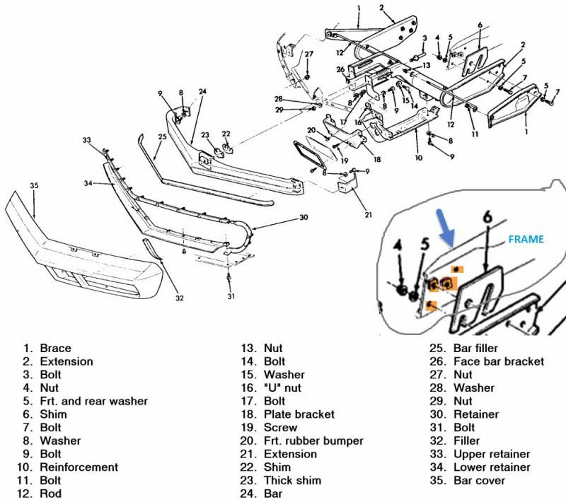

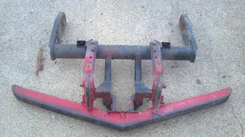

So Can you pull off the bumper brackets/frame extension on a 73 Vette and bolt on the bumper hardware for a 68-72?
Here is how it looks on a 1973
http://i47.photobucket.com/albums/f1...ps3b5b3d5c.jpg
I couldnt find a picture of an earlier one, but here are some diagrams
1973 Front bumper/frame extension assembly diagram
http://i47.photobucket.com/albums/f1...ps7635d2ba.jpg
1968-73 Front bumper/frame extension assembly diagram
http://i47.photobucket.com/albums/f1...ps9a07a2c2.jpg
From those pictures seems like the brackets are interchangeable.
And yes I know that the front fibreglass is different, but that will be changed.
Anyone done this? Have any info?

The conversion can be done. Look over at the Corvette Forum some people have done it there but, I would look for a suitable donor vehicle as all the little bits can cost $$$$. I know a guy who took a 73 coupe and converted it into a 69 roadster but, after building a 600HP 427 he wrecked it pretty badly and quickly lost interest in the project. Corvette Image has stock type glass, the more common 1 piece front ends will shift around in the heat. The front fenders are bonded to the steel windshield frame below the windshield opening, they pop off pretty easily with a flat pry bar if they are original bonding material the rest is pretty much bolted onto various chassis parts and the radiator support.

As for your question, the answer is yes, you can do the swap fairly easily but the entire front clip has to be changed. Everything from the windshield forward. You could graph the 68-72 front fiberglass onto the 73 front clip. To be correct though, the front clip is different. Pretty much anything you might need is reproduced or available from junk yards. The question is budget and time. Sounds like he's going to be putting a lot of both into the car either way. I agree he might as well build it how he wants. However, I would suggest he keep his eyes open for a 68-72. They can still be had in good condition for reasonable prices. If he's patient and willing to travel, he can pick up a complete and running 68-72 for about what it would cost for just the fiberglass parts needed to fix his 73 if he's looking at buying new panels.
