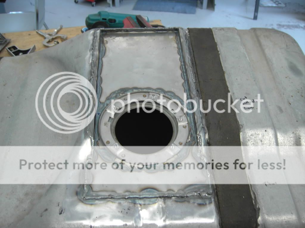

Dropped the tank to do some work and no surprise, my original welds aren't leak proof. The setup works otherwise so I was hoping I could just put some sealant over the seams. Does such a sealant exist?

Thanks guys. I've thought about draining it and getting it brazed or rewelding it since it is out of the car. It not leaking much at all and only at the top when the tank is very full. I'd say it's weeping more than anything. No drips on the ground or anything that's why I think a sealant will do me just fine.

Smaller leaks are the worst, there is still a lot of vapors collecting under there. Are you sure it's not a sender seal not seating?
Make sure you clean it up good.
WSSix 08-30-2014 09:55 AM
That's mainly what I'm trying to stop is the smell when the tank is full. I'll double check but the leaks are around the plate I put in that holds the sender/pump assembly.
Around the perimeter of the recessed plate is where it's weeping from.
http://i472.photobucket.com/albums/r...d/PICT1023.jpg
Musclerodz 08-30-2014 11:12 AM
MIL-8802 fuel tank sealant. Comes in different work times, half hour to two hours. Can be bought at Aircraft spruce or wicks.
