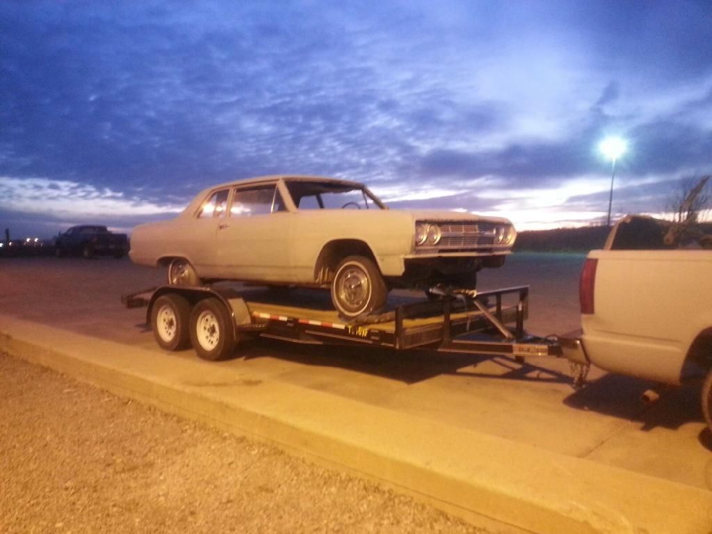

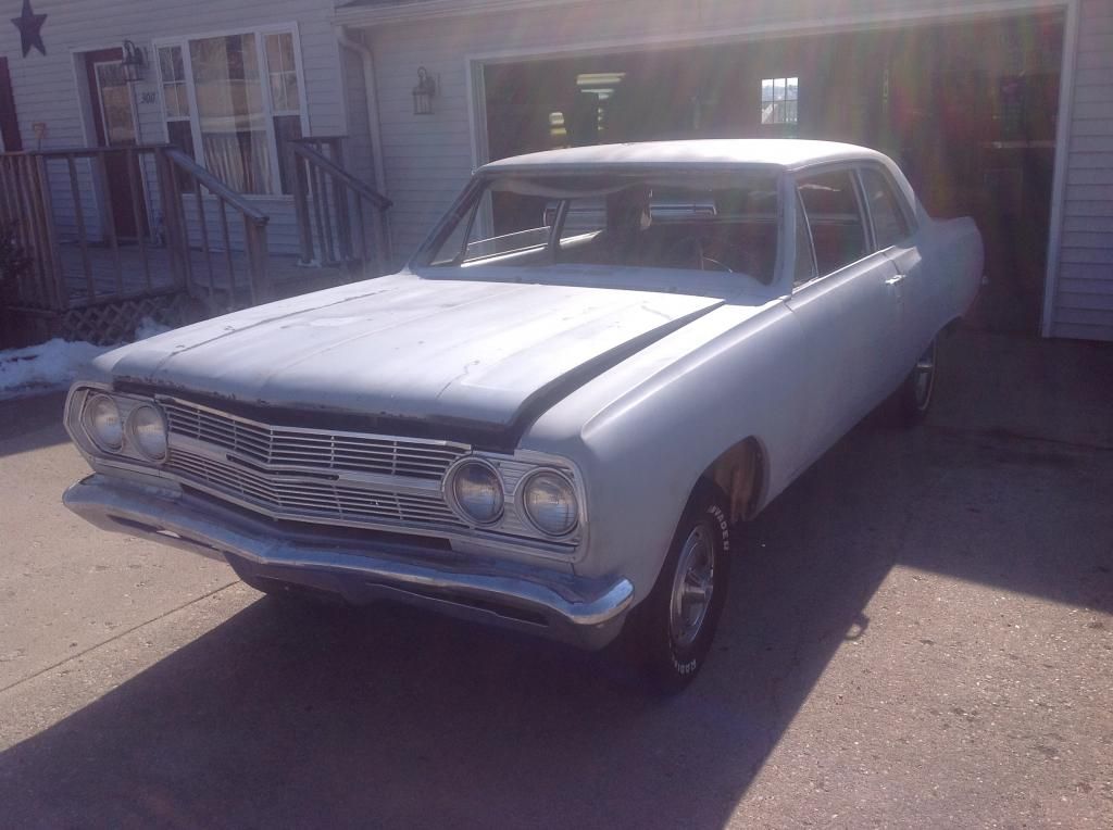

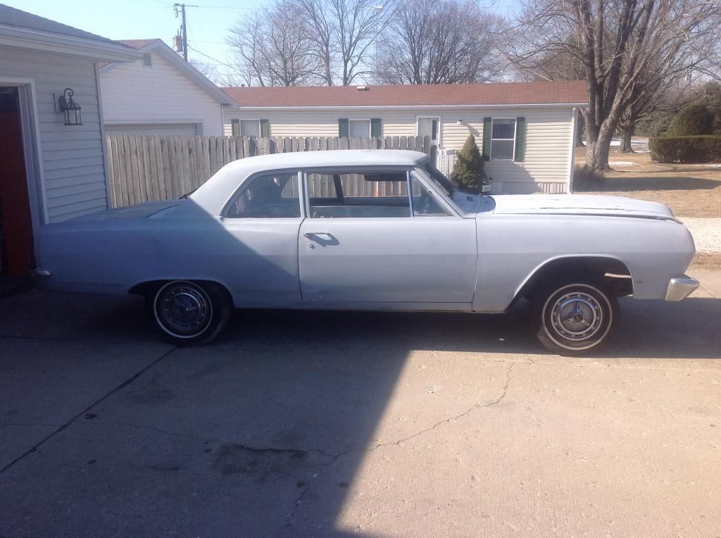

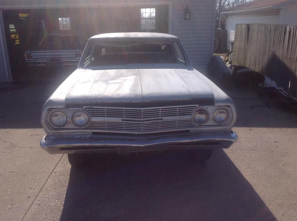

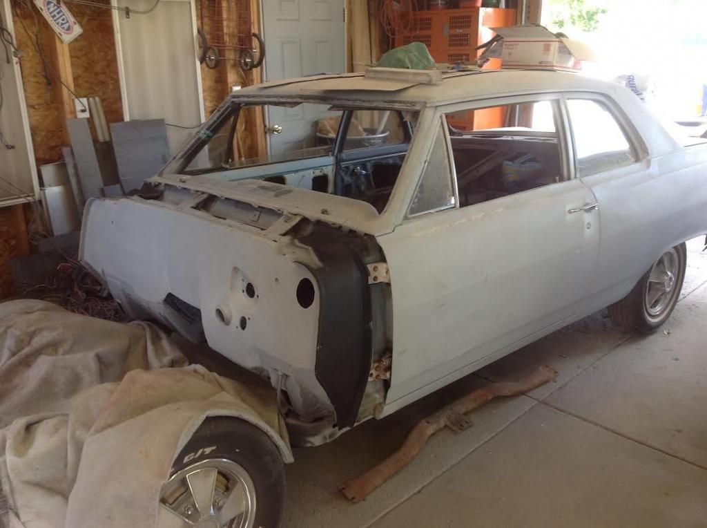

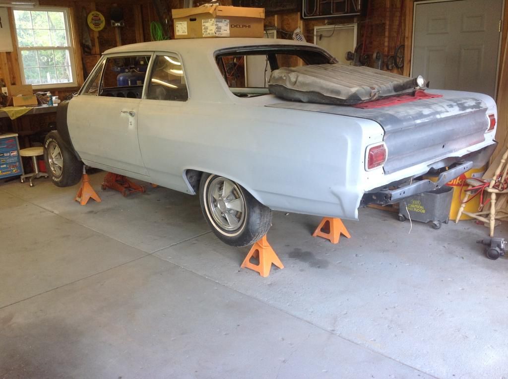

chris_65 09-05-2014 11:52 AM
http://i1276.photobucket.com/albums/...s8002d6b5.jpeg
http://i1276.photobucket.com/albums/...s0cbaf23a.jpeg
http://i1276.photobucket.com/albums/...sd38d2068.jpeg
This is how the car looked when we picked it up in St.Louis

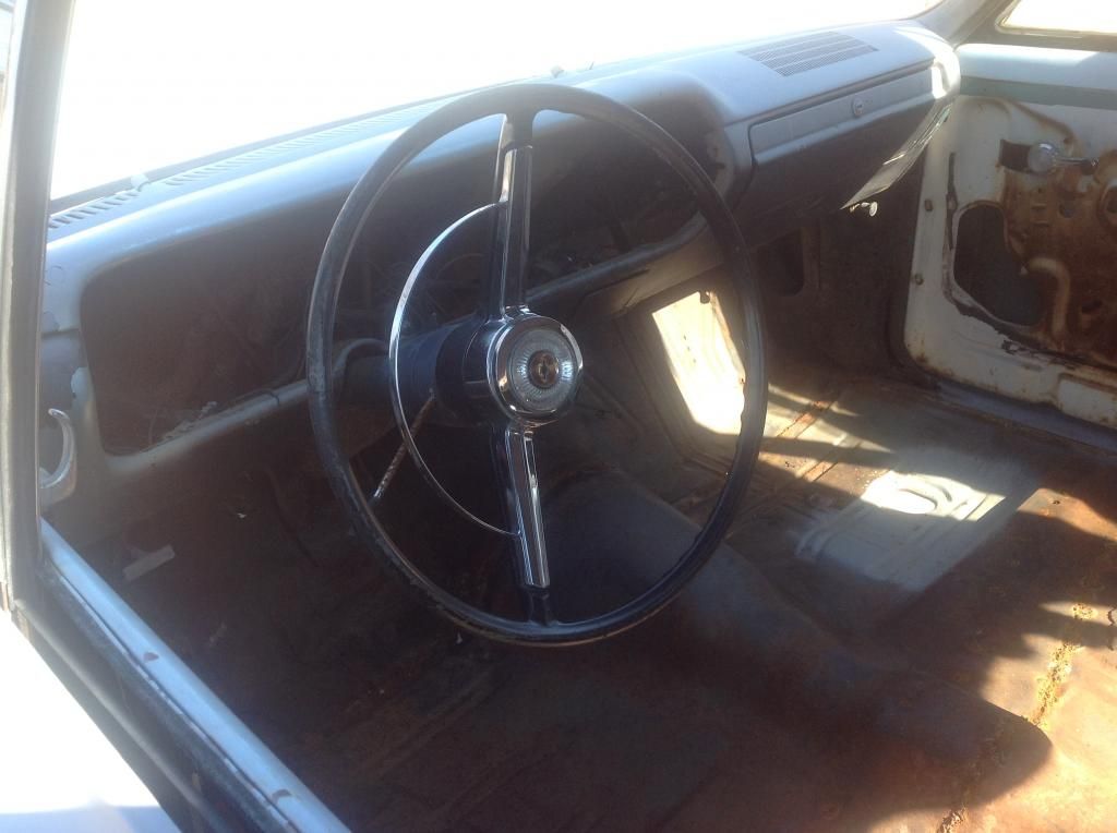

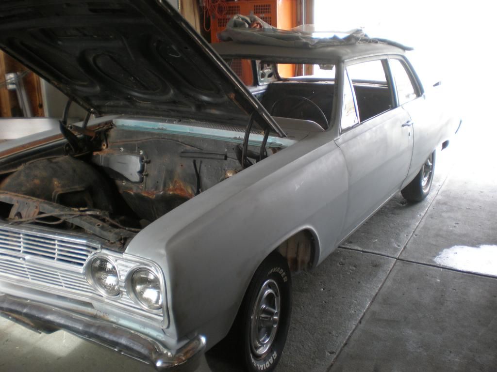

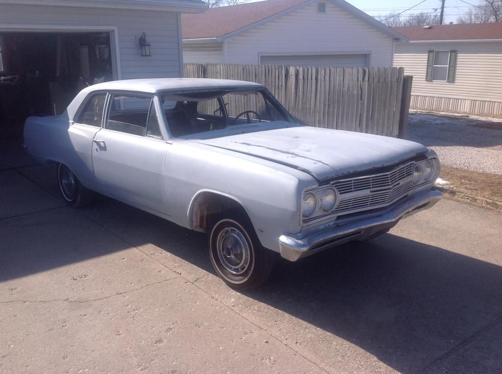

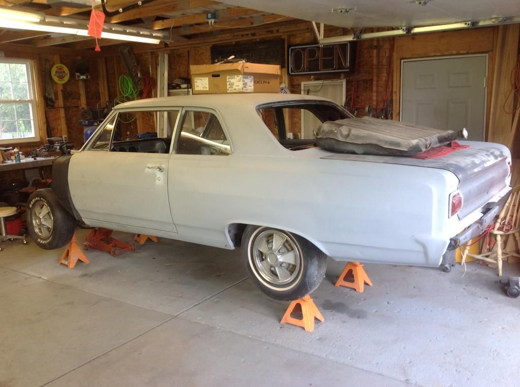

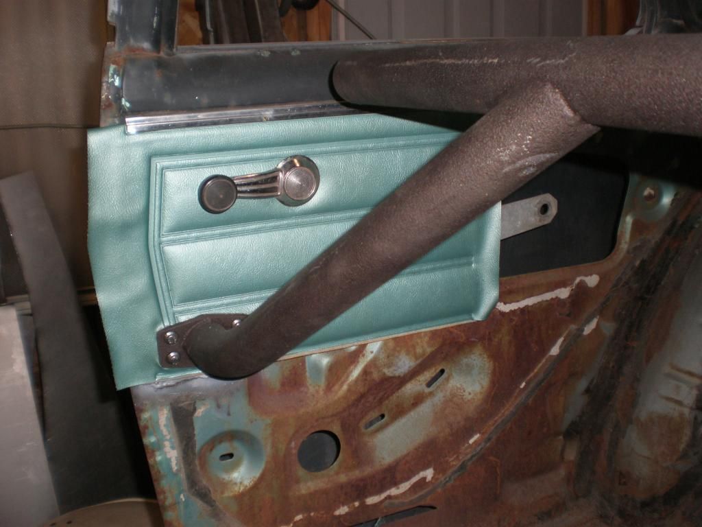

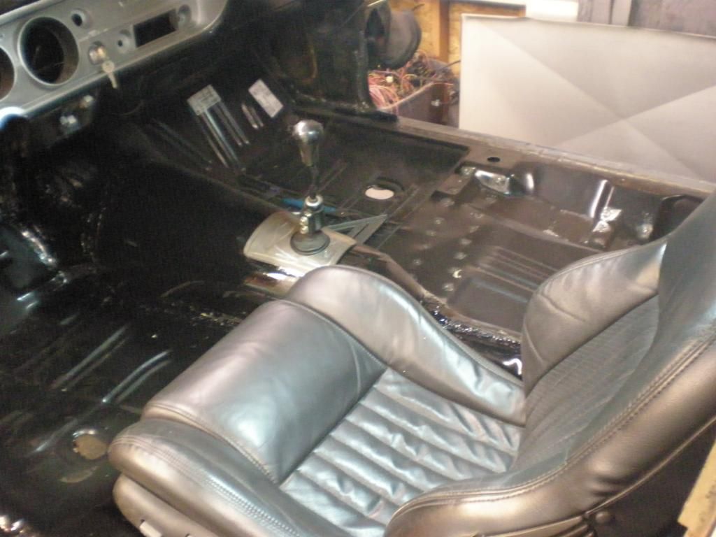

chris_65 09-08-2014 11:56 AM

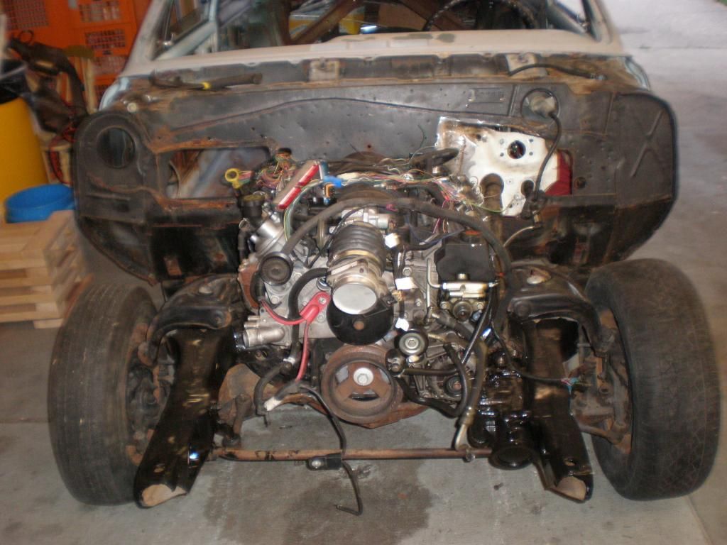

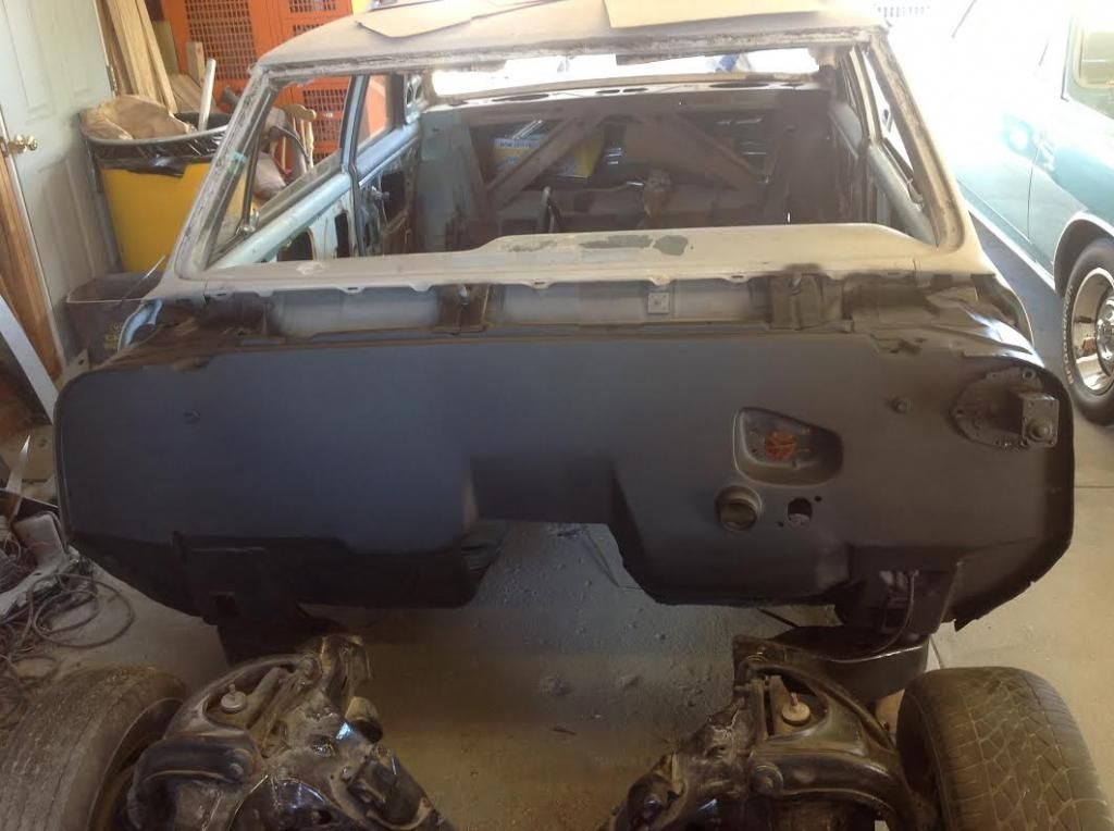

3-15-14 Back home in Indiana...
http://i1276.photobucket.com/albums/...sb091e11c.jpeg
http://i1276.photobucket.com/albums/...s27c58af4.jpeg
http://i1276.photobucket.com/albums/...scd80e272.jpeg
http://i1276.photobucket.com/albums/...sa6780608.jpeg
http://i1276.photobucket.com/albums/...s660d0652.jpeg

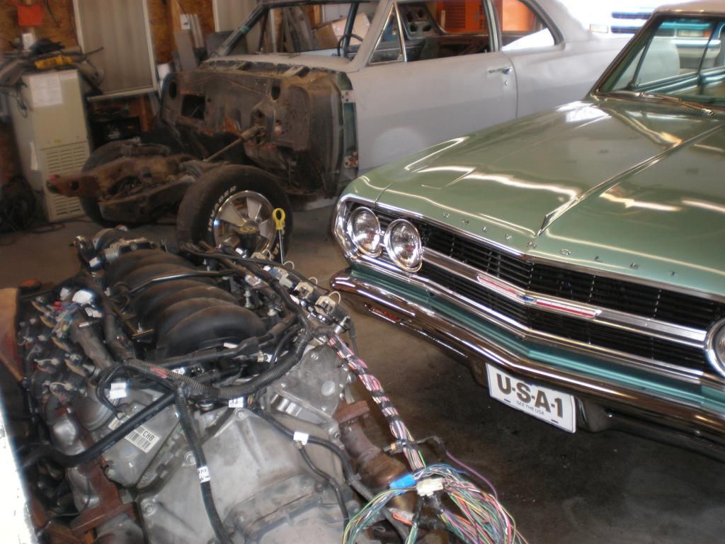

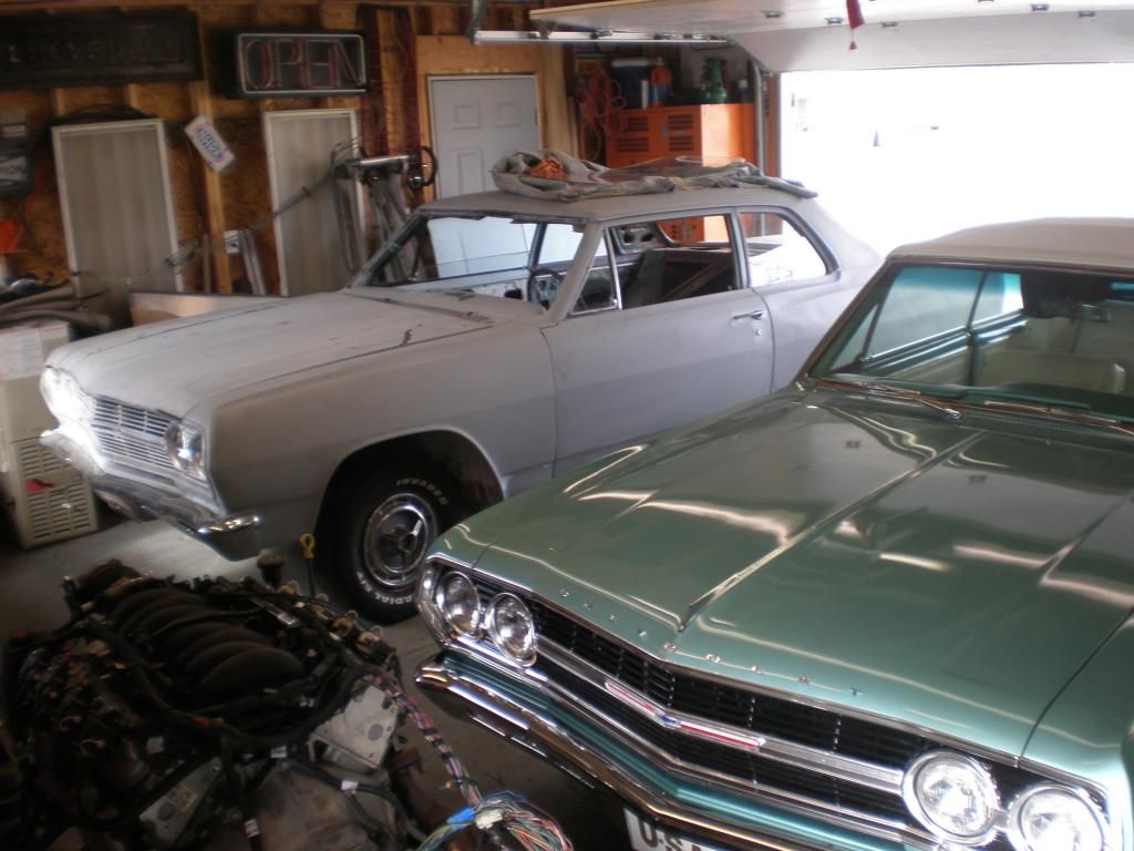

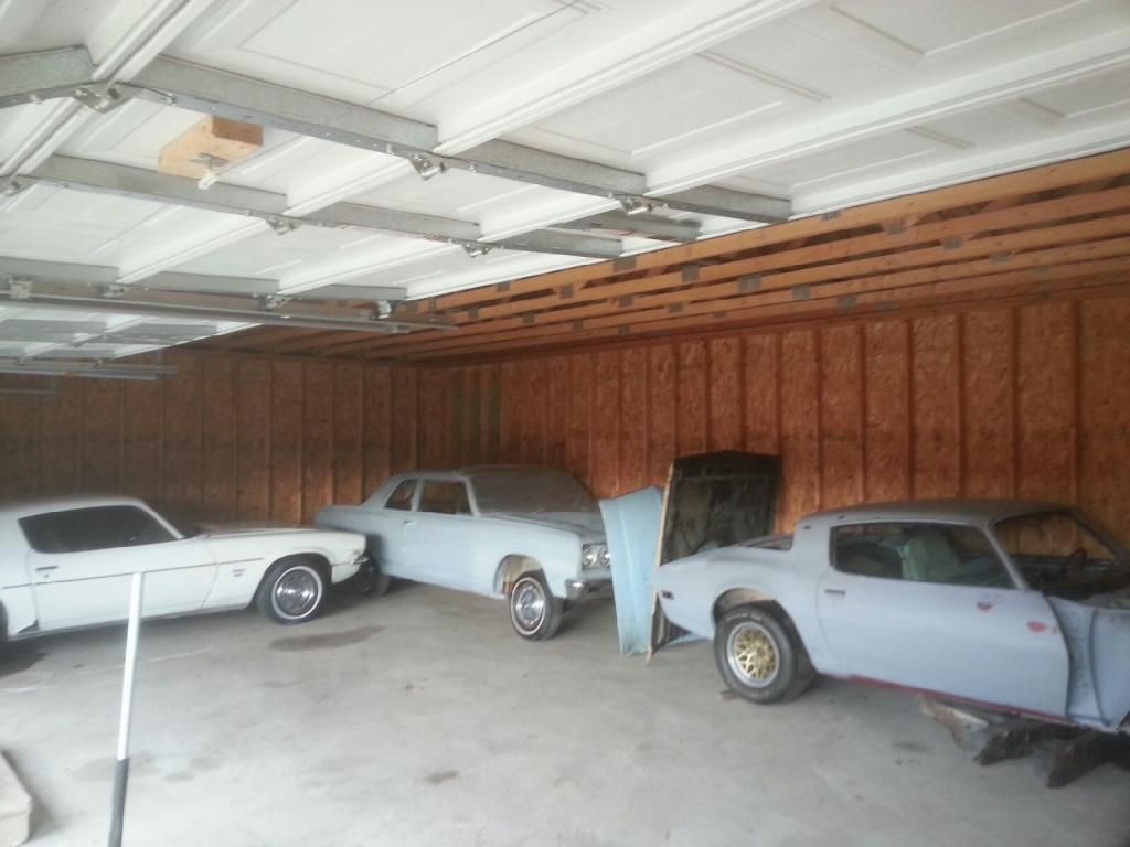

chris_65 09-08-2014 12:01 PM

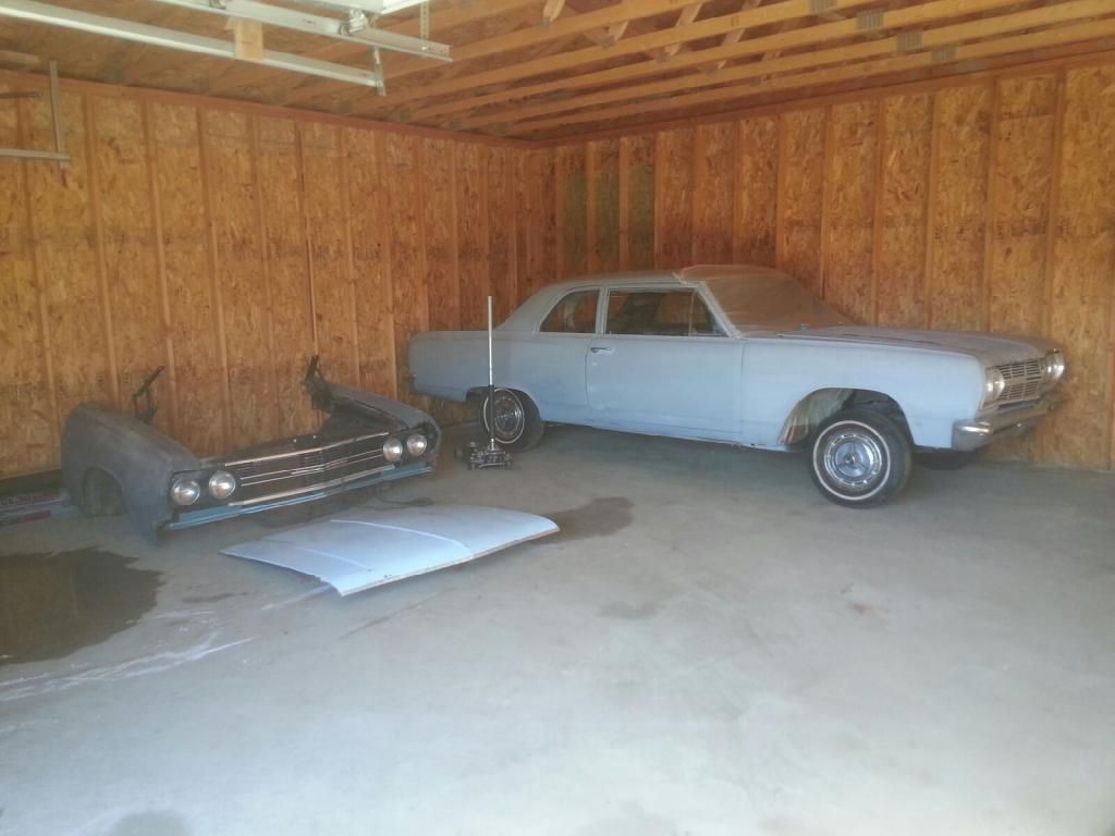

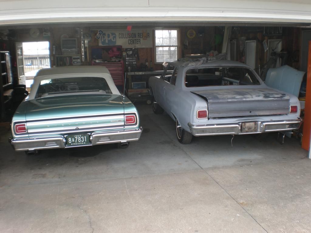

Getting acquainted with it's stable mate...
http://i1276.photobucket.com/albums/...ps95907a42.jpg
http://i1276.photobucket.com/albums/...ps0dd6c6bf.jpg
http://i1276.photobucket.com/albums/...psea1c20cd.jpg

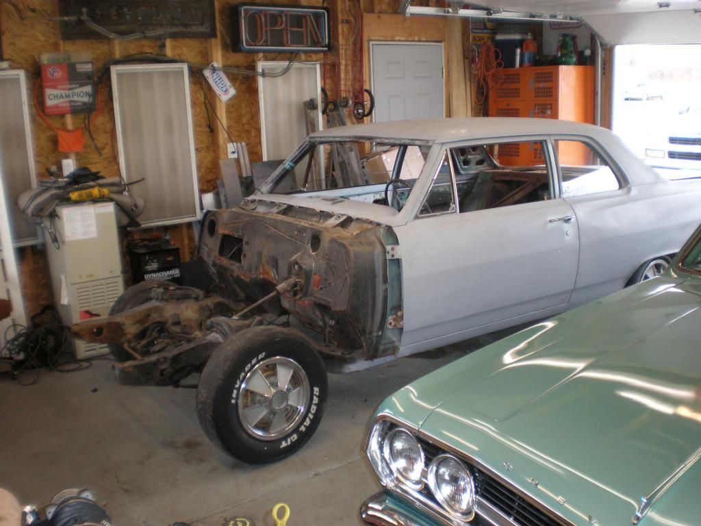

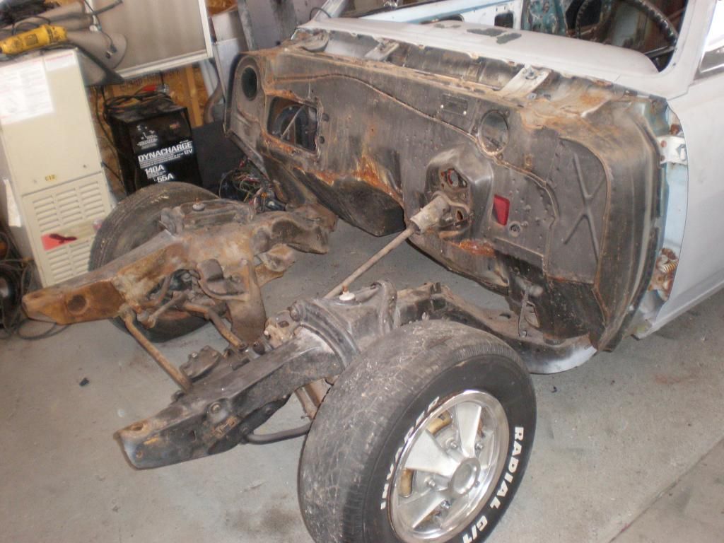

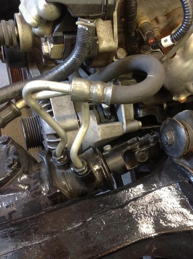

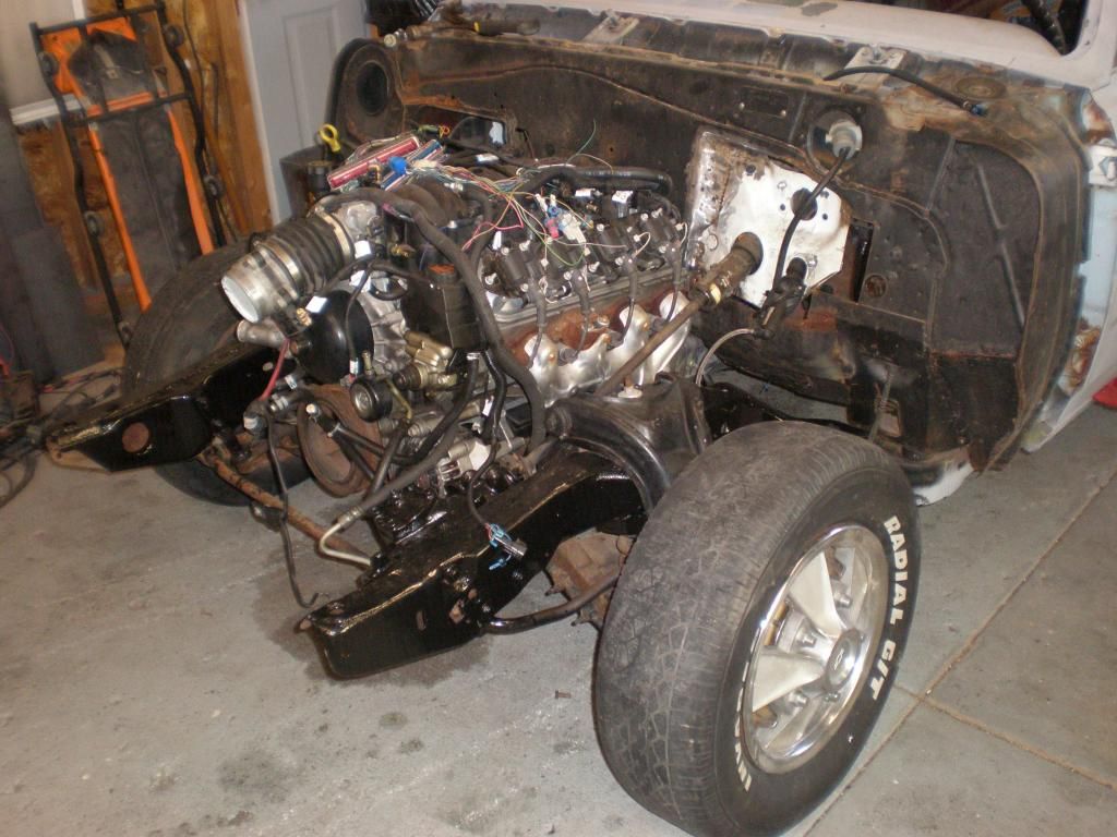

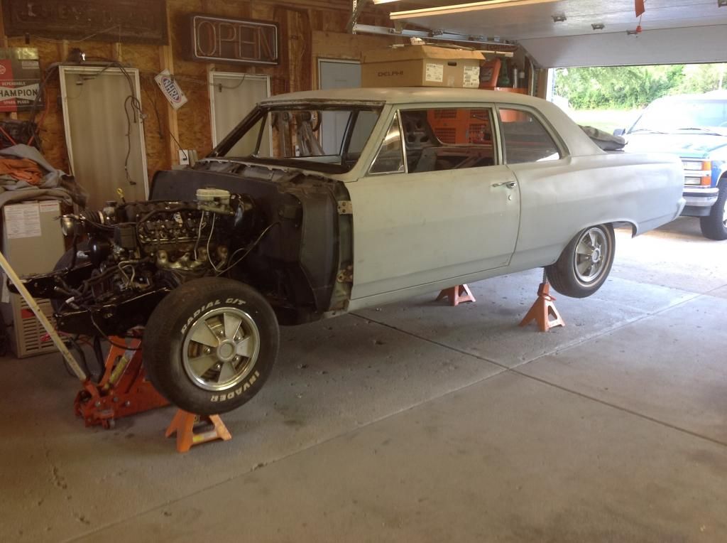

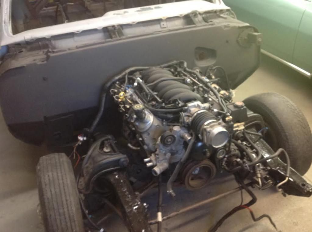

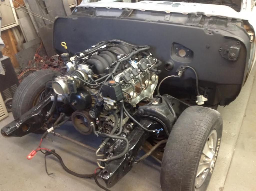

chris_65 09-09-2014 07:07 AM
Let the build begin!
http://i1276.photobucket.com/albums/...pse80c402b.jpg
http://i1276.photobucket.com/albums/...psfddfdb90.jpg

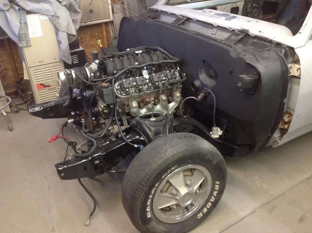

The LS is waiting to go in!
http://i1276.photobucket.com/albums/...ps1c13c05b.jpg

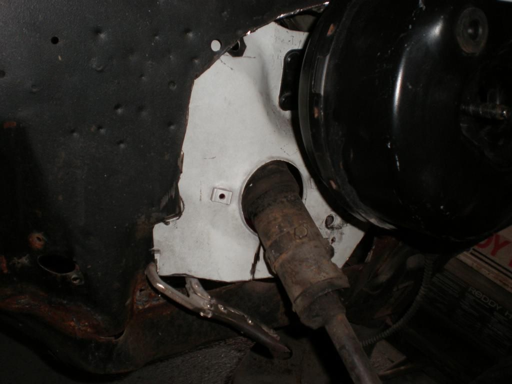

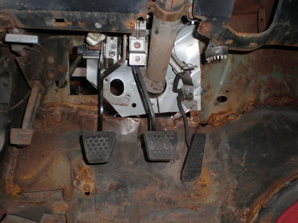

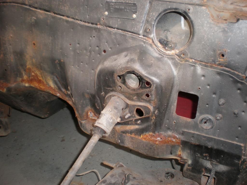

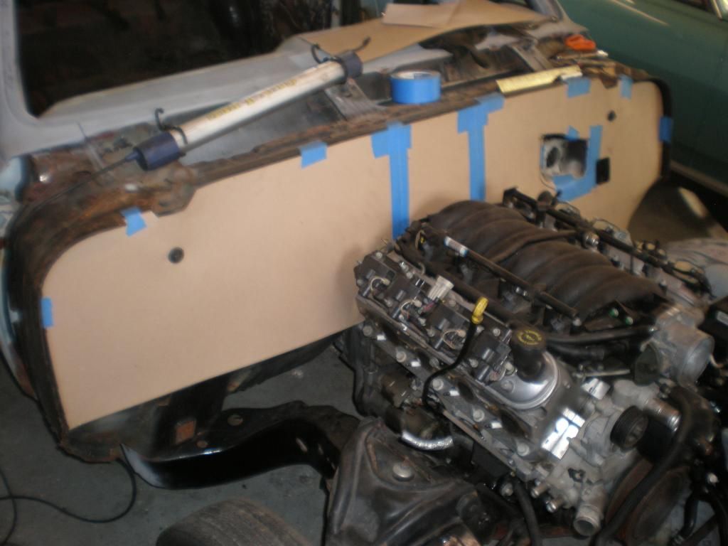

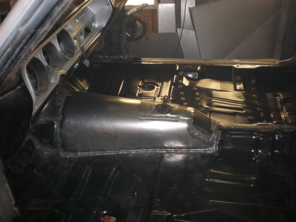

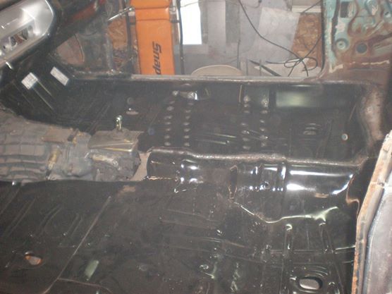

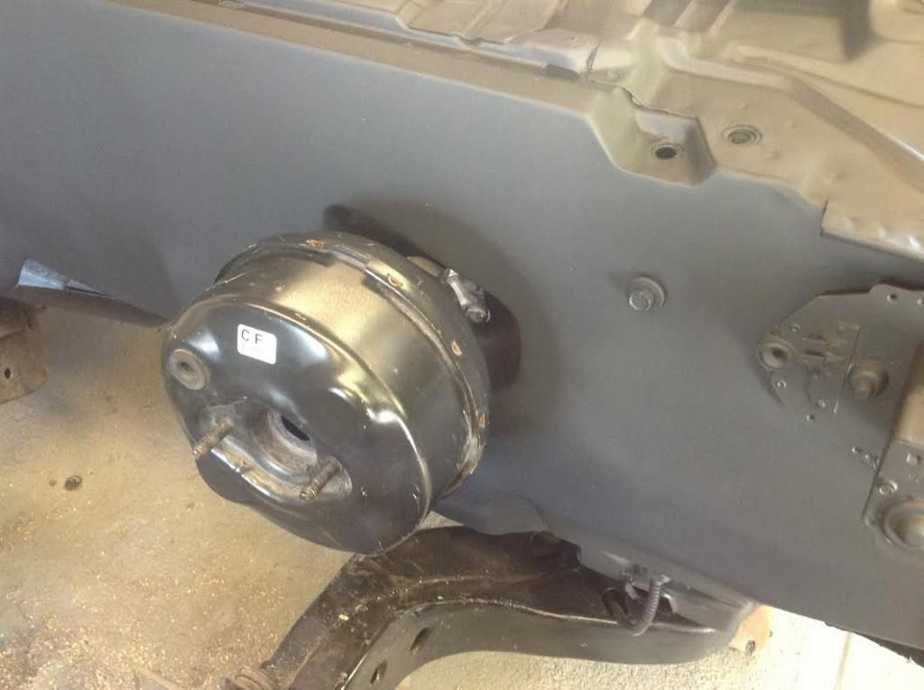

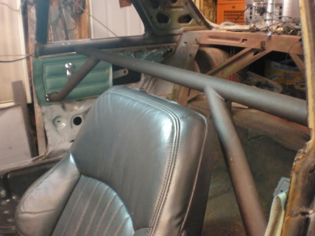

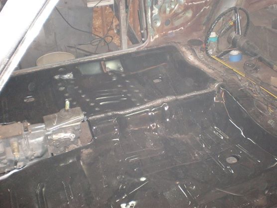

chris_65 09-09-2014 07:16 AM

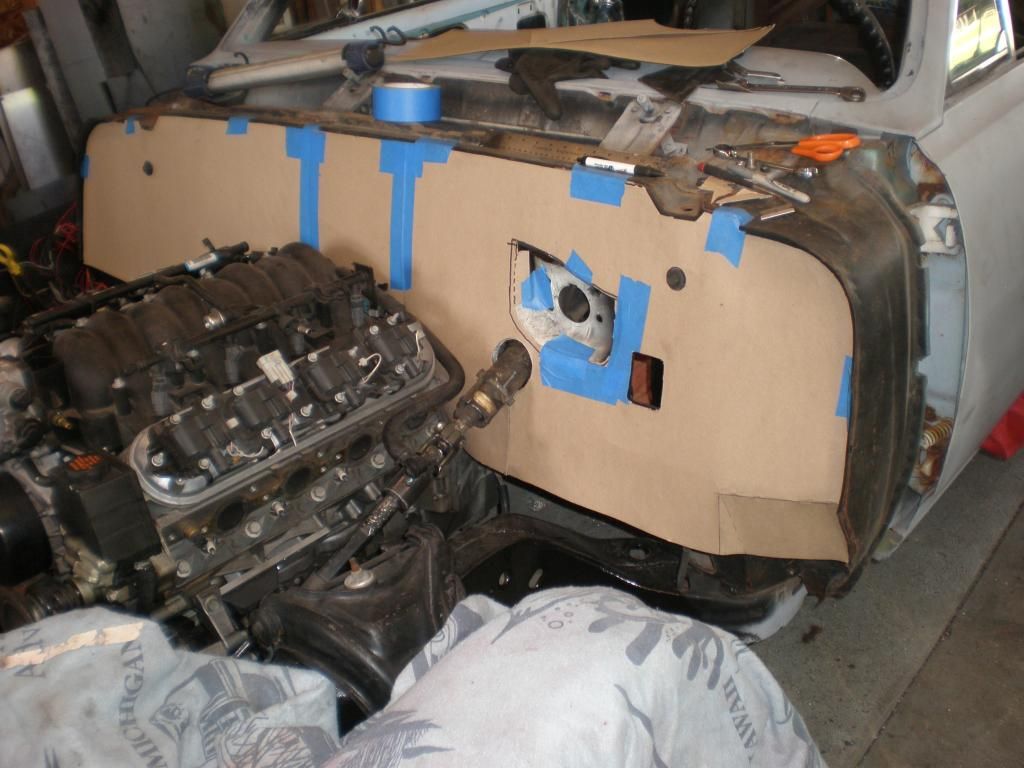

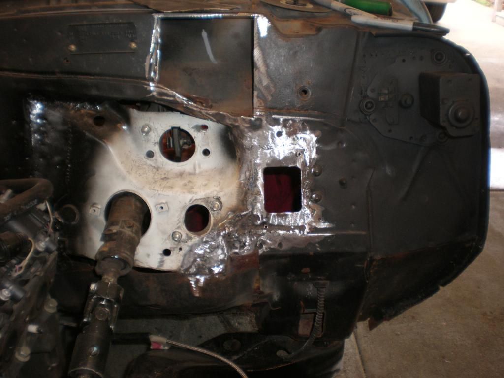

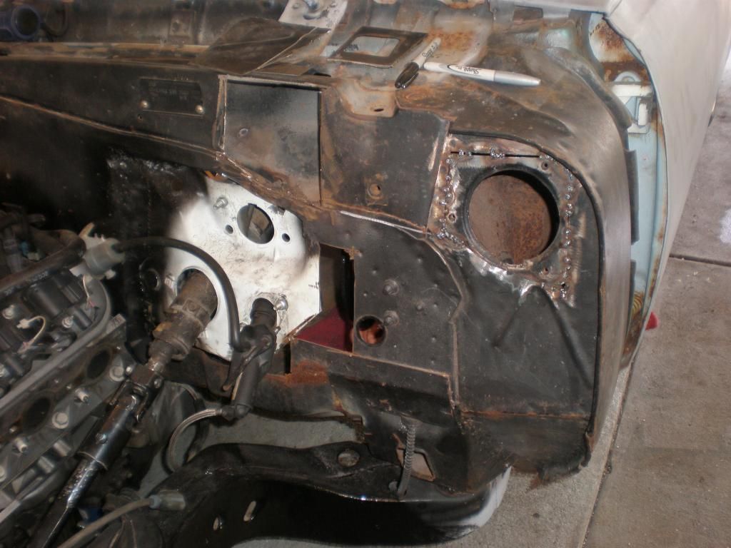

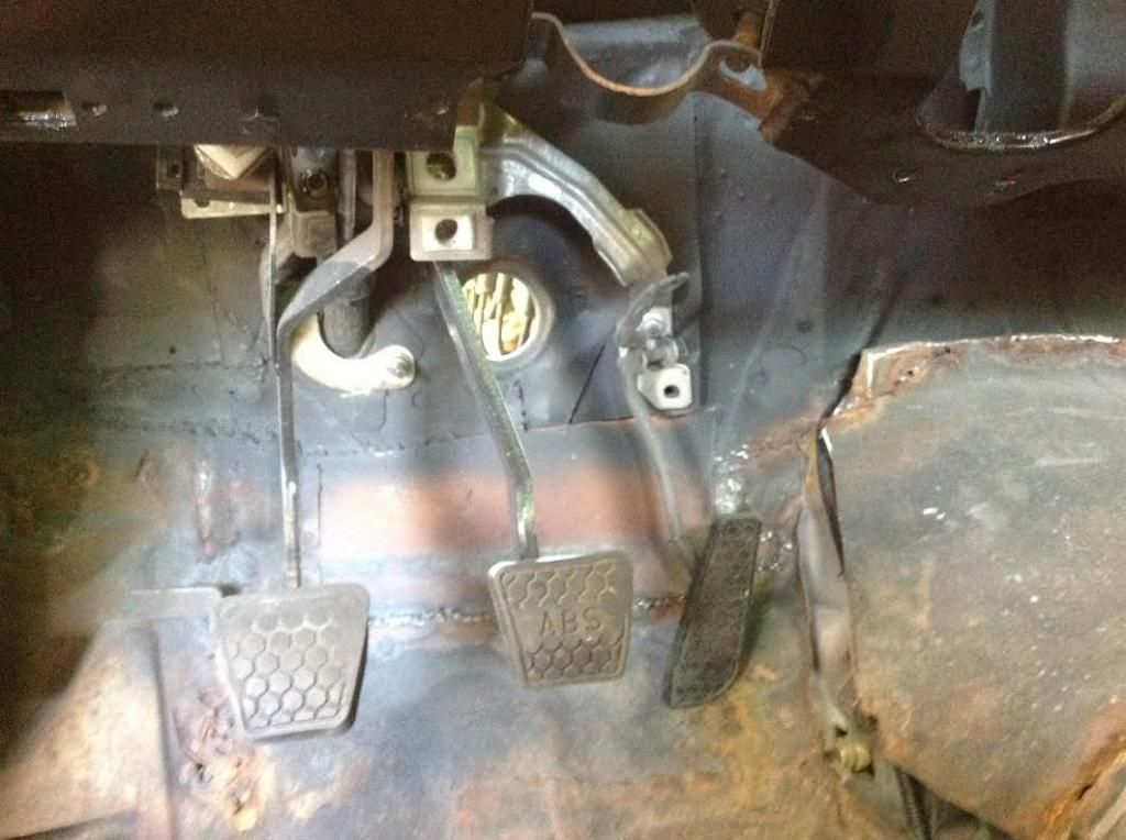

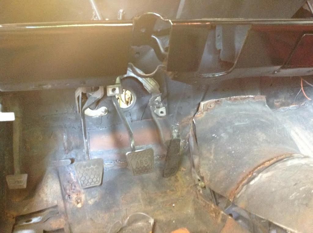

Mocking up the section of the TA firewall that the clutch, brake and gas pedal assembly bolts to. This will also allow me to use the TA's brake and clutch MC.
http://i1276.photobucket.com/albums/...psb1253e12.jpg
http://i1276.photobucket.com/albums/...psafda774f.jpg
http://i1276.photobucket.com/albums/...psef2c060d.jpg
This will also allow me to use the TA's pedal assembly as well.
http://i1276.photobucket.com/albums/...ps870d4ff6.jpg

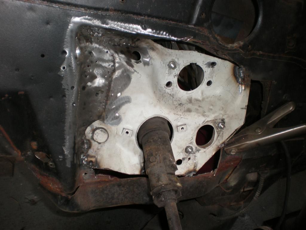

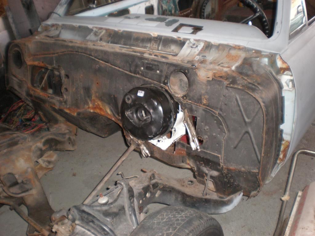

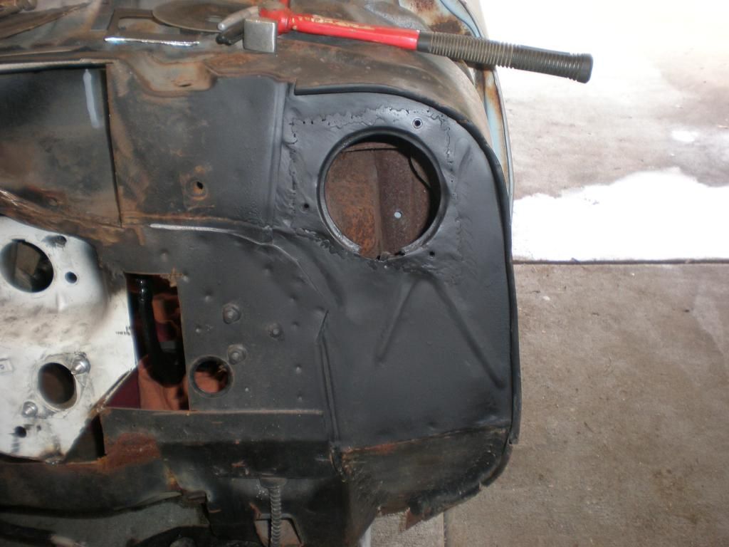

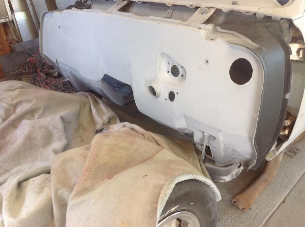

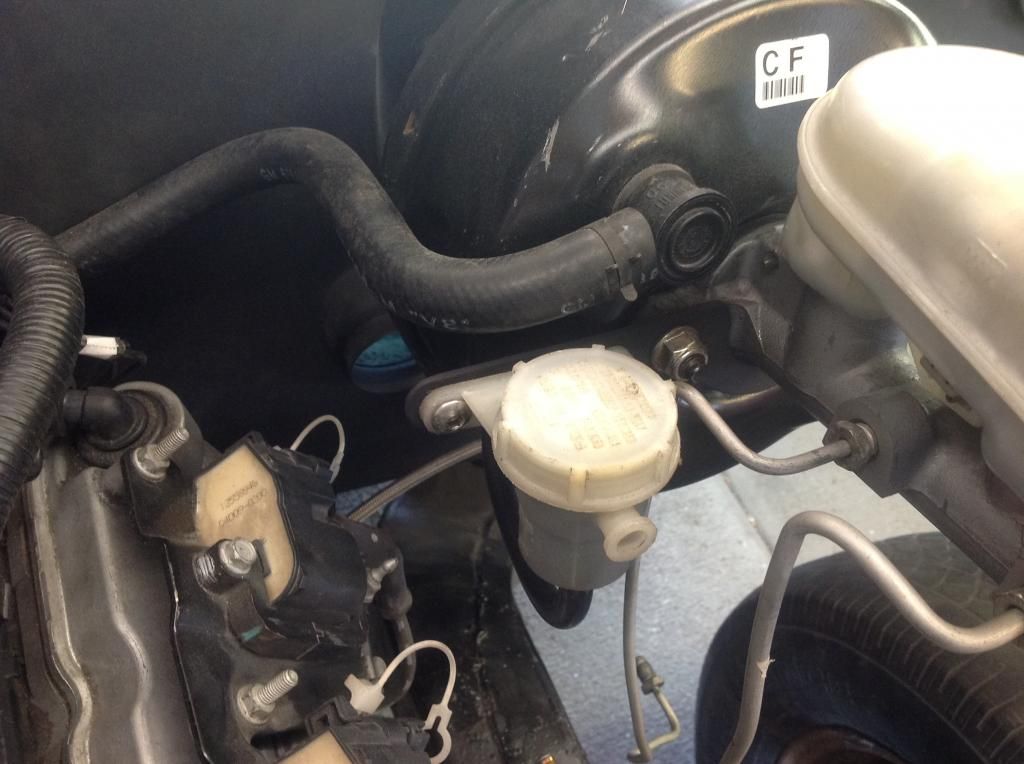

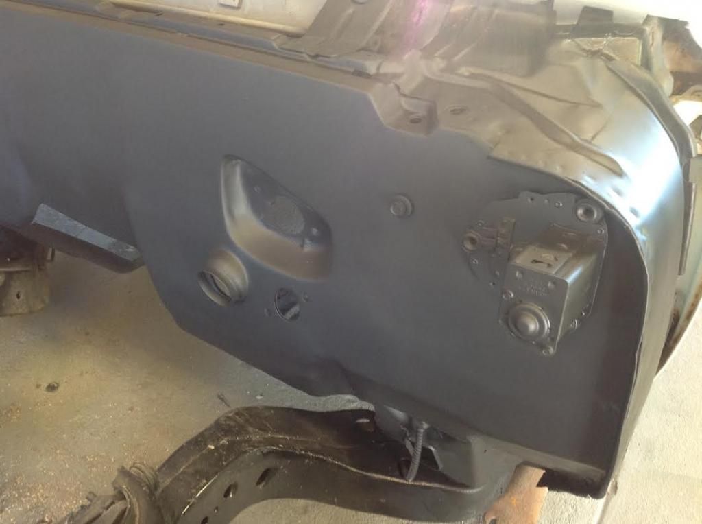

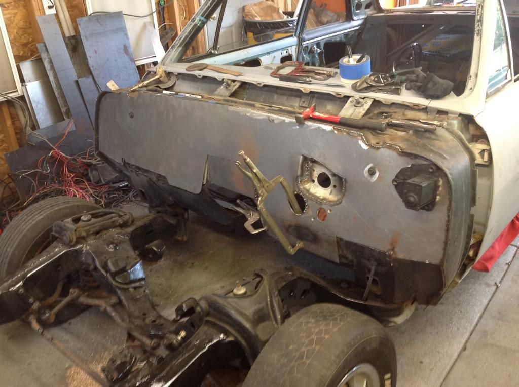

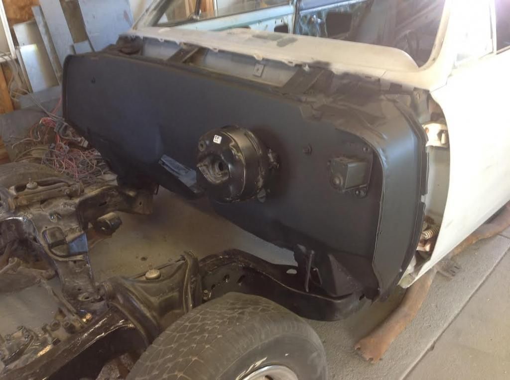

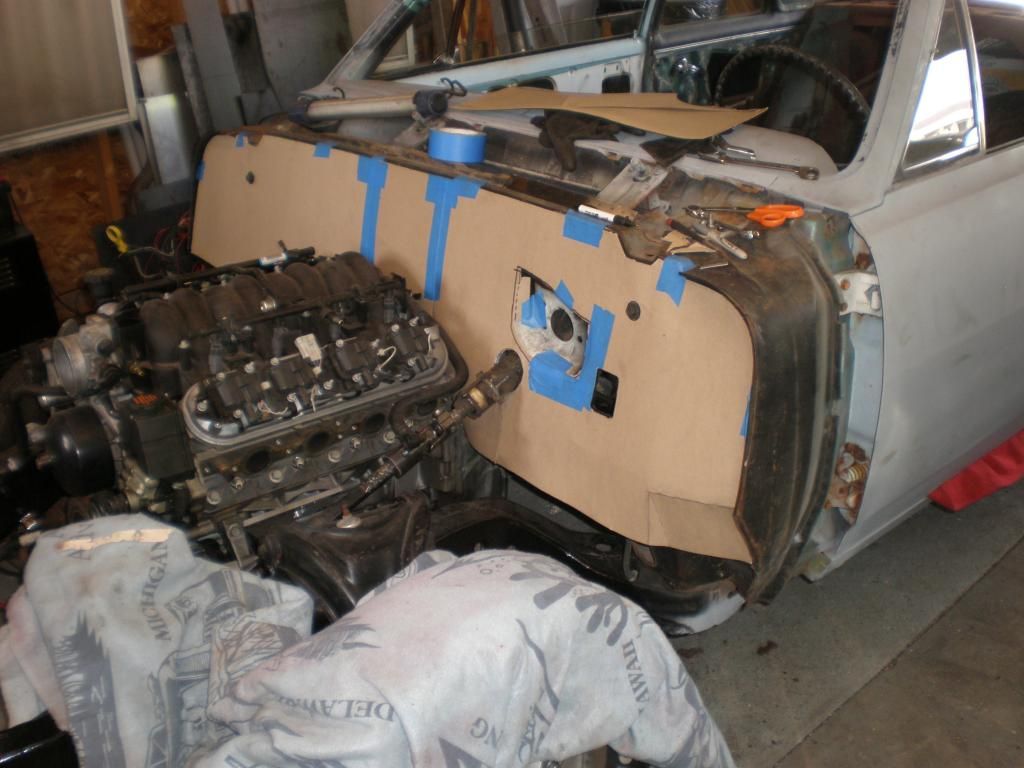

chris_65 09-09-2014 07:19 AM

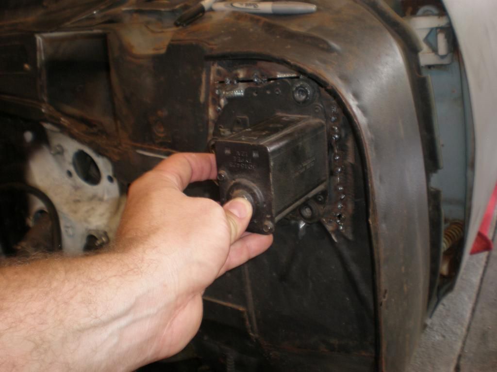

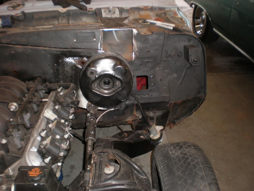

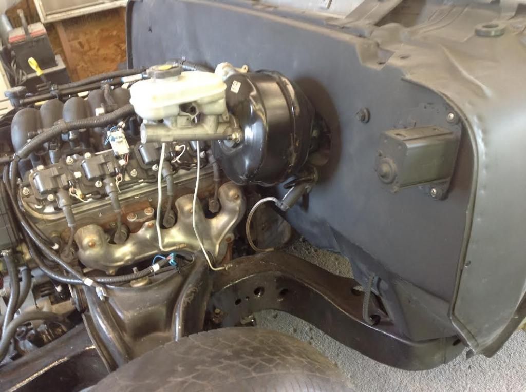

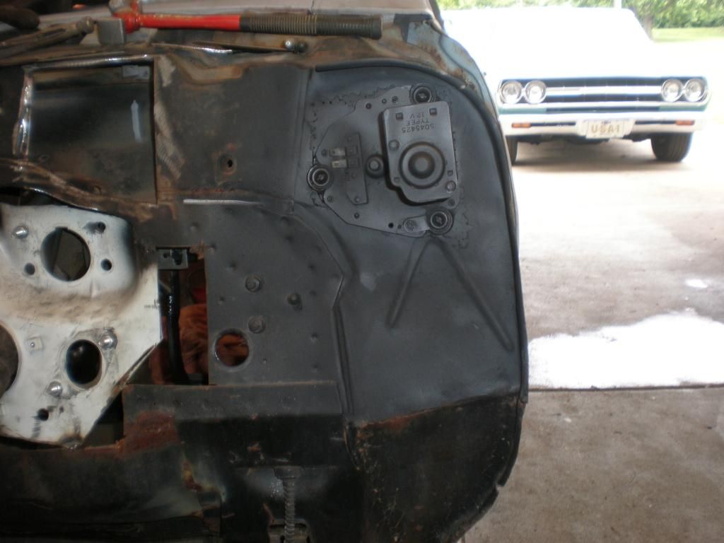

The firewall section in place. I also noticed that I will have to relocate the wiper motor, it comes in contact with brake booster. I was going to smooth the firewall anyway,so I'll tackle that later...
http://i1276.photobucket.com/albums/...ps32ee5ac4.jpg

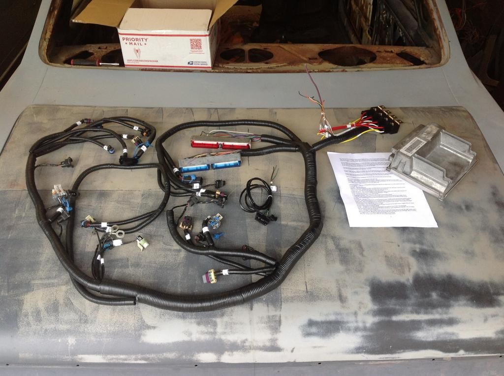

chris_65 09-09-2014 07:23 AM

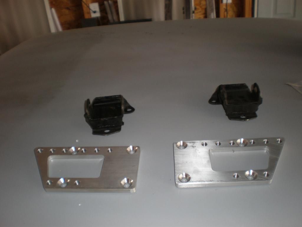

I finally got the engine plates!
http://i1276.photobucket.com/albums/...ps59f7f9e0.jpg
