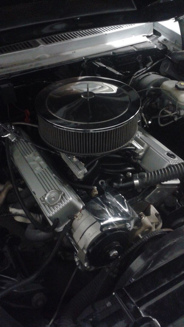

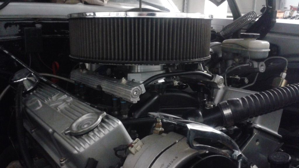

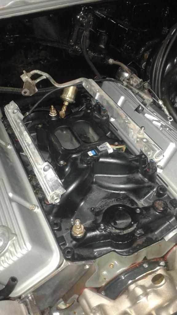

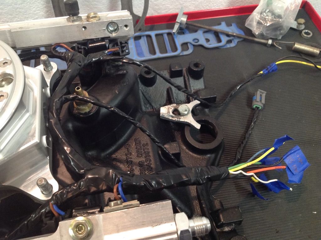

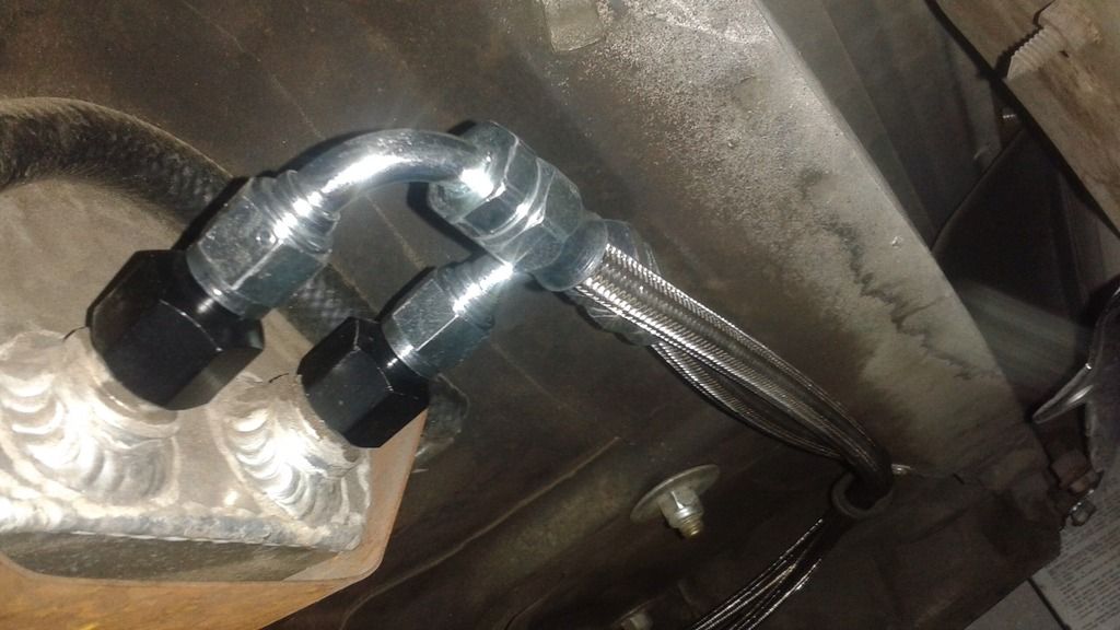

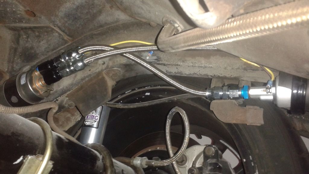

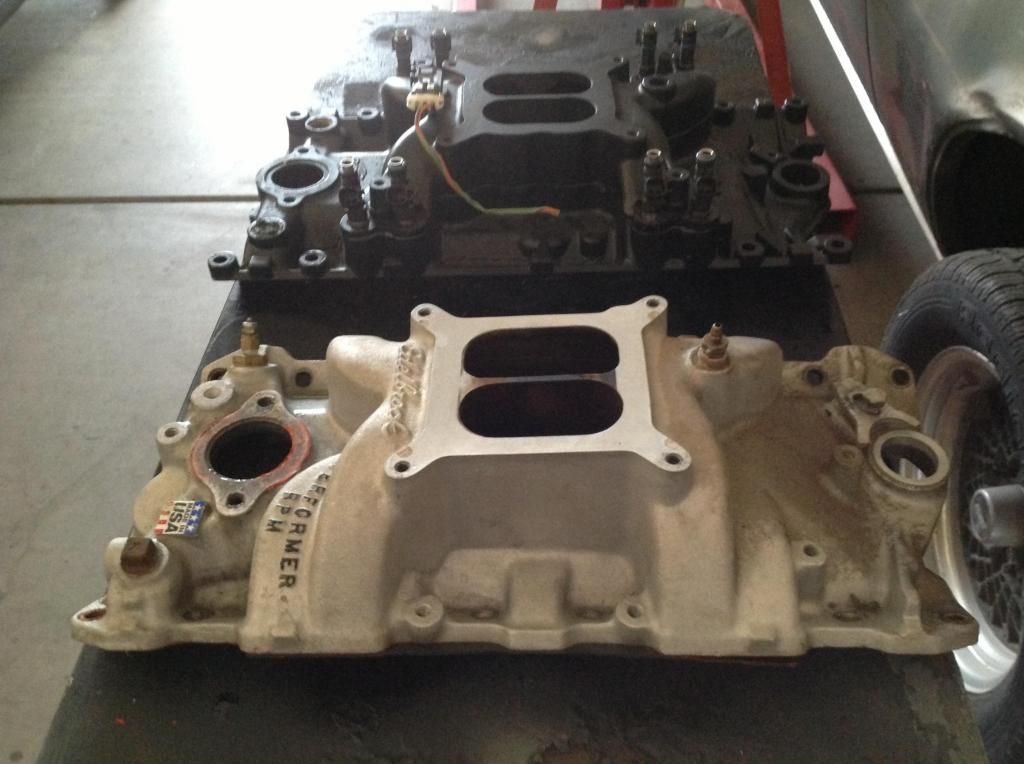

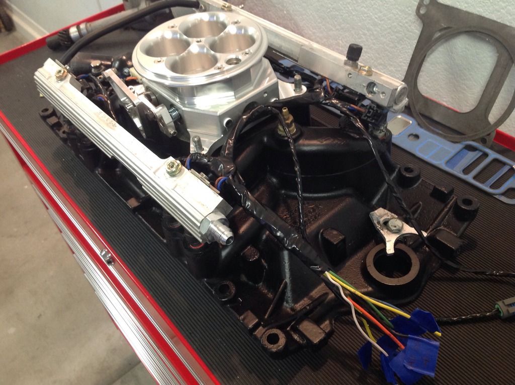

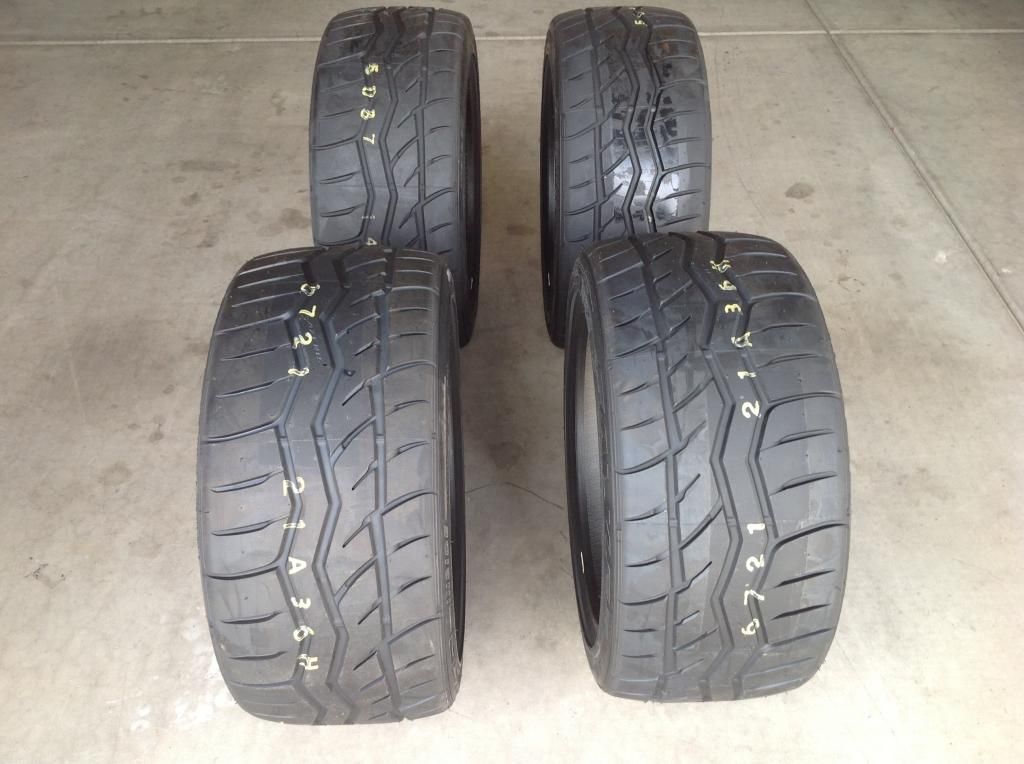

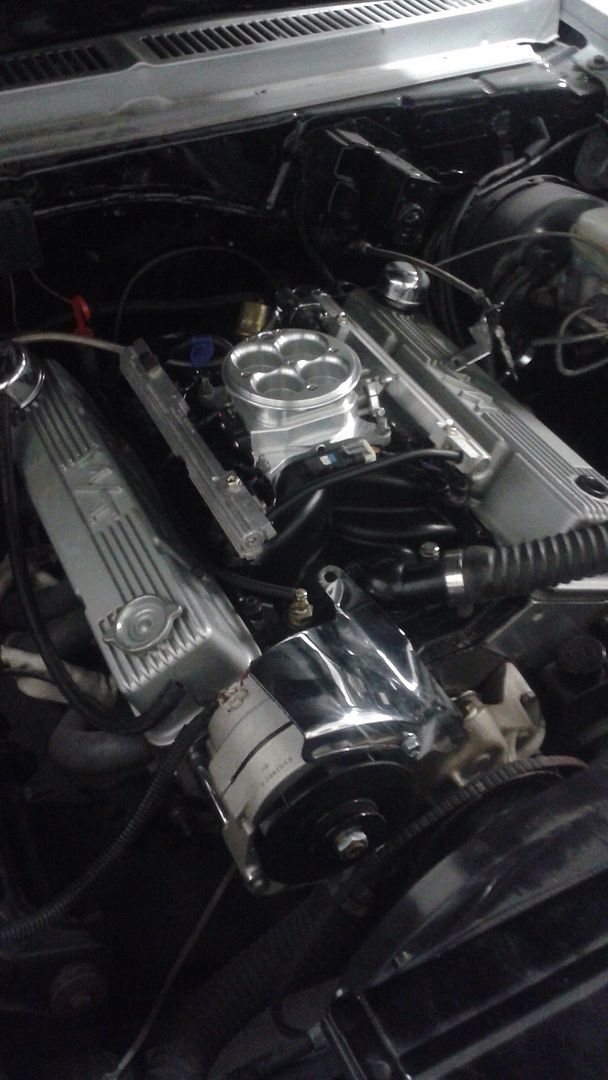

After doing some Goodguys and SCCA autocrossing this past year (I got hooked) I've decided it was time to make some upgrades to the Nova so I could be a little more competitive.
Upgrades planned so far are...

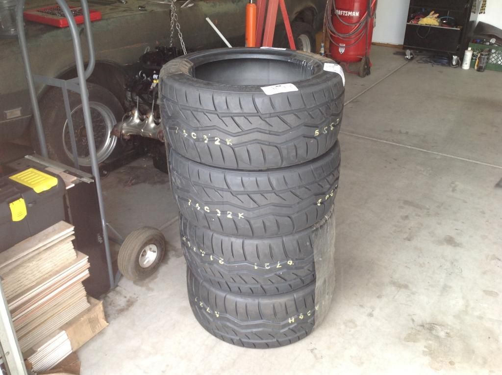

-new tires; Falken Azenis 245/45 R17 and 255/40 R17

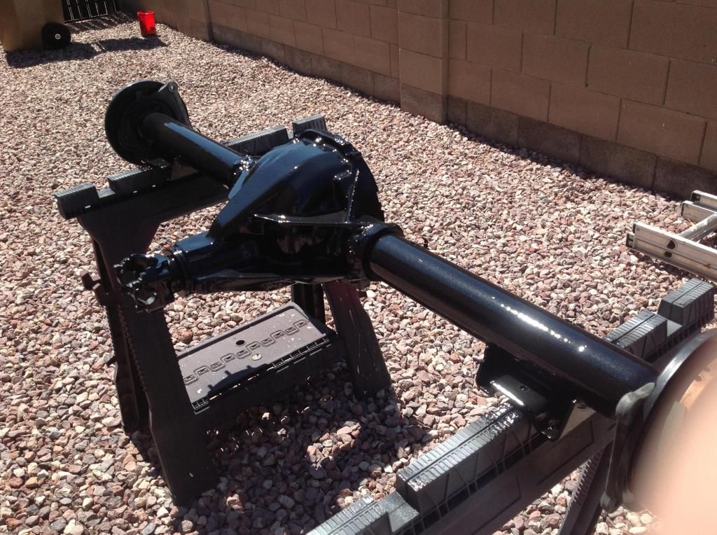

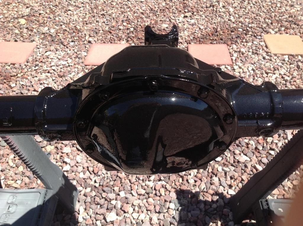

-upgrade factory 10-bolt differential; 3.73 gears, Moser 30 spline axles and Detroit Trutrac
-CPP "totally tubular" upper and lower control arms
-Viking double adjustable coil overs and rear shocks
-CPP AFX C5 spindles and hubs
-13"rotor upgrade to my existing 4th gen Camaro front disc brakes

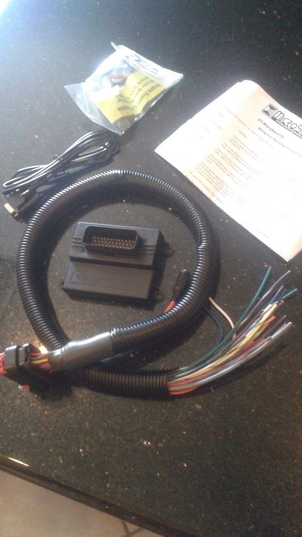

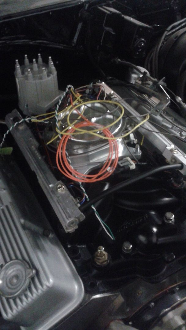

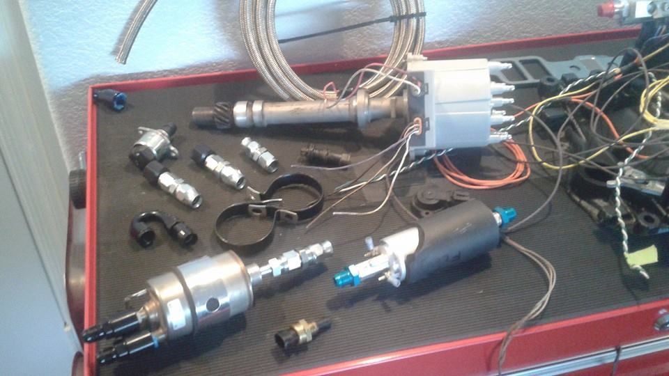

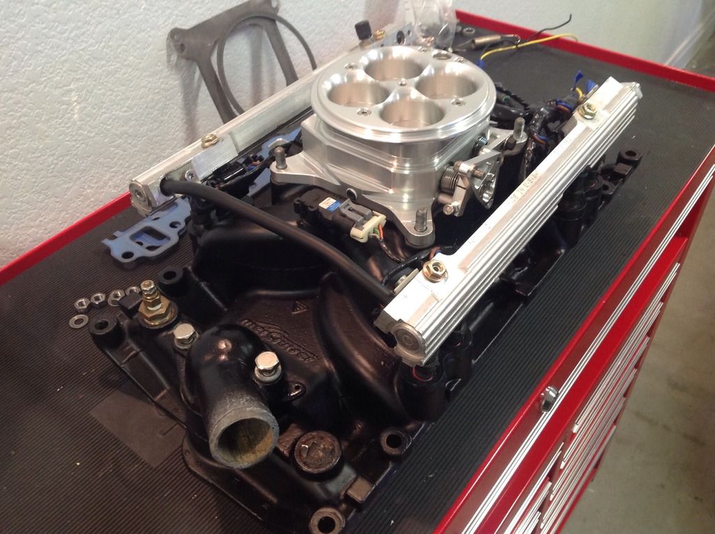

-FAST EZ EFI 2.0 fuel injection

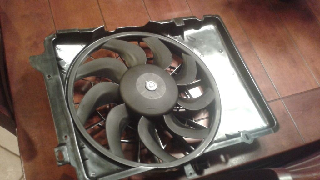

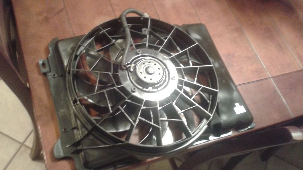

Here's some pics f what's done so far, let me know what you think....
http://i270.photobucket.com/albums/j...Picture022.jpg
http://i270.photobucket.com/albums/j...psaa1f2d19.jpg
http://i270.photobucket.com/albums/j...psbc5f033b.jpg
http://i270.photobucket.com/albums/j...ps3f8b4dad.jpg
http://i270.photobucket.com/albums/j...ps10a72d06.jpg
photobucket.com/albums/jj98/7dtwoo/imagejpg6_zps3f8b4dad.jpg[/IMG][/URL]
http://i270.photobucket.com/albums/j...ps8c1980b8.jpg[/URL]

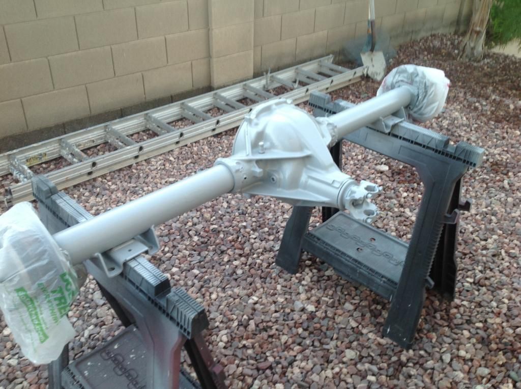

70TWO NOVA 09-21-2014 09:05 PM

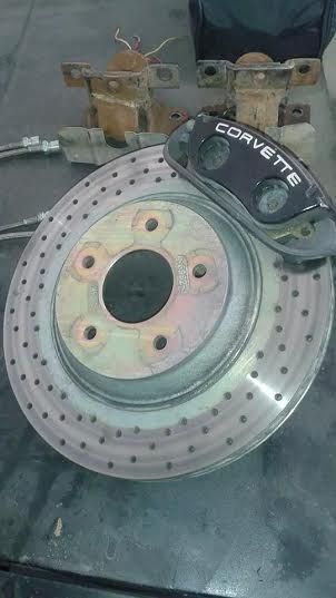

I finally got the rear end back under the car. I have yet to get it out and drive it, but I'm hoping its a decent difference considering I'm going from an open diff 3.08 gear to a trutrac with 3.73s. Also, I just picked up a set of front 13" C4 Grand Sport brakes. I have been told the calipers/pad size is not as good as the current 4th gen Camaro stuff I have on the car, but I'm hoping the 1" larger diameter rotors will still give me some increase in braking ability (not to mention they are thicker and cross drilled)
