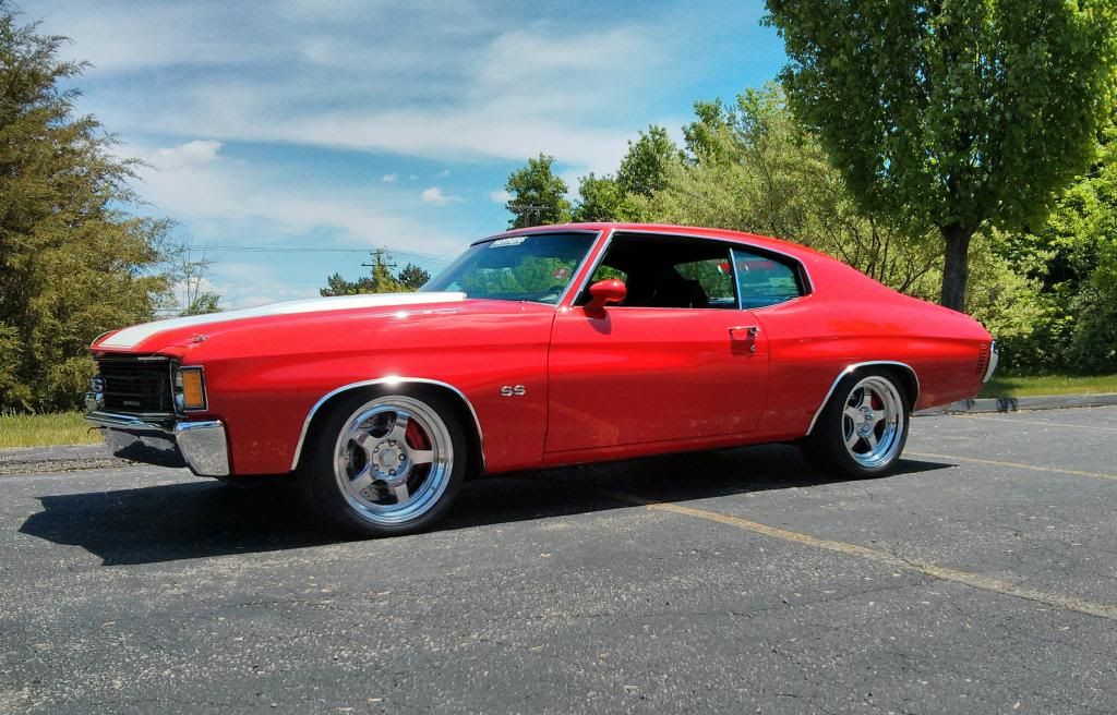

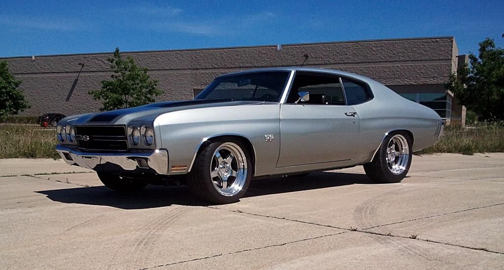

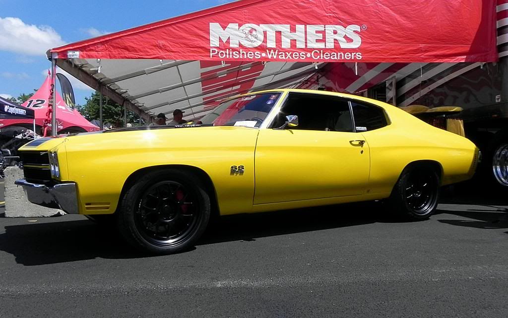

Formula43 Wheel 10-13-2014 09:02 AM
Kore, Wilwood and Baer all have great kits in a wide range of options. Kore 3 kits are great bang for the buck and using OE parts, which in most cases you'll be able to get pads, rotors and bearings easily at you local parts store.
Wheel fitment options will depend on budget. Custom 3-piece, we've been building a 9.5X18/19 front and 10.5X18/19 rear for no body work modifications. Personally I prefer a 19" rear as the wheel well is huge and a taller tire around the 27" diameter mark.
Here's a few pics. Good Luck!
http://i1216.photobucket.com/albums/...ps5c0d69b5.jpg
http://i1216.photobucket.com/albums/...ps715a2ea4.jpg
http://i1216.photobucket.com/albums/...ps61c8d423.jpg
