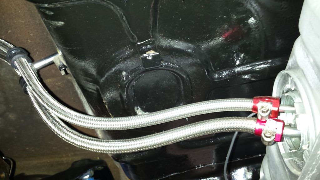

New fuel tank, sending unit and straps courtesy of Original Parts Group, Earl's lines and fittings (-6 feed) via the Summit store...that is only an hour from where the car is kept. ;)
http://img.photobucket.com/albums/v6...ps012ad359.jpg
Since this car was a factory original A/C car, it came with a fuel return setup that we decided to keep in place.

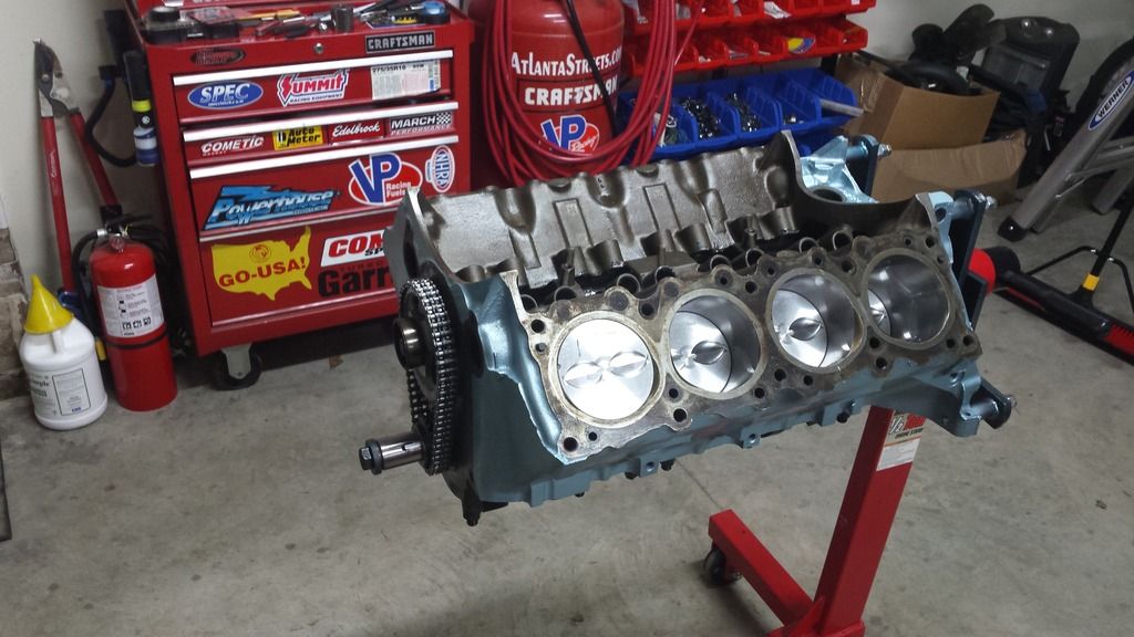

As for the engine/trans, it was originally an automatic and I plan to keep it that way since this is going to be a car that my dad will be driving more often than I do. We're keeping it Pontiac powered, and will likely back it up with a 700R4 trans. I have a cherry 400 block from a '73 Le Mans in addition to the original 326 and 2 speed auto that came with the car, and for now the plan is to build the 400 with forged pistons/rods and a roller cam. Still undecided on heads at this time. However, I will be putting nitrous (100-150 shot) to it, mostly just for kicks. I have no intentions of making the track a regular venue for this car. Just a fun street rod that can light up the tires if desired, but mostly aiming for driveability and reliability.

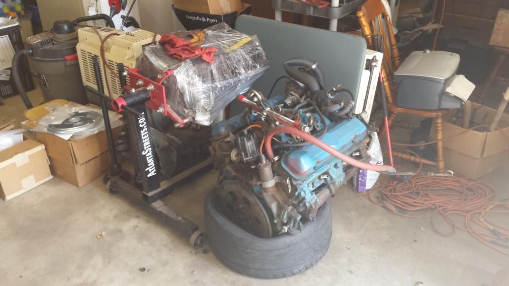

The garage was a bit of a mess in this picture, so excuse me for that haha. Here's the 400 block fresh from the machine shop after being magnafluxed and hot tanked, the 326 is on the tire.
