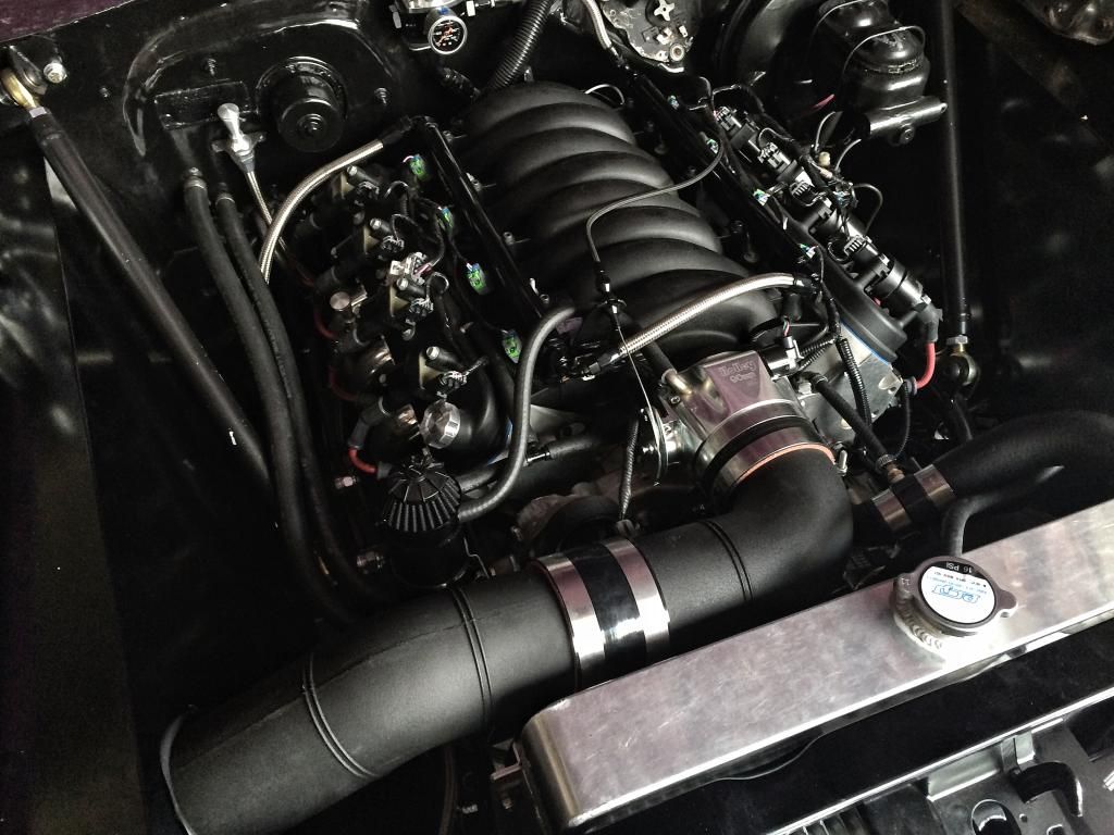

Radiator support installed with other items. Short Ram air intake mock up.
http://i1372.photobucket.com/albums/...pse92b1606.jpg
Short ram air intake painted and along with inner fenders installed.
http://i1372.photobucket.com/albums/...ps6c958814.jpg
Car is now pretty much complete and ready for the dyno. I decided to do a cold air intake instead of a short ram to reduce the engine sucking in hot air from the bay.

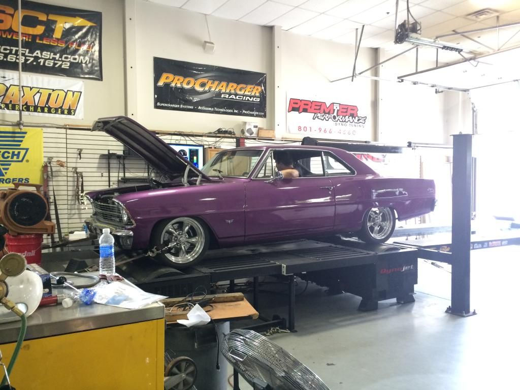

Now the REAL fun begins.
http://i1372.photobucket.com/albums/...pswrs9eaak.jpg
Video of the dyno run: http://youtu.be/ljKt3orNSRI

Did you buy a kit for the cold air intake or did you make that one?
ModernDay67SS 10-07-2014 07:39 PM
Originally Posted by Valve Lash (Post 573046)
Looks like a fun project dude. Nice upgrades, can't wait to see more.
It's the Airaid U-built-it kit. I bought the basic kit and then bought my own t bolt clamps and couplers. I love how it turned out.
