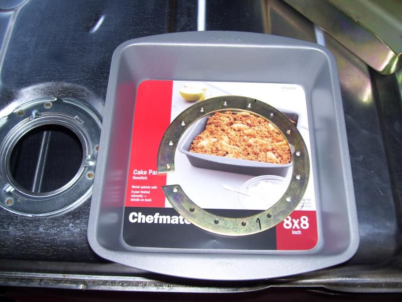

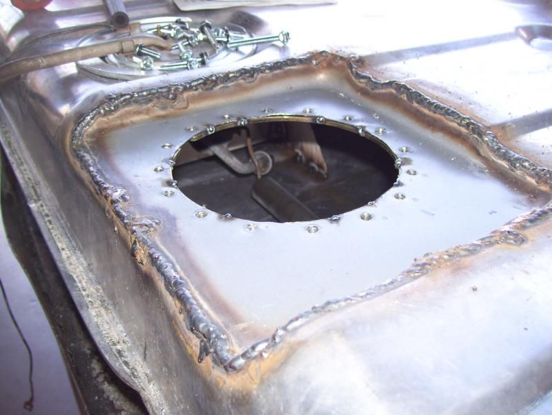

My plan was to recess the pump into the tank so the pump fittings would not hit the trunk floor. I ran into issues. The stock tank on a 71 Camaro is 6" deep. The electric pump is like 5 1/4" long. It will work, but I need to recess the pump module into the tank 1" to keep the fitting from hitting the floor. The best I could do is recess the pump 5/8".
So I used a brownie pan to start with. It felt like it was a good thick pan about equal to the thickness of the stock tank.
http://i173.photobucket.com/albums/w...psa7f127a8.jpg

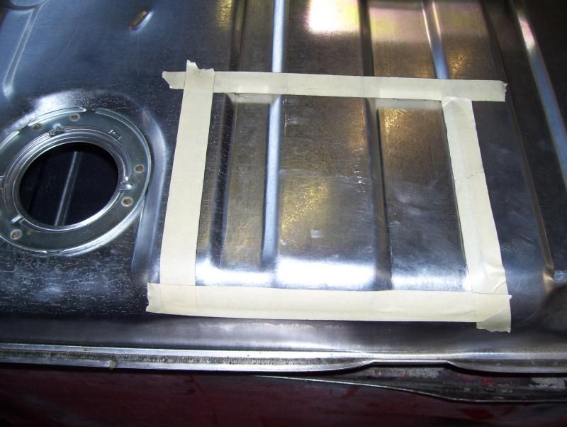

I decided to set the pump in the center of the tank toward the front which is the deepest part of the tank
http://i173.photobucket.com/albums/w...ps7d2868b0.jpg

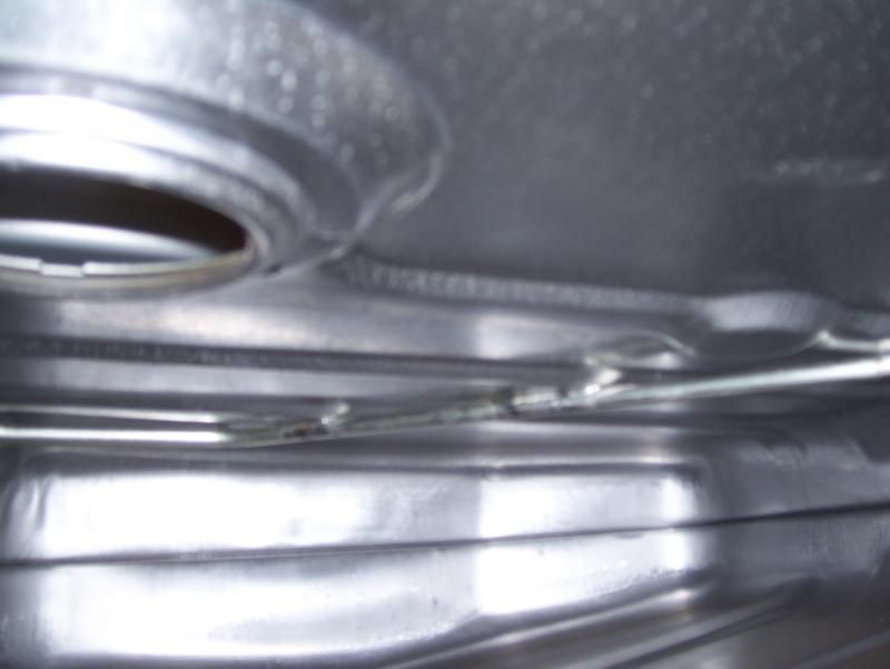

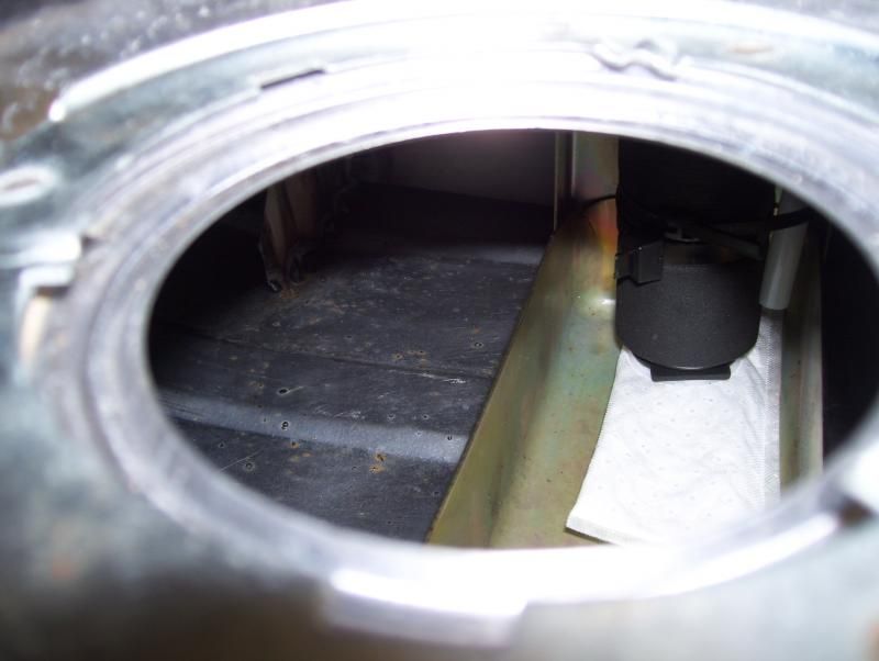

I tool some pictures inside the tank of the eec system in the stock tank. The small nipples on the tank look like this.
http://i173.photobucket.com/albums/w...ps40043080.jpg
The large nipple goes all the way to the filler neck
http://i173.photobucket.com/albums/w...ps1e01dba7.jpg

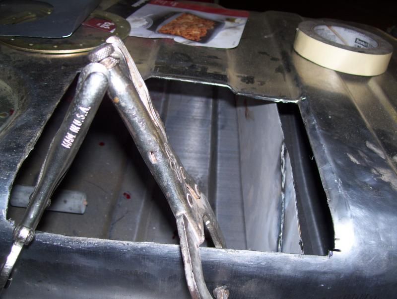

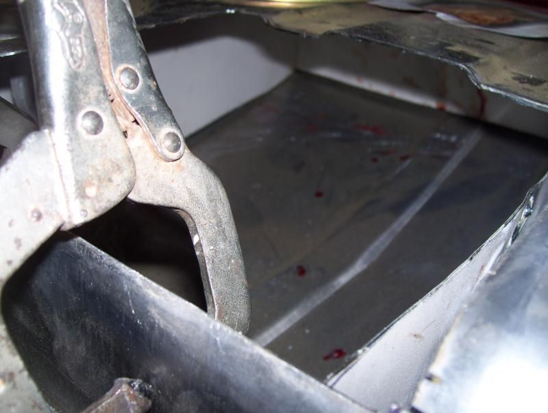

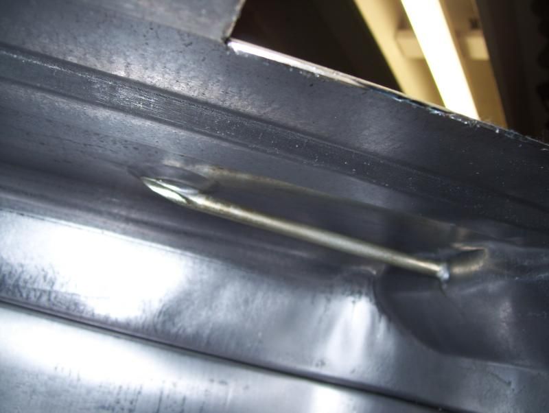

I added baffling to the inside of the tank. The baffles are 13" wide, and go all the way front to rear inside the tank, and top to bottom. It is a big rectangle that I welded inside the tank
yep I cut myself
http://i173.photobucket.com/albums/w...psf714ad6e.jpg
http://i173.photobucket.com/albums/w...ps4facc34d.jpg
http://i173.photobucket.com/albums/w...ps5a873581.jpg
http://i173.photobucket.com/albums/w...psc705716c.jpg

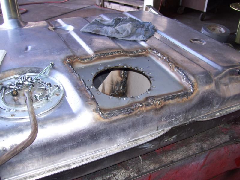

dale68z 10-08-2014 10:20 PM
pan is cut and welded in, can see the baffling
http://i173.photobucket.com/albums/w...ps7cf54357.jpg
http://i173.photobucket.com/albums/w...psbcb8dc70.jpg
http://i173.photobucket.com/albums/w...ps181688b7.jpg
http://i173.photobucket.com/albums/w...ps1a033b2a.jpg
The end result is the fittings are still to tall. I could re work the fittings. But decided to shim the tank lower with 4- pieces of 1/2" square tubing. The stock straps still worked.

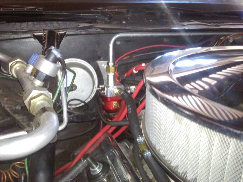

I run a carb, but the only thing that matters is the pressure regulator. I am running a low pressure Fuel Lab regulator. If I had fuel injection I could have gotten away with using the stock 5/16 return line
http://fuelab.com/products/performan...ure_regulator/
Initially I was returning the fuel through the stock vapor line on the left side of the car. I could not get my fuel pressure below 13#. I had to replace the 5/16 with 3/8. As soon as I replaced the line my pressure dropped to 3#, and I was able to adjust the pressure to 6 1/4.

The only concern from here is I used a duct to make my baffles in the tank. The metal duct was coated. I did set some fuel, and even carb cleaner on the coating, it did not make it soft. But, I don't know how it will do, long term, submerged in fuel.
Build-It-Break-it 10-08-2014 10:26 PM
I think you might have issues later with the way you welded it in. The Tanks Inc fuel pumps are made to be a basic install without the welding and usually include an internal baffle . I think your tank might end up rusting inside and some of the weld slag at the bottom of the tank that isn't removed will become loose over time along with some of your mig welds. If anything it should of been tig welded in.
dale68z 10-08-2014 10:40 PM
Could be. Rust was a concern for me. I also thought I should coat the interior with airplane fuel tank sealer. The car doesn't sit much. I drive it to work about 30% of the time. The other days I drive the 68. And, I live in Arizona.
I don't have a tig welder. I did contemplate brazing instead of mig.
Only time will tell
I need to pull the tank. in this car it is super easy. The fuel gauge remains on full far to long, so some adjustments to the float are needed. I can then check for debris in the tank. I did rinse the tank multiple times in different stages and beat/ scratched on the welds to loosen crap up.
