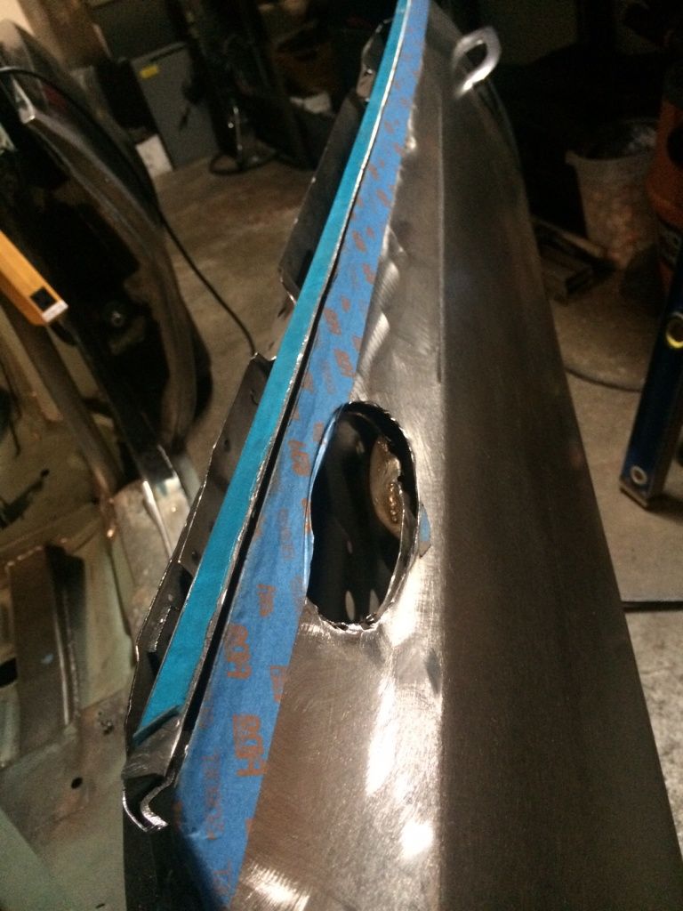

frankv11 10-26-2014 10:05 PM
Just got around to installing weather stripping , panels fit and look great. No need to bend brackets turns out to be my repop door outer top edge was off on front end by 3/4" ( not much :) !!!! ) no fun on trying to keep that top edge on check as it curves twice while trying to keep top flat and even. This is one of the reasons why it will get completely built before any paint.
