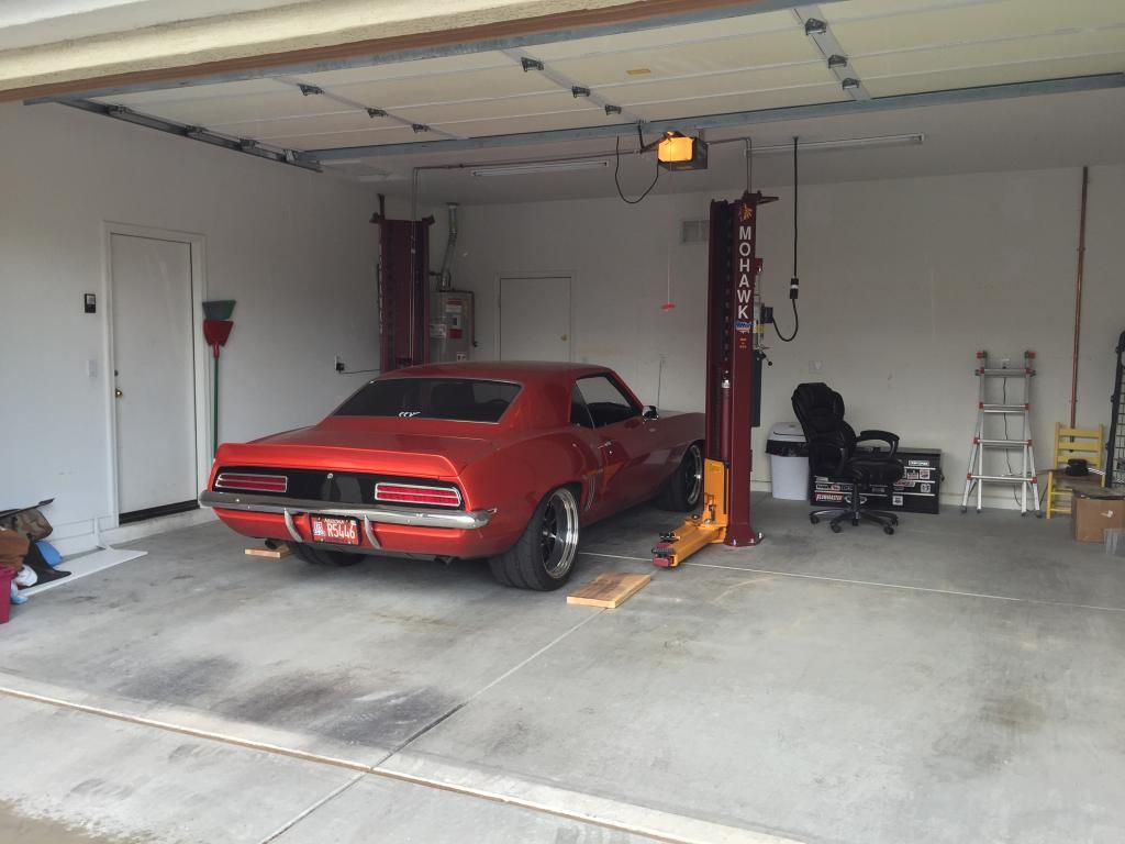

I'd suggest an American made two post asymetrical. Here's a pic of the Mohawk A-7 I just had installed in my garage. You can clearly see the electrical hookup. Its 220.
http://i29.photobucket.com/albums/c2...s/IMG_0637.jpg
