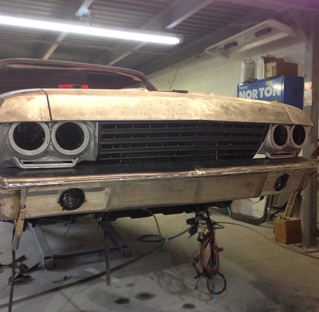

Hello everyone! Im currently working at Ross' Rods out of Fairfax Va and wanted to share with y'all some of the builds we have going on. A quick run down of the car is it has a warmed over 350 (until we go LS3 or bigger) Ridetech suspension with Accuair, JW speaker headlights, Billet Specialties wheels and a ton of body mods.
This was a quick rendering done by my buddy and coworker Eric Steele. We're currently working with some one on an actual rendering and will post it as soon as we get it
Attachment 51381

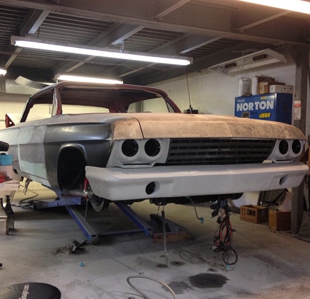

Heres some of Erics work
Attachment 51382
Attachment 51383
Attachment 51384

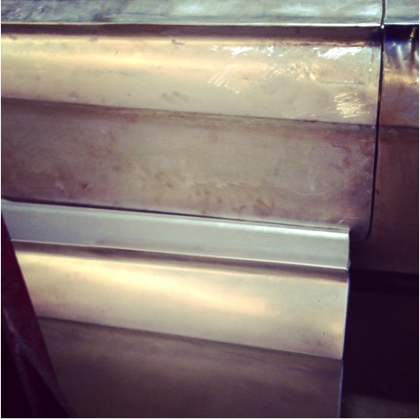

Currently I'm replacing the door skins and quarters due to the work that was done previously.
Shaved the door handles before they're installed
Attachment 51385

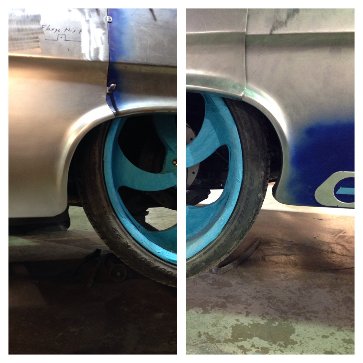

Re arched the front of the quarters to clear the wheels but brought the factory body line further down to look factory. Here's a side by side comparison of before and after
Attachment 51386

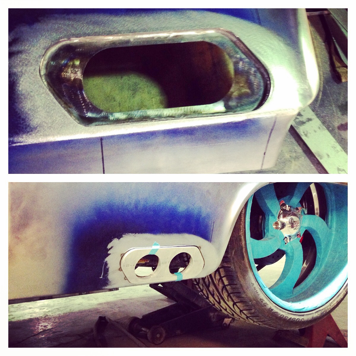

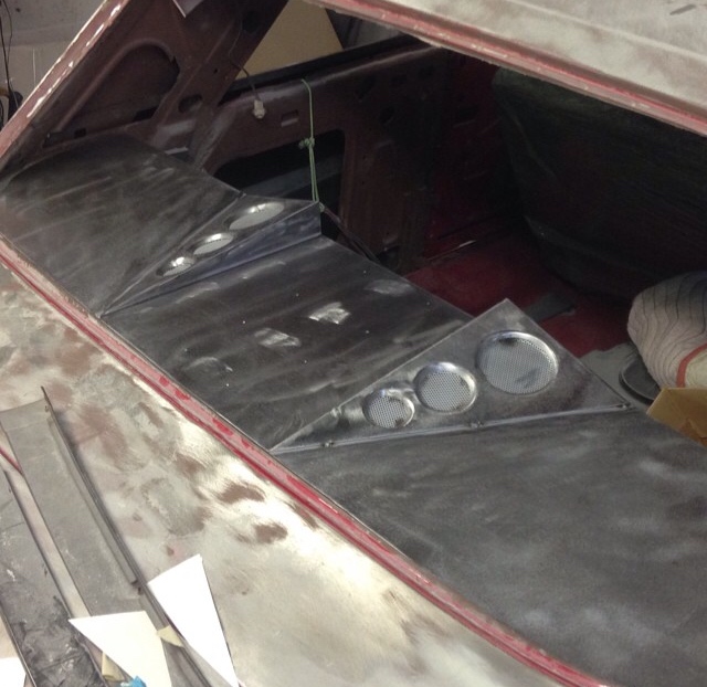

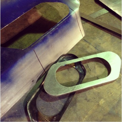

Next up was getting the exhaust bezel housing made up and welded in
Attachment 51388
Attachment 51387
The bezel has changed and ill get a pic of it later in the week once i cut it on my plasma table and countersink all the mounting holes
