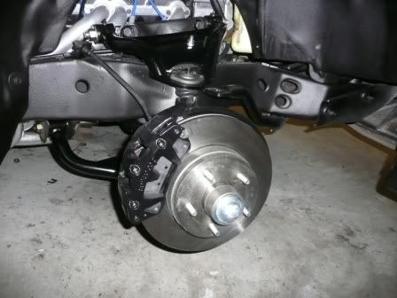

badazz81z28 11-27-2014 09:04 AM
Mark,
If youre interested, I'm going to be picking my 78 Camaro apart here Mid December. It has a complete Hotchkis Suspension and has about a couple thousand miles on it.
Hotchkis Upper and lower control arms, Hotchkis tuned Bilstein shocks.
I also have the Hotchkis Sway bars.
Like to set you up if youre interested. I can work with your budget.

badazz81z28 11-27-2014 11:13 PM
2 Attachment(s)
Originally Posted by markss28 (Post 583281)
(DSE) $1400 for control arms so my budget is pretty shot there. (BMR) I was told I may want to wait until they revise the arms as there was not much change from stock other than being lighter and tubular. (Hotchkis) real nice but pretty expensive as well. (Speedtech and GW) is more what I'm leaning to and the price is right but I like knowing all I can before I just whip out the card.
I guess I was hoping to upgrade to coilovers since that seems to be becoming the standard plus able to adjust height and ride by just turning a wrench or adjusting a knob is appealing as well.
This is all learning for me as I have no experience with any of these parts. I asked about PTFB primarily due to price. But once again I have no experience with them.
Umm...Did you see my post? Hotchkis Arms are not out of your league
I have personal experience with PTFB. Don't waste your money. There was a time when I had their control arms and steering kit. The quality and the durability is not there when you compare them to the bigger names. I sold off all that junk and bought Hotchkis not that much later. I use to have side by side pictures of their arms compared to the Hotchkis. The Hotchkis tubing is larger, the bushing areas are larger, the welds are better and importantly, the ball joints didn't strip under torque. :confused59:
There is a reason why DSE, Hotchkis, Speedtech, Global West are big names who are used by a lot of folks and proven on the track.
PTFB is nothing more than budget parts. You can't compare those to arms that are 100% tig welded, Chromoly Billet cross shafts, quality ball joints, and Delrin bushings.
