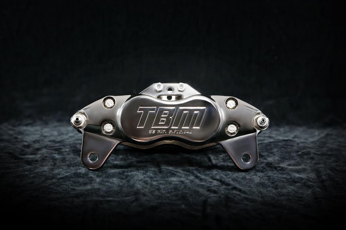

1.WHY DON’T YOU MAKE A 6 PISTON CALIPER?
Contrary to popular belief, the number of pistons has nothing to do with the performance of the caliper. The most often cited reason for companies that do make 6 piston calipers is that they have more clamping force which, for a given caliper size is patently false. Another reason given is to “equalize” the force on the back of the pad to stop taper, which is also false, (more on that later).
The fact is that clamping force relates to two very important factors, caliper rigidity and piston surface area. The real truth about surface area is that in a given amount of space on one side of an opposed piston caliper, 2 pistons will always have more surface area than 3 smaller ones. One further claim by advocates of 6 piston calipers is that “it enhances the proper location of force on the pad”, which is also immaterial to the results of torque output.

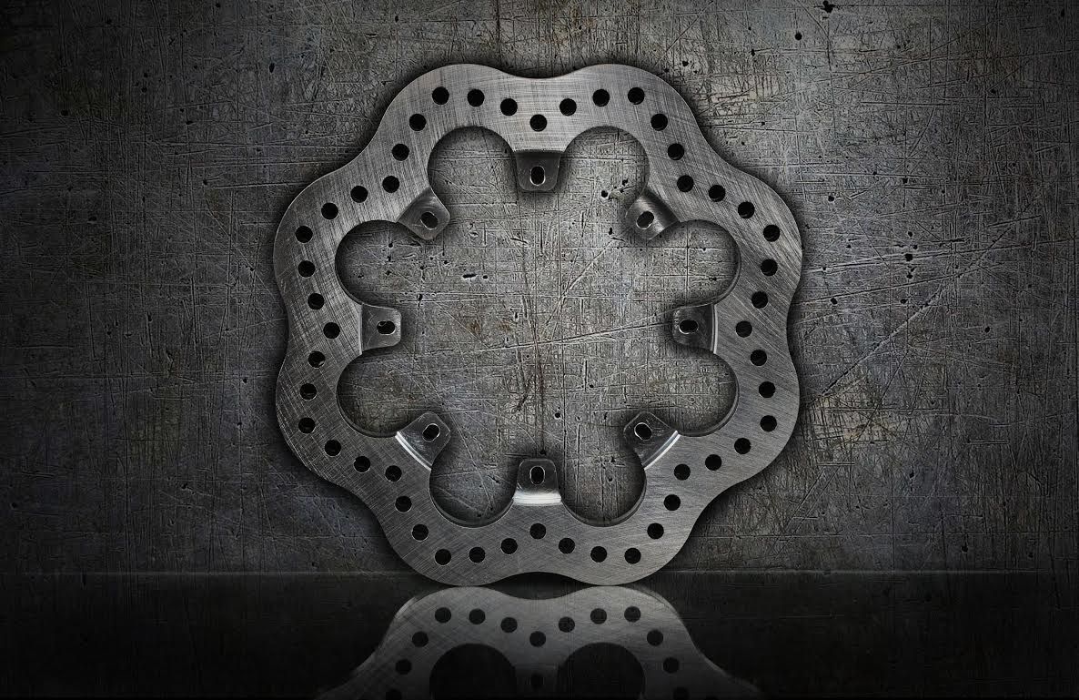

WHAT IS THE PURPOSE OF THE “REVOLUTION ROTOR”?
Rotor choice is based upon two important factors in calculating requirements for a given application. First, the diameter of the rotor determines the “effective radius”, which is an important dimension in calculating brake torque output. There are several choices when determining the component requirements for any application, such as piston size and quantity, line pressure, effective radius, size of wheel and tire, etc.
The math to reach a certain torque level can be achieved with a variety of combinations, but before we look at that, let’s look at the other important determination, that is heat dissipation. Heat dissipation is a factor of the number of stops and the frequency. For example, a drag car only makes one stop, whereas, for example, a formula car makes more stops, more frequently, for a longer period of time. Therefore, the rotor becomes a major factor to keep the temperature within the limitation of the brake pad maximum operating temperature. Unless you have super high requirements for heat dissipation, then large diameter, heavy vented rotors are not your best choice. SMALLER DIAMETER ROTORS ARE ALWAYS PREFERABLE AS THEY CONSTITUTE “ROTATING WEIGHT” WHICH IS THE MOST UNDESIRABLE WEIGHT ON A RACE CAR.
The “Revolution Rotors”, because of the proprietary way they are manufactured, have the capability to withstand incredible abuse without cracking, warping or failing. They will withstand far more thermal input without failure than many heavier rotors. Because of the far lighter weight, they offer a major improvement in acceleration and deceleration resulting in major lap time improvements. They are low cost, high value components, that when combined with an efficient “Zero Drag” caliper, such as ours, will improve your performance for far less expense than adding horsepower.
