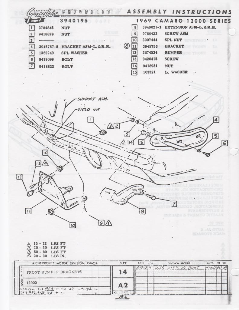

I am working on installing the front bumper. My car had some homemade outer bumper brackets. Just a flat piece with two holes that bolted to valance then one hole threaded with a fender bolt running through the bumper into this bracket. So I have new outer brackets and the bushings, Just seems that the bushing size is around 1/2 inch or so and the bolt would have a lot of room, Would anybody have a picture of the corner bracket and bushing? Does the end bracket just use a standard bumper bolt and a couple of flat washers to hold it tight?

Travis,
I can provide actual pictures of the brackets if you like, but I wonder if these diagrams from the assembly manual will provide the info you need.
The parts are shown in nice detail (and are readily available) on the Rick's Camaro website.
Let me know if you want actual photos.

Thanks Bill, That is how I thought it went together. Just seems the bushing has a oversized hole, maybe for adjustment purposes.
