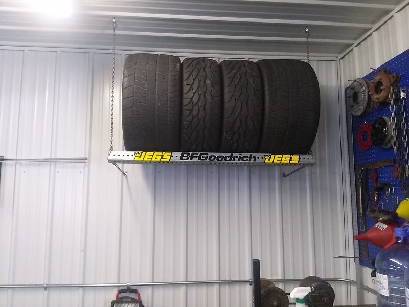

Made a quick , easy, and cheap way to store wheels and tires. The main bar is a 4ft piece of sign post, the rest is eye hooks and chain.It also gets out of your way when not in use. Stickers optional.

That's cool... :idea: gonna try that one.!

First you have to steal a sign post:sarcasm_smiley:
