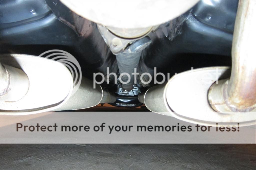

Vince@Meanstreets 12-30-2014 04:07 PM
is the tailshaft centered in the tunnel?
WSSix 12-30-2014 05:27 PM
Dunno. I can find out. UGA's at halftime. I better make it quick. BRB.
WSSix 12-30-2014 05:49 PM
and that's a no.
http://i472.photobucket.com/albums/r...psd00cbf74.jpg
http://i472.photobucket.com/albums/r...ps8fae81d6.jpg
Should it be though? I thought the tunnel was centered with the car and that because of the offset to the passenger side, the tail shaft, drive shaft, and pinion gear/rear end yoke would be offset in the tunnel as well.
WSSix 12-30-2014 06:13 PM
Did a quick measurement of the trans mount location between the frame rails. It's currently offset approximately 1 inch to the passenger side.
