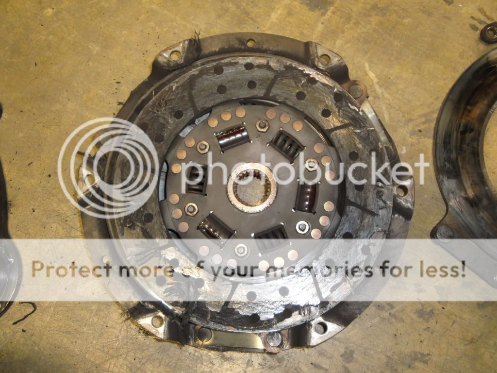

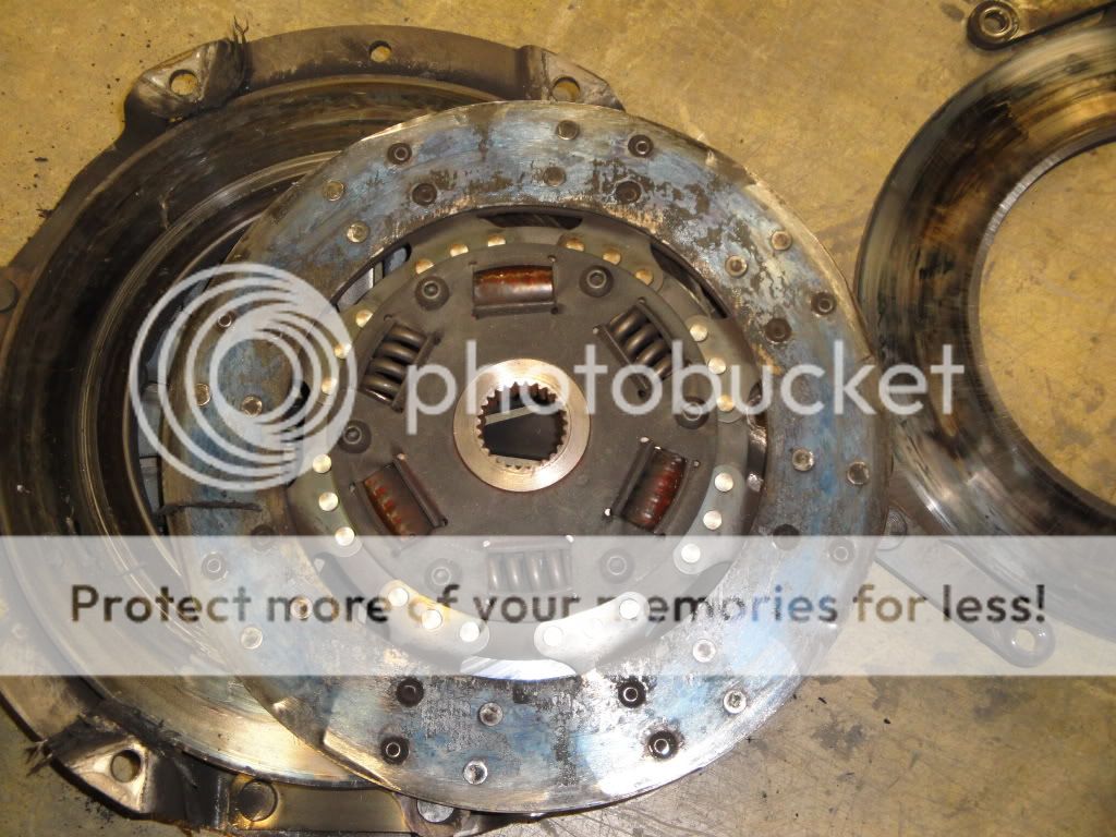

This is what happens to an overheated organic disc, notice in the second pic the friction material is totally m.i.a.
http://i1009.photobucket.com/albums/...debrtth008.jpg
http://i1009.photobucket.com/albums/...debrtth010.jpg
