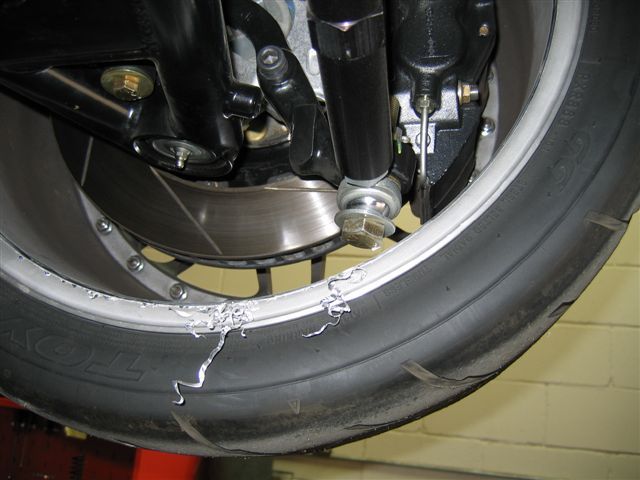

Here is a pic of Mr. Pozzi's experience pushing your AFX spindle/hub... If I recall David had approx.. 3/8" static clearance and upon hard cornering this was the result.....
[IMG]http://i35.photobucket.com/albums/d1...psa7fca352.jpg[/IMG]
And then there was the ONE time/event that David/Mary ran the GMR hub that they took first place in Del Mar on the Auto-X. I don't recall any shavings :popcorn2:
I would like to also ad (and hopefully David will verify), that he really spent no time working with myself to resolve the minimal "play" he was experiencing. (actually, if I searched hard enough I am sure I could find the email from him stating that....) Also, was about the time Art Morrison caught wind that David was trying out a NEW CPP Upright along with GMR Hub and decided to offer up a complete new front clip and was THE reason the CPP Upright and GMR Hub came off with no more testing...
So there you go Blake :headspin:
