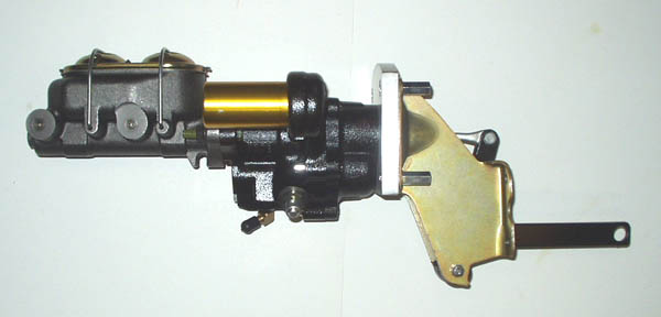

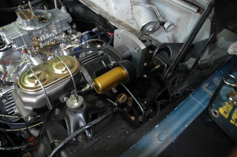

Looking at the torinocobra.com forum, I see that I have been misunderstood, in that we are not talking about whether a hydroboost can be grafted into this application or not. Grafting a hydroboost unit into a Torino / Fairlane without shock towers is challenging, but can be done. Grafting a hydroboost unit into the factory offset cantilever package in place of the factory vacuum booster is considerably more challenging, as you will find the pedal rod connection to the cantilever package is too short for a hydroboost unit to easily accommodate (as the tail of the hydroboost unit casting itself is 2 7/16" in and of itself)...
Hydratech has "been there / done that" a decade ago and were not satisfied with the results, and therefore chose not to market this particular system. With an overall installed length of almost 20", being incredibly overbearing into the engine compartment, I pulled the plug on this application as not satisfied with the engineering session: http://www.hydratechbraking.com/imag...leversetup.jpg Master cylinder at 8.125" installed length, brake unit at 6 3/4", Ford factory cantilever at 5"~ installed length = monster installed length with unsatisfactory overall layout and real time road test results did not meet my expectations. Way too much of a messy obtrusive package into the engine compartment. It was better than a vacuum booster, but not up to Hydratech "snuff", so we chose not to market it. I just didn't like this at all - heck, it almost reached the front of the valve cover (!) http://www.hydratechbraking.com/images/torino1.jpg It was so obtrusive into the engine compartment that I could not stand looking at it, even though it DID WORK: http://www.hydratechbraking.com/images/torino2.jpg No shock towers per having an aftermarket subframe installed? NO PROBLEM http://www.hydratechbraking.com/images/fairlane1.JPG Do please note that where we are "pulling the rabbit out of the hat" with this new system is in providing a highly engineered package that installs directly into the firewall with the factory shock towers still in place, and not using the factory offset up and over the shock tower cantilever arrangement. There IS a difference - Thank you for choosing Hydratech! :lateral: |
