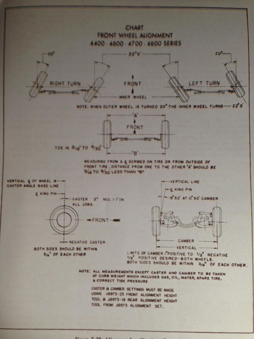

I understand more castor would create more turning camber, but what's intriguing is that there are no castor or camber adjustment shims on either side. I do want to do a castor review though. But again can only go on what alignment shop told me and they said in factory specs, I gave them the sheet below (from the shop manual) when doing so.
