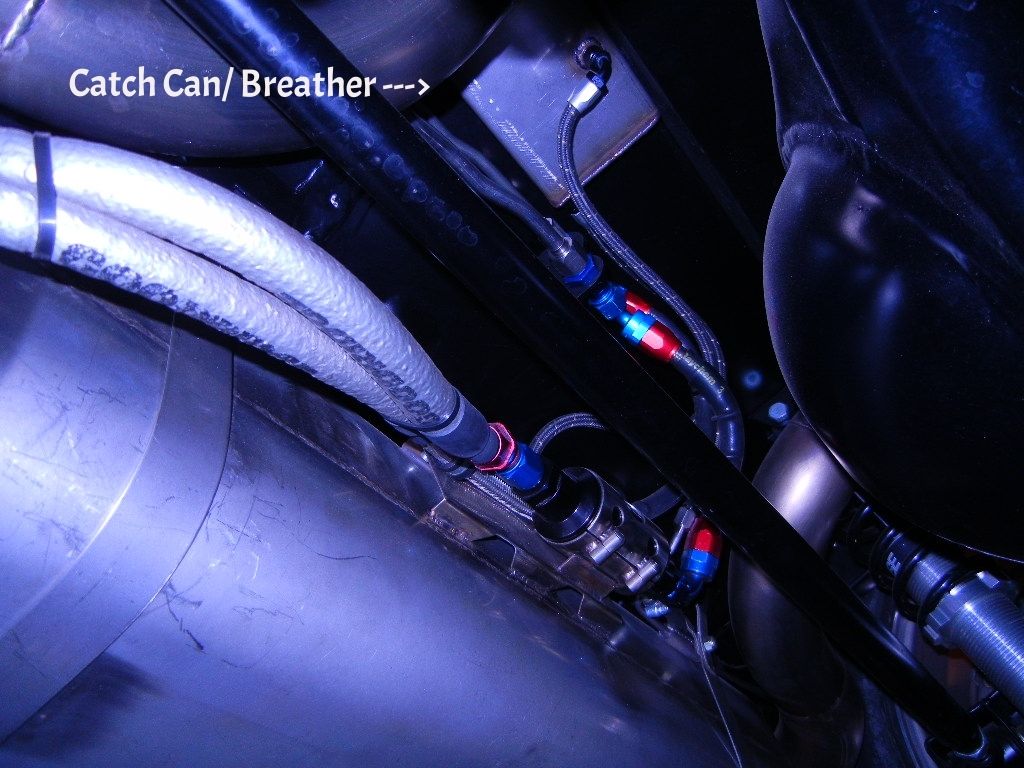

69hugger 01-29-2015 03:58 AM
Originally Posted by cmraman (Post 592138)
look into a II Much fuel vent
There is already such a device, although not as attractive as the II Much piece. The hose you see is coming from the fuel tank. The picture doesn't show the hose coming out of the breather and going to the engine as described above.
http://i1113.photobucket.com/albums/...2bfbbb385b.jpg
It is the upstream part of the system I am puzzled by.
