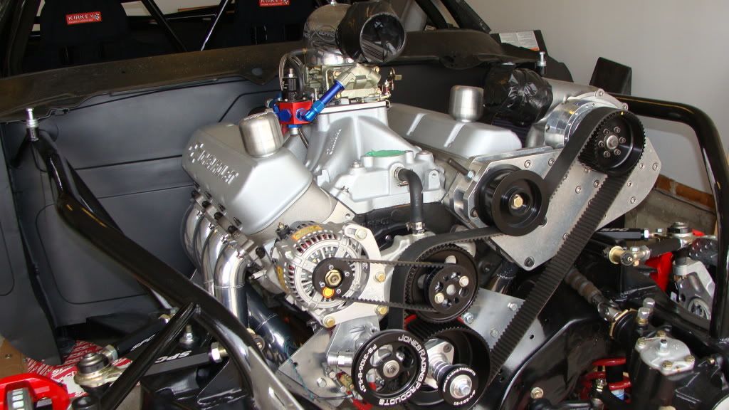

speedjohnston 02-12-2015 06:54 PM
Jones made a custom set of brackets for me. One off the water pump, and one off the crank. Not exactly what you need, but it may give you some ideas.
http://i175.photobucket.com/albums/w...o/DSC02071.jpg
