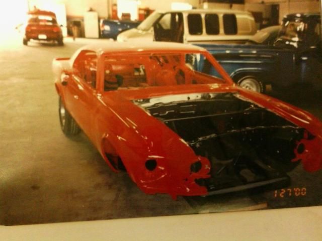

Once again it was painted Porsche India Red, then life got in the way.
http://i782.photobucket.com/albums/y...ps1h2vvxyb.jpg

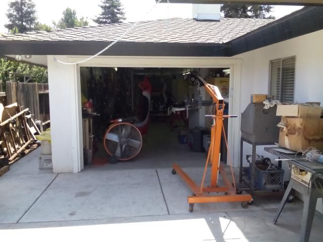

A divorce in 1999 was followed by building an attached 975 sq ft shop to work on the Mustang.
http://i782.photobucket.com/albums/y...ps66202b16.jpg
http://i782.photobucket.com/albums/y...ps0aad23fb.jpg
http://i782.photobucket.com/albums/y...psd98c0e9c.jpg

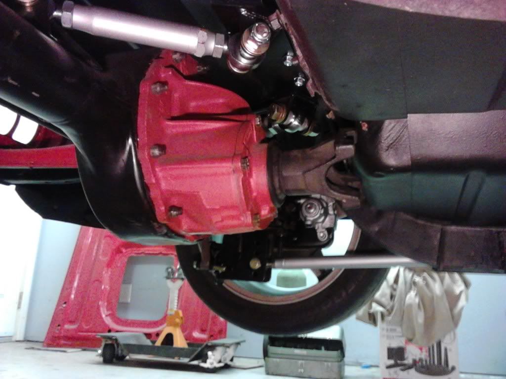

The 9 inch is an N case, Daytona pinion support, 3.50:1 traction lok 31 splines,
http://i782.photobucket.com/albums/y...ps23860128.jpg
http://i782.photobucket.com/albums/y...pse30944d6.jpg

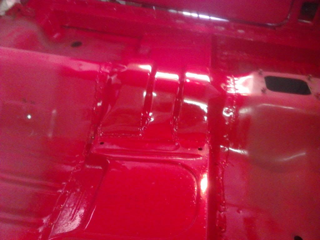

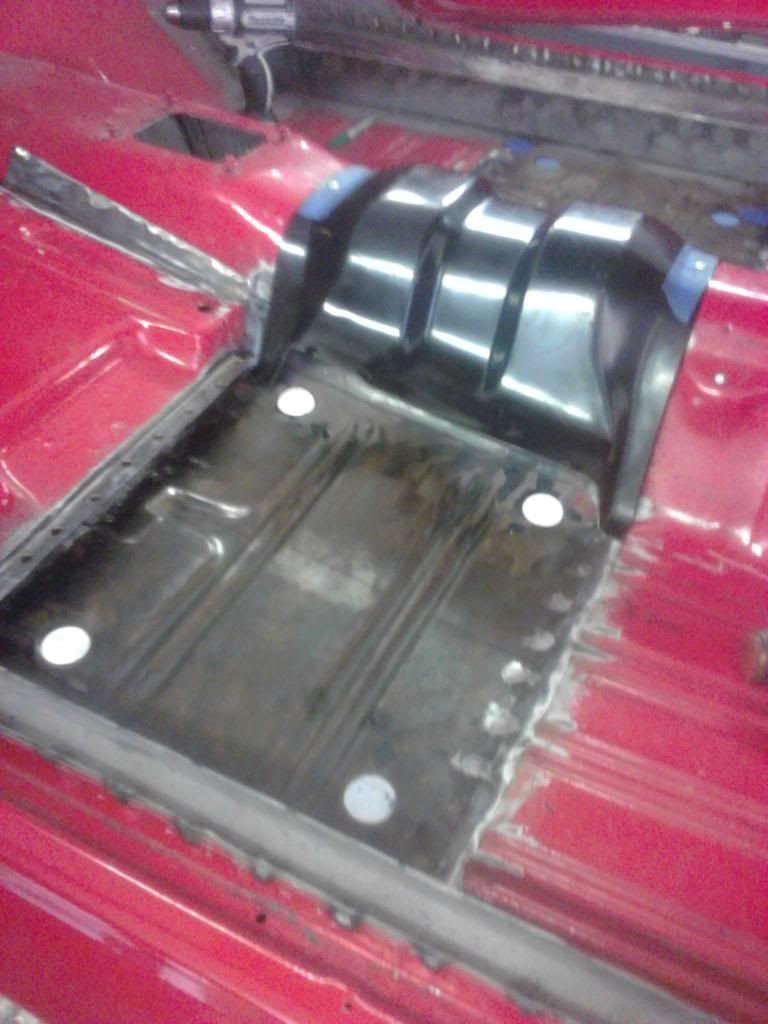

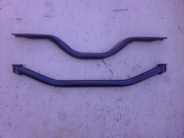

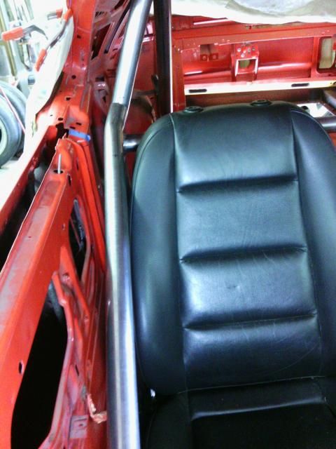

Subframe connectors, convertible inner rockers and one piece convertible seat riser for chassis stiffness,
http://i782.photobucket.com/albums/y...psbfe2acb1.jpg
http://i782.photobucket.com/albums/y...ps47d2558f.jpg
http://i782.photobucket.com/albums/y...ps409c341d.jpg
http://i782.photobucket.com/albums/y...ps3fa6a537.jpg

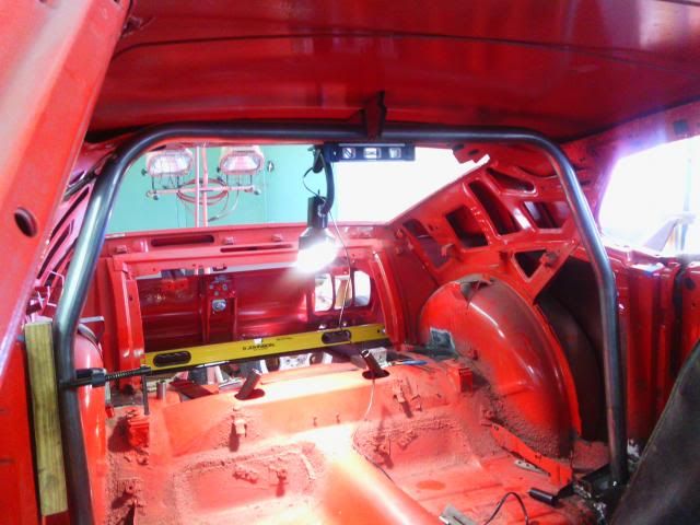

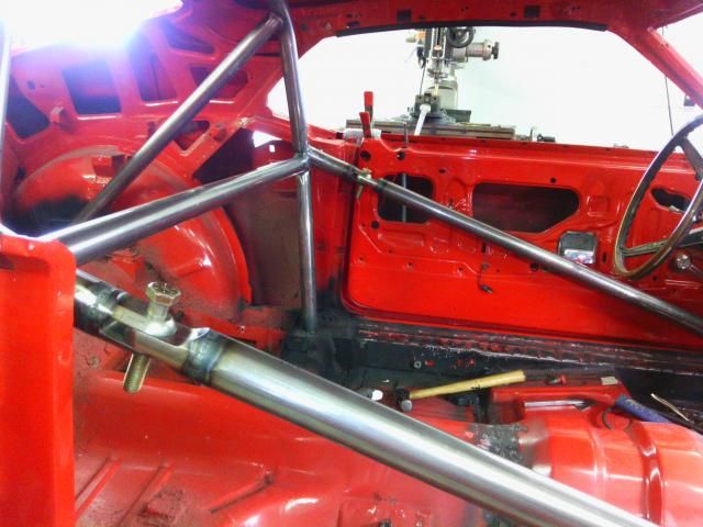

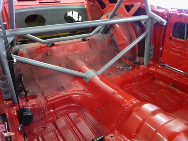

6 point roll bar also for chassis stiffness. I bought the Competition Engineering main hoop and fabbed the rest of the bars,
http://i782.photobucket.com/albums/y...psd2554b9d.jpg
http://i782.photobucket.com/albums/y...ps729ec84b.jpg
http://i782.photobucket.com/albums/y...psa8e0bee2.jpg

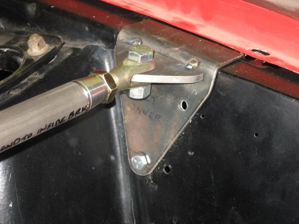

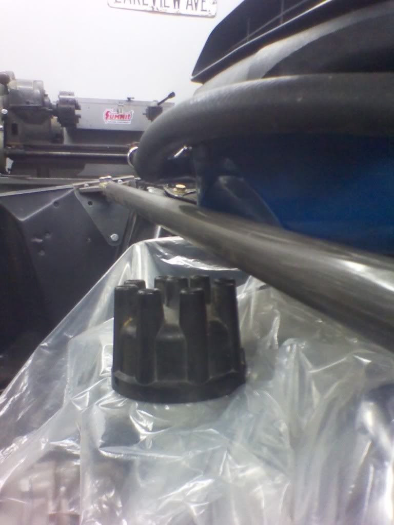

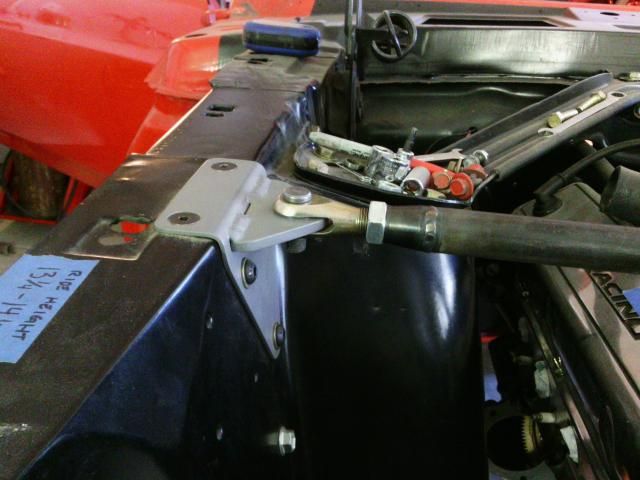

Added a Monte Carlo bar between the shock towers to keep the towers apart,
http://i782.photobucket.com/albums/y...ps29db37b6.jpg
http://i782.photobucket.com/albums/y...psbfb0776a.jpg
http://i782.photobucket.com/albums/y...ps6e3782e9.jpg

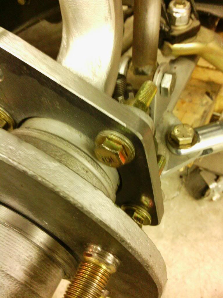

Added 2001 Cobra 13" disc brakes, oem on the left and 13" on the right, built the mounting brackets also. The visual of the size difference is amazing,
http://i782.photobucket.com/albums/y...ps9a695c1a.jpg
http://i782.photobucket.com/albums/y...ps5233ab95.jpg

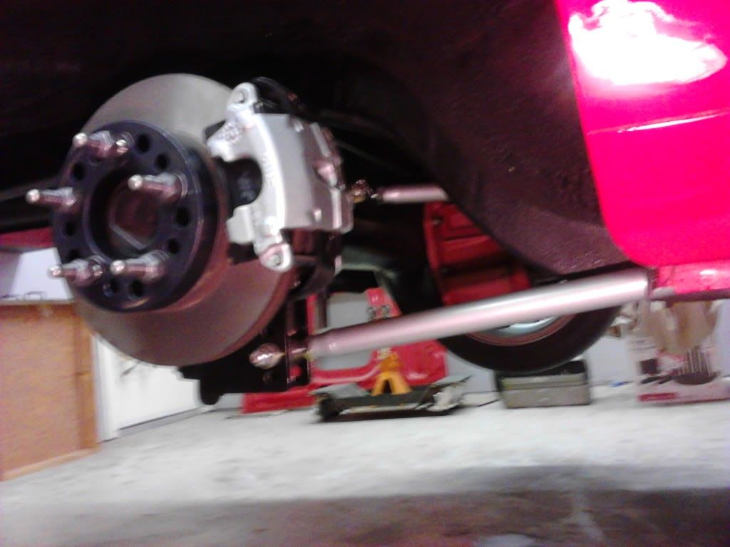

http://i782.photobucket.com/albums/y...psde6a5fc3.jpgRear brakes are 1980 El Dorado, because I had them, and total cost was less than $100,
http://i782.photobucket.com/albums/y...ps306bccd8.jpg
http://i782.photobucket.com/albums/y...psb43d9411.jpg
http://i782.photobucket.com/albums/y...psf91d73b4.jpg

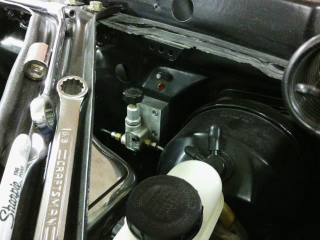

Had Booster Dewey rebuild the master cylinder for $165, exceptional work. I used a Wildwood adjustable proportioning valve for the rear discs.
http://i782.photobucket.com/albums/y...psvr8d3dpq.jpg

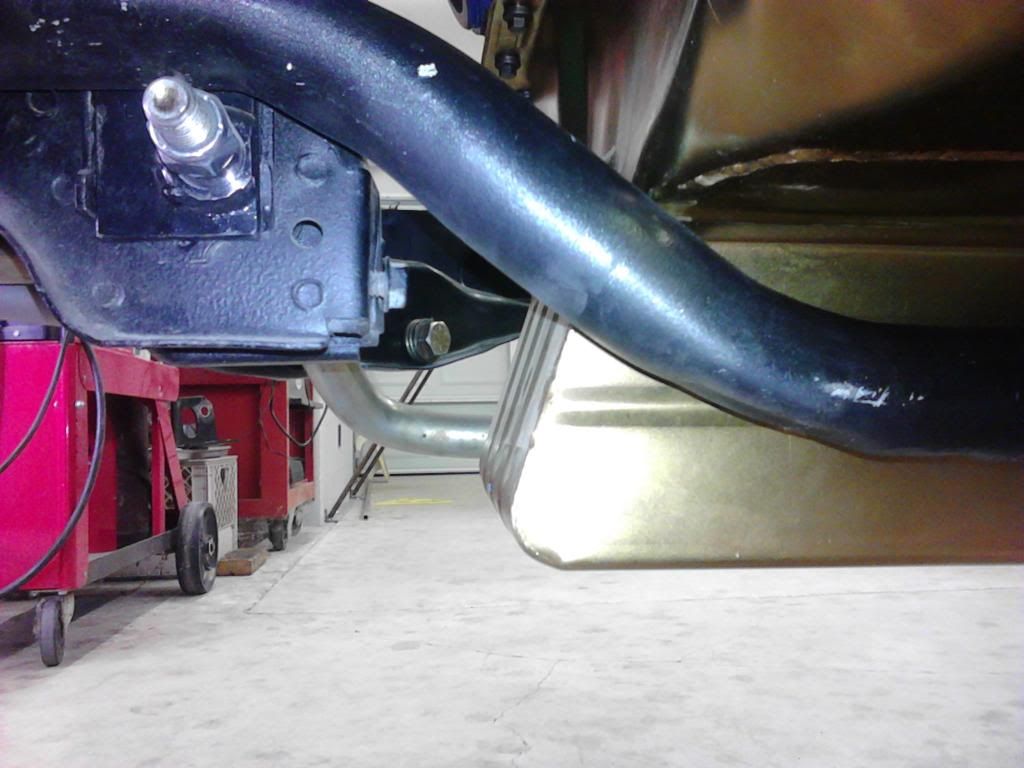

A little planning goes a long way. The oem's poor design has two sharp bends and goes above the lower control arm, causing interference with the oil pan.
http://i782.photobucket.com/albums/y...psc55ed092.jpg
http://i782.photobucket.com/albums/y...psd9db9ebe.jpg
http://i782.photobucket.com/albums/y...ps36b5cc57.jpg
http://i782.photobucket.com/albums/y...ps712d170f.jpg

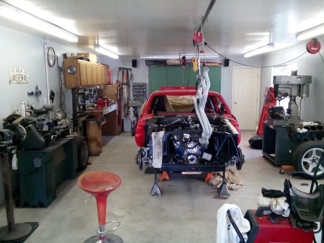

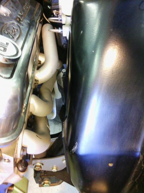

Another crazy move I did was to reroute the header tubes because the drivers side came too close for my comfort to the brake booster and brake line. This Miller is the third tig I've owned and made welding the tubes much easier. The first two tigs were a Linde 305 liquid cooled and a Miller Syncrowave 180 air cooled. My current welder is a Miller Diversion 180 which is fun to use. For my needs it fills the bill completely.
http://i782.photobucket.com/albums/y...ps141de59c.jpg
http://i782.photobucket.com/albums/y...ps75596c8f.jpg
http://i782.photobucket.com/albums/y...ps387d6e9d.jpg
http://i782.photobucket.com/albums/y...ps168246e7.jpg
[EURL=http://s782.photobucket.com/user/robertpmcdougal/media/IMG_20141117_120821_zps055fee4c.jpg.html]http://i782.photobucket.com/albums/y...ps055fee4c.jpg[/URL]
