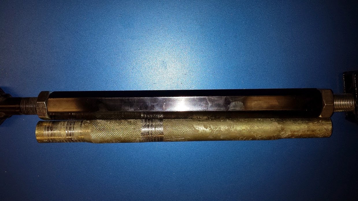

There was only about 3/16" of an inch of thread left at both ends of the strut rod assembly after the last alignment. This is not much adjustment. I decided to buy some 9" sleeves thinking losing a 1/2" of sleeve off each side would not be much and would give extra room for adjustment. Now I'm not sure. This is what is looks like with the 9" sleeve adjusted exactly to the same length as used by the last alignment.
http://2.bp.blogspot.com/-n_Td0TsAZ6...215_162916.jpg
If the same amount of adjustment is needed as last time, the sleeve engages almost exactly 1/2" of the heim thread and opposite side thread. The heim and threaded rod at the other end is 5/8". This also leaves much more thread exposed. I'm not sure if I have enough thread engagement or not. Thoughts?
This is the old sleeve laying next to the new configuration.
http://4.bp.blogspot.com/-rcdajy1NLn...215_163026.jpg

The general rule of thumb for minimum thread engagement is engagement is equal to the thickness of the shank. For example if it's a 3/4" shank rod-end then you need min. 3/4" of thread engagement. MINIMUM. That's in tension or compression only. Ideally, we would like to see an inch or more in my example. The simplest way to put it is you don't want more than a handful of threads exposed.
You don't need a very large adjustment range, you just need enough adjustment to fine tune the alignment. If the alignment is set correctly and there is a lot of thread showing, I would measure the exposed thread and then get a longer tube to make up most of the difference.
