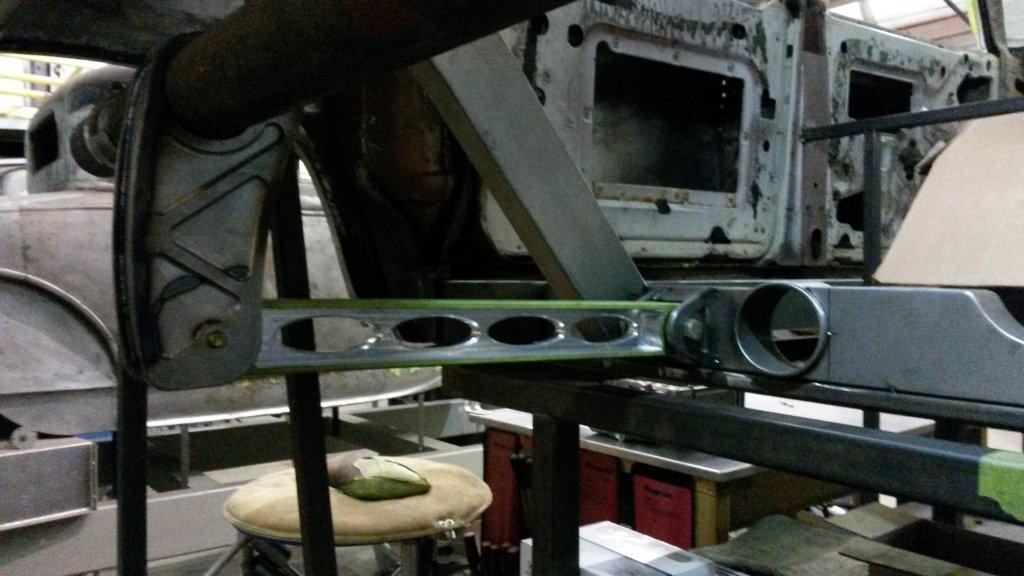

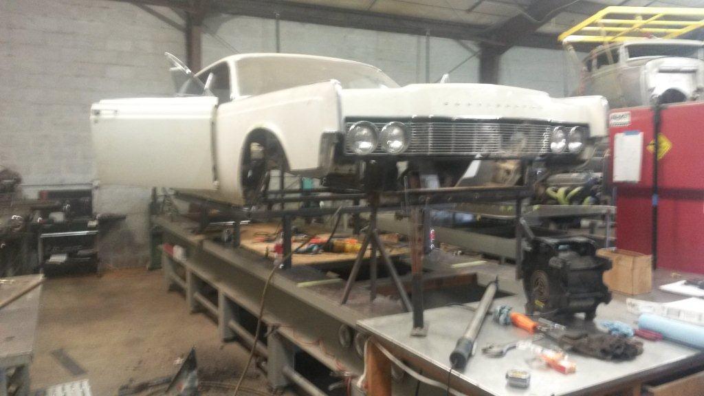

mfain 02-22-2015 07:14 AM
3 Attachment(s)
My son built a chassis for a 4-door Lincoln with late Corvette front suspension and an LS motor. Not a project for the faint of heart - 200 feet of TIG welding in the frame rails!
Pappy
Attachment 52930
Attachment 52931
Attachment 52932
