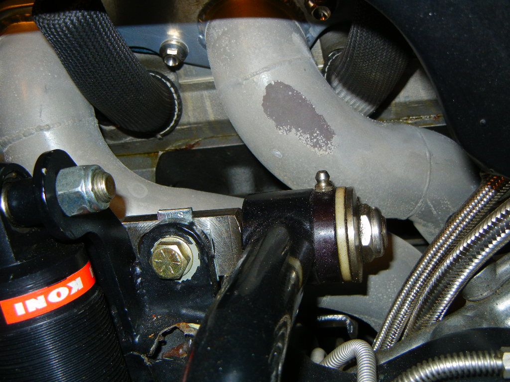

I think it was a case of too many cooks. Not completely sure of the chain of events as I bought the car at auction, but from what I pieced together, the motor did 675 hp with a carb. The 2nd owner had the F.I. added, then several shops tuned it. Somewhere along the line, the cam was changed.
Funny thing, that cam made for such poor dynamic compression, all the power (heat) went out the pipes. The ceramic coating on the headers was completely blistered. Never seen that before. Hell, the urethane on the drivers motor mount had melted out from the header heat. It had dripped all over the frame & p.s. hoses! Never seen that for sure!
