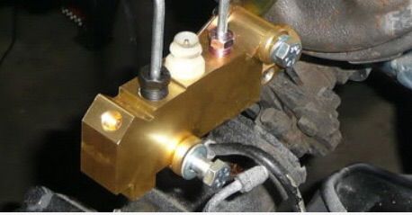

I have new front 6 piston wilwood calipers, new wilwood floating calipers for the rear installed last weekend, and Wilwood master cylinder, which was installed by the previous owner. I recently replaced the old distribution block with a combination valve or proportioning valve similar to the photo attached below
http://s218.photobucket.com/user/72Z...nf9h.jpg.html]http://i218.photobucket.com/albums/c...ps5prnnf9h.jpg[/URL]
I filled the master cylinder with brake fluid and disconnected the flexi lines to the calipers in order to flush the system (Gravity Method) . However, I realized that NO fluid was passing through the combination valve.
So I need your advise on this issue and what should be done to resolve it.

I dont have the one in the photo (what make is it?) but I have some thoughts. I wonder what happens if you disconnect a valve input line? Does fluid begin to gravity feed out the line? If not your master may not retract enough to open the ports to the resevoir. This might be a rod that is too long for your application.
If fluid does come out then it must be something to do with the valve. A true combination valve will hold off the front disc callipers so that pressure can build up in the rear (to get rear drums working before bringing in the front brakes). Maybe this explains the front not bleeding, is the rear not bleeding either?
With the valve lines connected can you step on the pedal to see if the increased pressure gets the fluid moving?

Well the only item I changed is the combination valve. Earlier there was a normal distribution block and fluid was flowing normally via gravity without any obstruction. I am not quite sure if the valve can be adjusted

Does that block have the ability to adjust the amount of fluid pressure to the rear brake line?
If not it's a distribution block.
This is how I plumbed my manual system with a Wilwood combination distribution & proportioning valve mounted below the master cylinder. I also incorporated the OEM delay valve just because. The master cylinder was bench bled following the instructions available on Wilwood's website prior to installation.

It is a valve from Right Stuff Detailing:
http://i218.photobucket.com/albums/c...ps0y6rwsdy.jpg
I disconnected the inlet lines to the valve, and barely little brake fluid passed from the master cylinder ports. I also installed new rear brake line. My guess is the system is full of air as well as the master cylinder itself through which the fluid is not passing to the valve.
