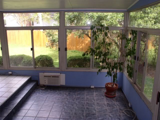

Here are two views out of the sunroom when I bought the house. To the left is where the man cave will eventually be located.
http://i213.photobucket.com/albums/c...alP1010066.jpghttp://i213.photobucket.com/albums/c...eofsunroom.jpg

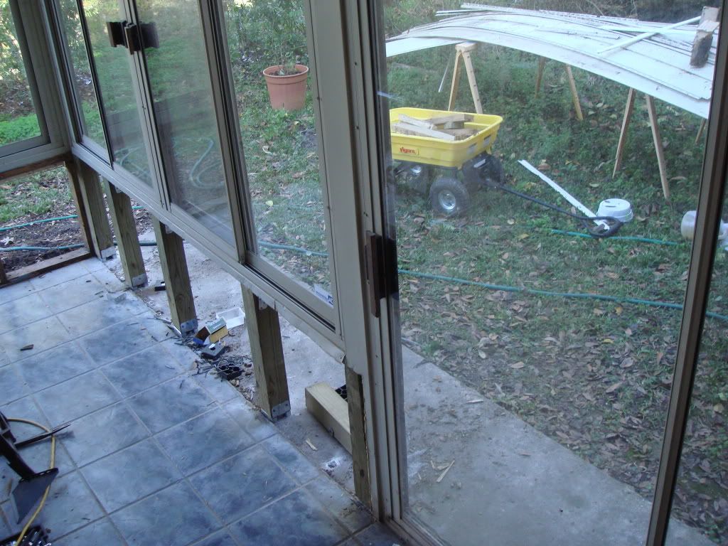

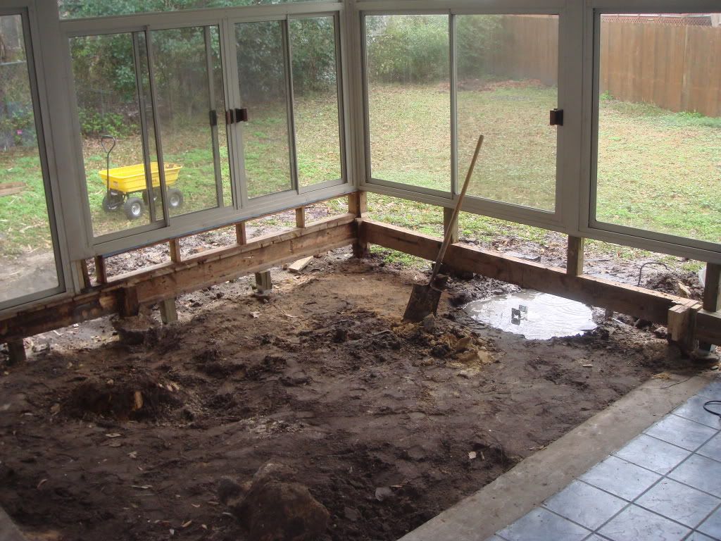

To fix it I decided to go ahead and gut the interior of it. Just before I moved in, the previous owner had to remove a tree that the sunroom was built around. It went through a wooden deck, which was later tiled over with the beige tile in the pics. You can see part of the stump that I dug up in the second photo.
http://i213.photobucket.com/albums/c...m/DSC00077.jpg
http://i213.photobucket.com/albums/c...rdprojects.jpg
Dug lots of hole and set pilings in the dirt area and used the previous patio to support 4x4 posts to replace the 2x4 non-treated stuff that was there before. Not high dollar construction I realize but I was just trying to fix what was there with my self taught skills at the time.
http://i213.photobucket.com/albums/c...m/DSC00159.jpg
http://i213.photobucket.com/albums/c...ofDSC00148.jpg
http://i213.photobucket.com/albums/c...m/DSC00570.jpg

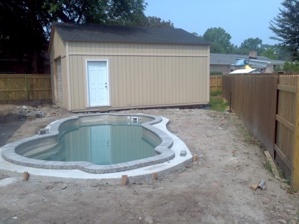

So on to the man cave / shed. I didn't have a lot of land to work with so I had to go with the non-permit required less than 500 sq. ft. shed. I ordered up a 20x24 box built on skids. I made a few changes to their normal build. First I required the skids to be set on block set in 2 ft. increments instead of 3 ft. or 4 ft. as they normally built and I required them to set the 2x12 joists 1 foot on center to give the floor lots of support. I called up Direct Lift and got the exact measurements for their 4 post lift and then proceeded to put 4 joists together in the two sections where the lift feet would land. Then I went with 2 layers of 3/4" subflooring.
So here is a picture of that when it was first set up...
http://i213.photobucket.com/albums/c...ontofshed2.jpg

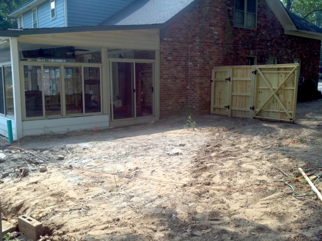

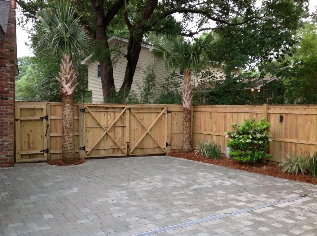

Put in a fence while I was at it after cutting down the bushes between my back yard and my neighbor’s front yard.
http://i213.photobucket.com/albums/c...529_184811.jpg
While I was at it, I thought… You know, I need some fill dirt to be able to bring up the ground level in front of the shed. So I’ll just dig a big hole in my back yard and move the dirt! My backyard was long and narrow so he had to get pretty close to the house…
http://i213.photobucket.com/albums/c...601_083924.jpg
http://i213.photobucket.com/albums/c...601_085840.jpg
http://i213.photobucket.com/albums/c...1_085211-1.jpg
Here is the fill moved over…
http://i213.photobucket.com/albums/c...623_110323.jpg

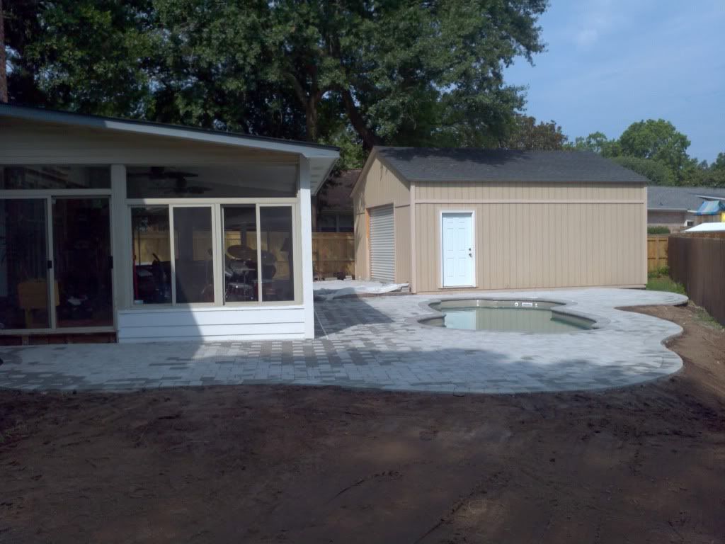

After I put the fill in front of the shed, I thought… “I need to fill in that big hole in the back yard now… so I did.
http://i213.photobucket.com/albums/c...wardsshed5.jpg
http://i213.photobucket.com/albums/c...629_101416.jpg
http://i213.photobucket.com/albums/c...g/IMAG0065.jpg
http://i213.photobucket.com/albums/c...g/IMG_0129.jpg

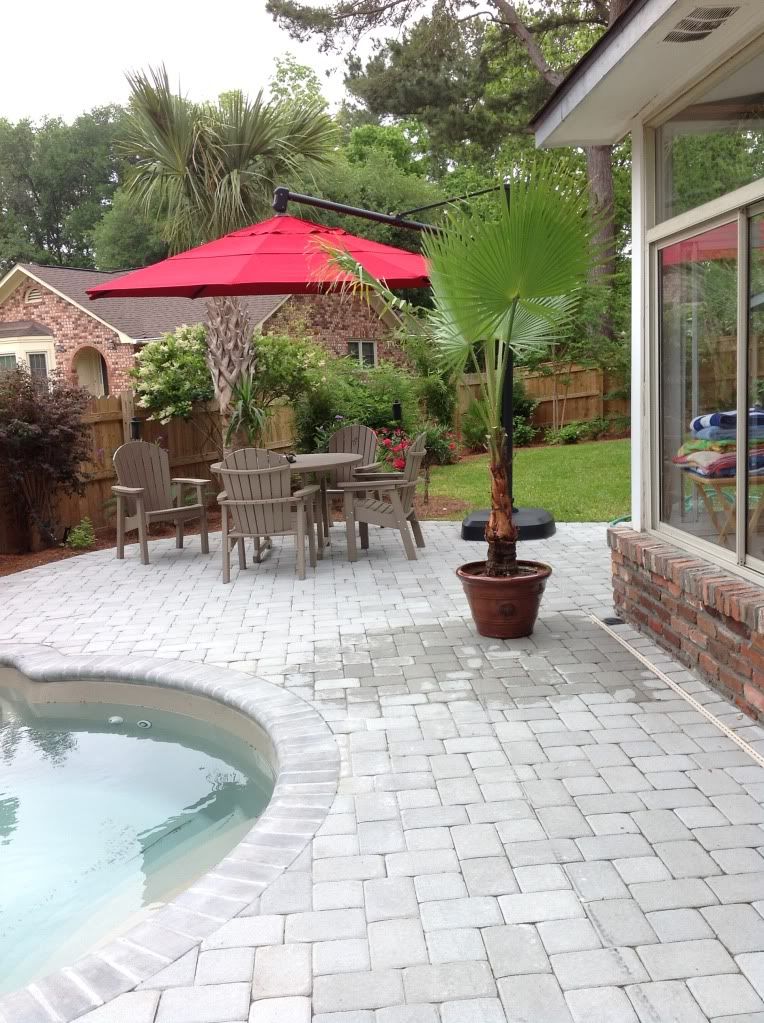

A little landscaping…
http://i213.photobucket.com/albums/c...ps4645ad67.jpg
http://i213.photobucket.com/albums/c...ps01de225f.jpg
http://i213.photobucket.com/albums/c...g/IMG_0141.jpg
/HOUSE/House%20-%20Pool%20and%20Landscaping/413_zps23319baf.jpg[/IMG]
http://i213.photobucket.com/albums/c...psoxtpyzsr.jpg
http://i213.photobucket.com/albums/c...ps82c63805.jpg
http://i213.photobucket.com/albums/c...pse0cvo1vb.jpg

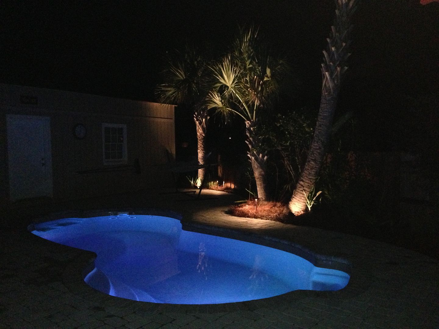

Added a couple of fountains to the pool
http://i213.photobucket.com/albums/c...ps292d6087.jpg

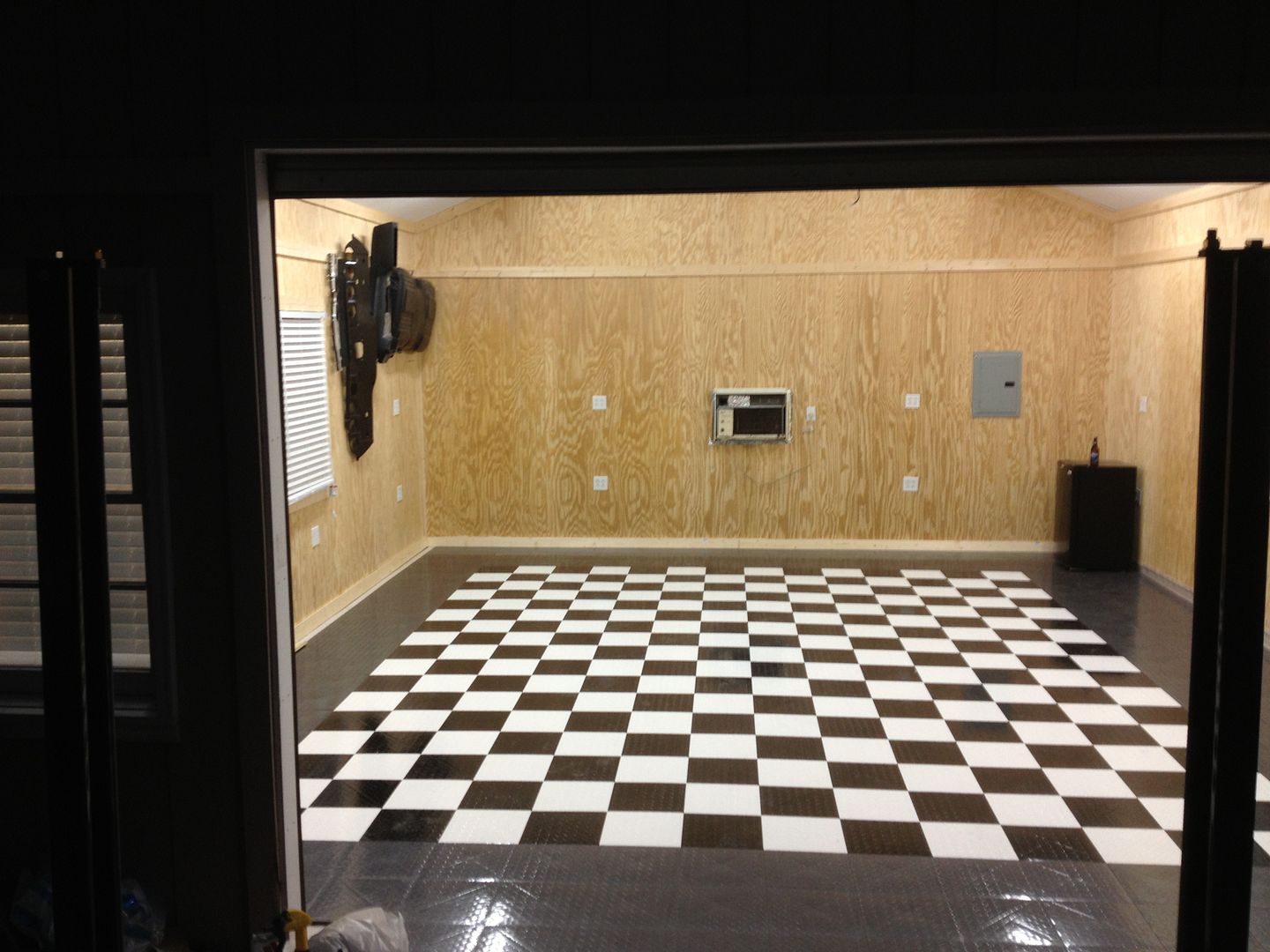

Decided to go ahead and insulate and put interior walls inside of the shed….
http://i213.photobucket.com/albums/c...e/IMAG0280.jpg
And floor it…
http://i213.photobucket.com/albums/c...ck12-7-128.jpg

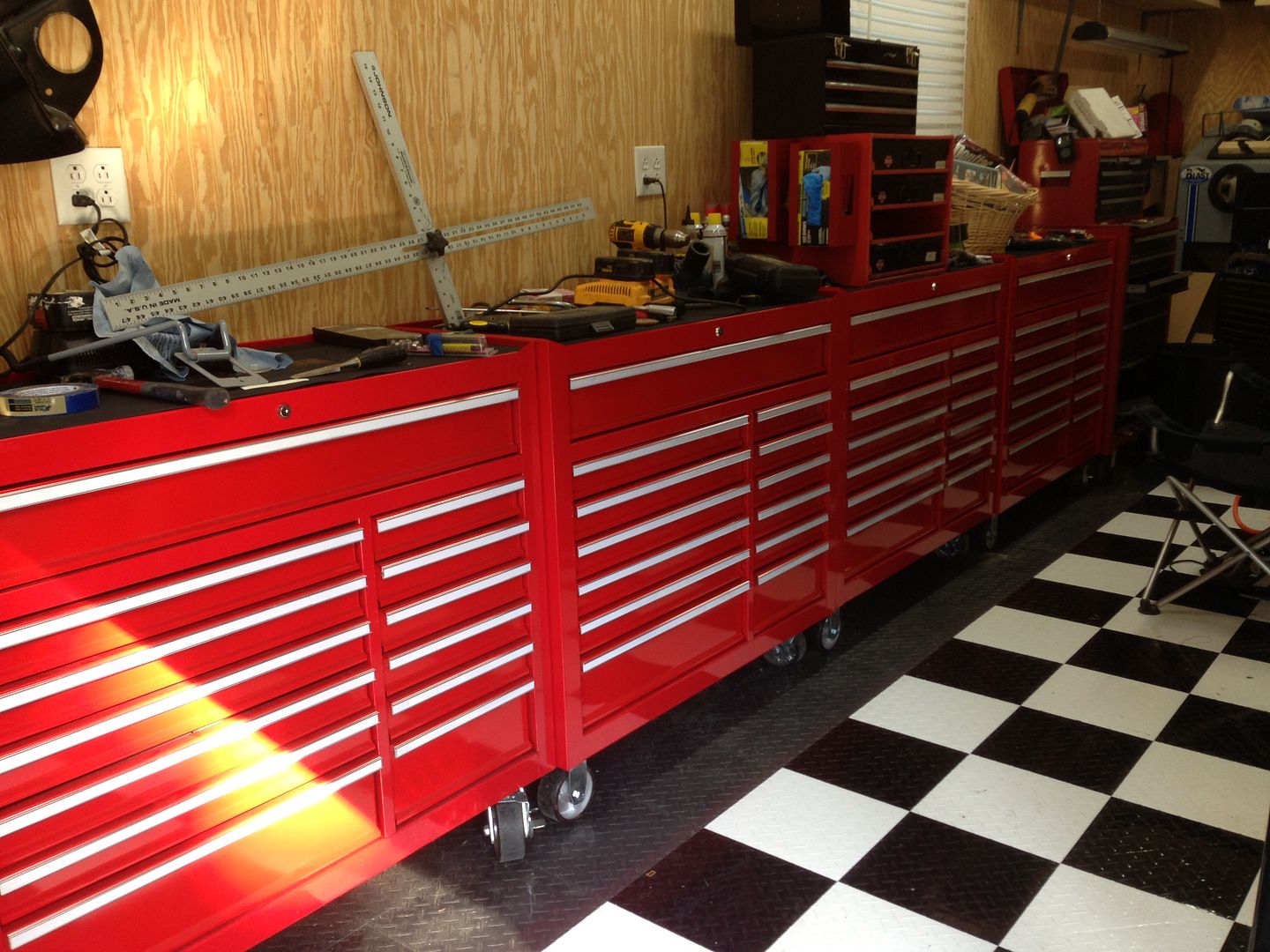

Added a few tool boxes a couch and a flat screen. I'll have to get some better pics of the interior.
http://i213.photobucket.com/albums/c...ps4276fc6d.jpg
http://i213.photobucket.com/albums/c...ps83qryo34.jpg

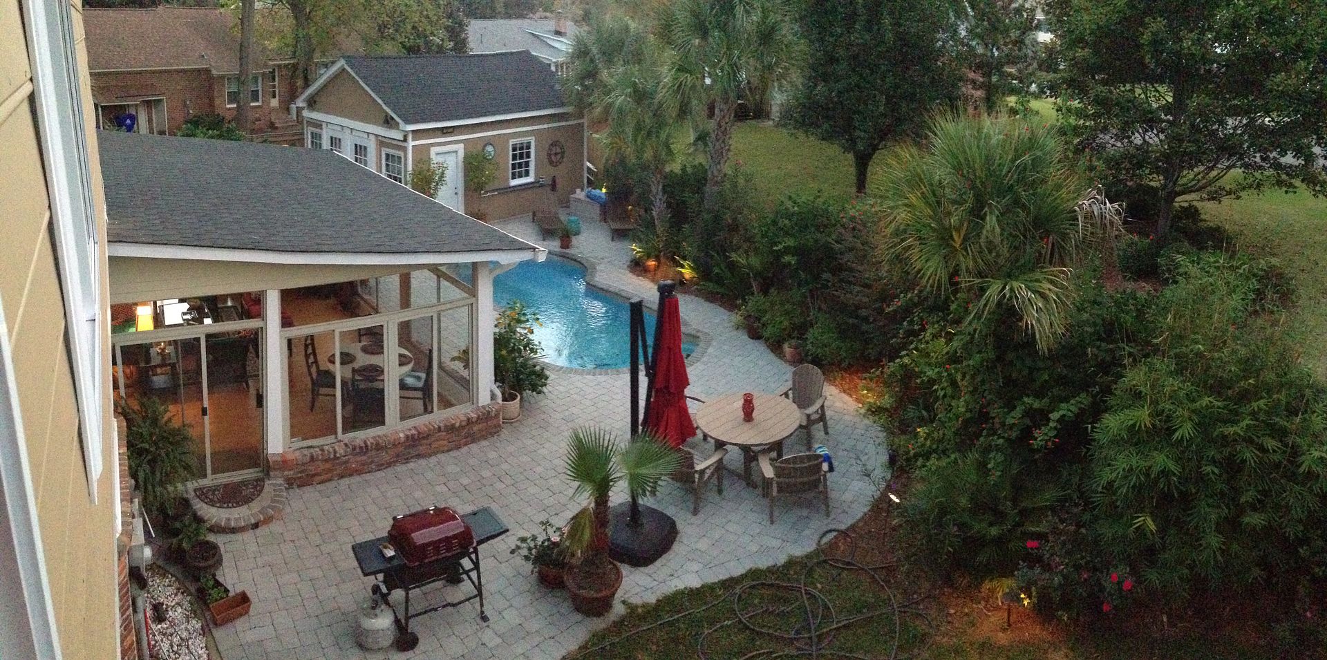

The end result..
http://i213.photobucket.com/albums/c...g/IMG_0143.jpg
http://i213.photobucket.com/albums/c...G_0139JPG2.jpg
http://i213.photobucket.com/albums/c...ps4042ae06.jpg
http://i213.photobucket.com/albums/c...ps114fb591.jpg
http://i213.photobucket.com/albums/c...psd0efddde.jpg
