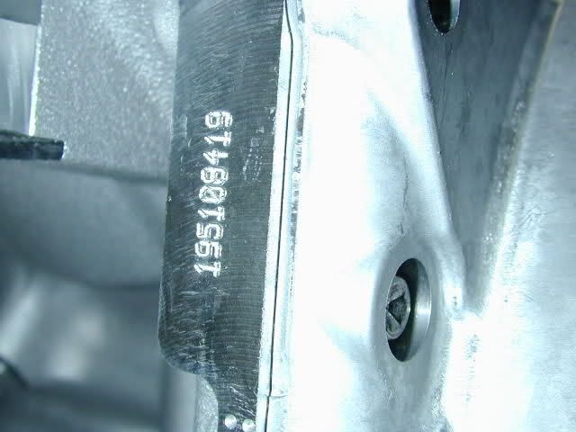

There's a vin derivative laser etched on the drivers side of the engine block near the oil filter. It's on the flat/machined surface where the bellhousing mates to the block.
67Rally 03-21-2015 01:02 PM
After searching google for a good pic of the location I described above (LS1 & LS6):

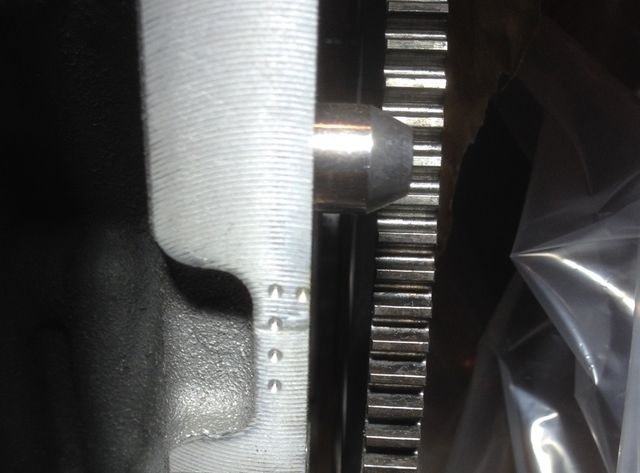

waynieZ 03-21-2015 06:29 PM
Thanks, I tried to find out on google and found nothing.
I just got back in from the garage, my LSA crate motor has no numbers in either place.
Here's a picture of the back
http://i172.photobucket.com/albums/w...psptcn664t.jpg
The front had nothing at all on either side.
Che70velle 03-21-2015 07:42 PM
1 Attachment(s)
My LS2 block that I recently had sleeved has a vin number on the bottom of a flat pad at the front of the engine on the left, or drivers side of the block. You can see it at the top of the picture, on the bottom of that locator pad. Would be virtually impossible to find with accessories in place.
waynieZ 03-21-2015 08:17 PM
I just went out to check on mine and that's one place I can't get to while its bolted to the pallet.
waynieZ 05-09-2015 04:42 PM
I just went in the garage and checked my motor today and there is a number stamped where Scott has one on his block.
